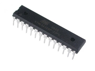

For my design, I opted for the AtMega328P micro.

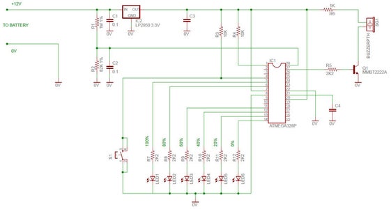

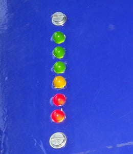

Step 1: LED Display
The LED display was designed to be simple and easy to interpret. There are 6 LEDs, indicating the voltage level in a LED BAR method:
Led 6 - 100%
Led 5 - 80%
Led 4 - 60%
Led 3 - 40%
Led 2 - 20%
Led 1 - 0%
The 0% Led is to be linked to the programmed minimum voltage level
The 100% Led is to be linked to the programmed maximum voltage level.
The scaling between 0% and 100% is linear. For 0%, only Led 1 will be on, and for 100%, all Leds will be on.
For power saving, the LED display does not stay on. To turn on the display, a button needs to be pressed, and the display will turn off after 30 seconds.
Step 2: Voltage and Alarm Levels
To be able to measure the voltage, the battery voltage needs to be down scaled. Using a resistor divider, the voltage is scaled down to 1.1V with a 1M and 82K resistor. With the A/D converter set to the internal 1.1V reference, this means that the maximum measureable voltage will be around 14.45V, high enough for the design.
There are 5 voltage levels that needs to be monitored:
- maximum voltage level
- minimum voltage level
- alarm 1 voltage level
- alarm 2 voltage level
- alarm 3 voltage level
Instead of using trimpots, I decided to go for a more unconventional way. Via a programming procedure, apply the specific voltage levels in turn, and save the various A/D results in EEPROM.
The LEDs are used to indicate the programming sequence, and the same button used for the display, is used for programming.
Step 3: Audible Alarm
A normal piezo buzzer is used for the alarm. as this should be load enough. Provision for three alarms were made, with the following properties:
- Alarm 1, to beep once every few seconds. Should be able to silence this alarm
- Alarm 2, to beep twice every few seconds. Should be able to silence this alarm
- Alarm 3, to beep three times every few seconds. This alarm can not be silenced.
Once an alarm is silenced, I needed an automatic reset function to enable the alarms again if the battery has been charged. I included a reset function that will enable all alarms again if the battery voltage exceeds 60% again.
To silence the alarms, the same button used for the display is used.
I tested these alarm sounds in my house, without any complaints from my wife and son, so I am sure it will not be irritating in the outdoors world.

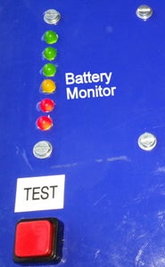

Step 4: Minimum Buttons
All functions are done using a single button.
Display
To turn on the display, press the button. The LED dislpay will come on, and turn off automatically after 30 seconds.
Alarms
Alarm 1 and Alarm 2 are silenced by pressing the buttom.

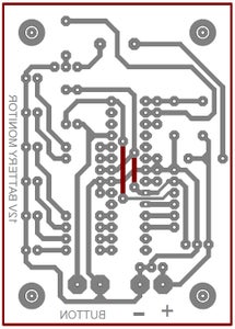

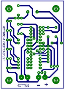

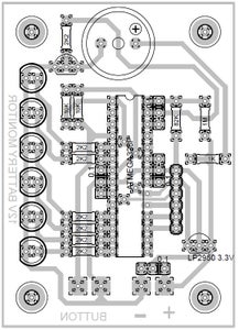

Step 6: Building the Circuit

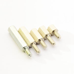

I used the free version of Eagle to design the PCB. All components, except the push button, are mounted onto the PCB. Assembly is easy, with the exception of soldering the LEDs. Ensure all LEDs are the same height. I used 20mm spacer to mount the unit, and used this as reference for the LED height.
Because my design uses a 3.3V regulator, some standard 5V piezo buzzers does not work. The buzzer in the design is connected across 12V, and switched with a transistor. Play around with the value of R6 to get a decent sound out of the buzzer, without destroying it. Apart from this, there is no other tricks in building the circuit.

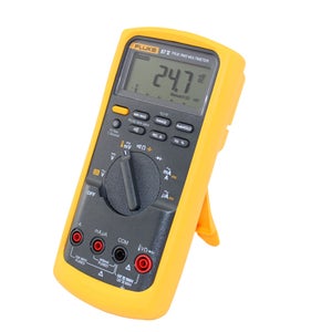

You will need a variable power supply and a multi meter to calibrate the unit.
