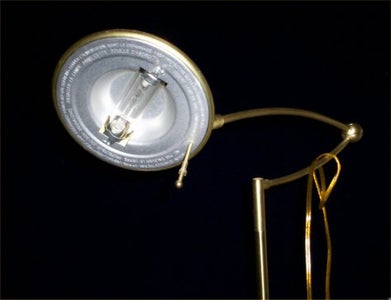

OK, first start watching on trash days for something interesting. Doesn't have to be a floor lamp, the basic instructions here will work just as well with a desk lamp or even a metal mint case (if you want a really small light).

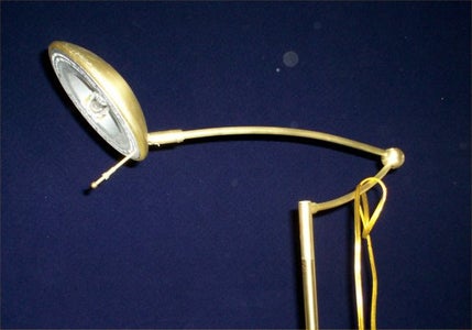

On our last trash day Here I found a nice brass floor lamp with a movable arm so I could use it over my desk with out taking up desk space, that is needed for all my other clutter. Or I could use it behind my chair as I read a nice relaxing book.
But that halogen 100 watt bulb has to go. I've heard them called a dorm torch. If this falls over when it's on, it can easily set loose paper or carpeting on fire.

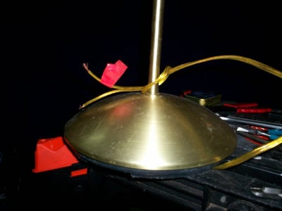

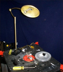

Step 2: Gutting the Lamp
Grab any tools you will need, a screwdriver or two (philips, slotted, or OJ with Vodka), adjustable wrench, coffee, soldering iron, hammer, drill, grinder, files... well you get the point. Take everything apart carefully at this stage, you might want to keep some parts like I did here, to put the lamp back together. The aluminum reflector I'm going to use again to mount the LED insert on to.

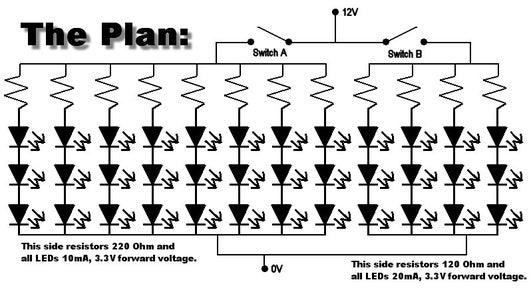

I'm using 12V for my power source, it's easy to find world wide, and as such it's easy to find things to customize to it.
I'm using 3 LEDs in series for each segment, saves on resistors. And a quick word on these resistors, if you don't use them, you will burn out the LEDs.
There are two switches in this project, you may only want to use one, but I'm gonna use two different LEDs, narrow beam high intensity LEDs in the center for a spot light effect, and a ring of lower intensity LEDs for a soft glow.
The soft glowing LEDs only use 10mA of current, while the narrow beam are brighter and draw 20mA. So I had to figure out the needed balancing resistors. I found on line, and so could you by looking for "LED Serial Calculator", a calc that would tell me what resistor to use for three LEDs in series.
To make it simple, if you are using similar LEDs, here are the required values:
120 Ohm for 3 X 20mA LEDs that have a forward voltage of 3.3V
220 Ohm for 3 X 10mA LEDs that have a forward voltage of 3.3V

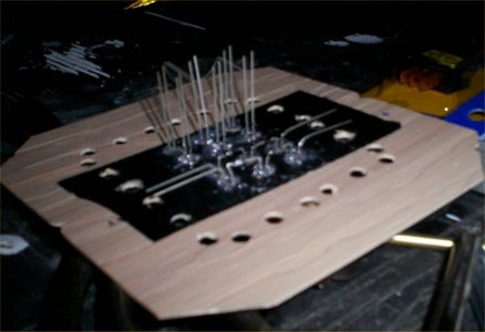

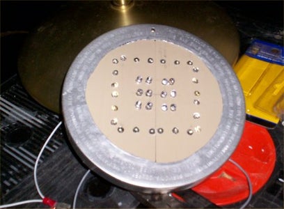

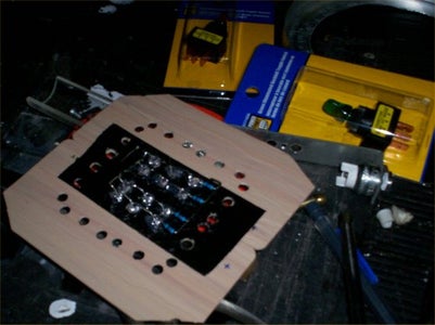

As you can see in the pictures, I drew a couple boxes on the vinyl for where I want to put the LEDs, and I cut the scrap reflector part of the aluminum insert. You don't have to use square boxes, you could make a star pattern, circles, spirals, or even random positioning. But try to remember the more complex you make your pattern, the more difficult it will be to wire up the right LEDs in the right polarity.
I drilled holes for all 36 LEDs, an inside square of 4 segments of 3 LEDs that will be the narrow bright beam. Around the outside square I have 24 LEDs, six per side, or two segments of 3 LEDs per side.
To drill the holes I should have used a 5mm drill bit, but I don't have a metric drill set, so I used a 7/32" bit which is very close. Just a touch loose, so I glue gunned the LEDs into the holes.

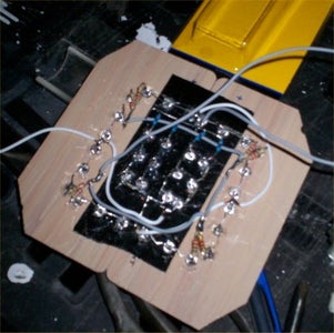

Starting from the center I positioned the LEDs so that all the positive leads are facing the same way. I also soldered the required resistor on the positive side of each LED segment. Once the 4 segments were done on the inside, I soldered the ends together so I had just one point to put wires for both positive and negative wires.
On the outside square of LEDs I wanted to make it easier to identify the wires, so I made each corner positive, and the middle of each side the ground points.

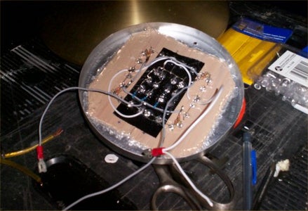

Once all the wires are connected, you should only have three wires to connect to the lamp. Unless you are using one switch, then you only need 2 wires. My lamp will have two switches, so I need two positive leads but only one ground. As following The Plan, all segments come together for a single ground lead.

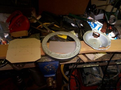

As you can see from the pictures, I cut out the reflector part of the aluminum ring. This has to be done carefully as this was a very soft aluminum, but I went over it with a file till smooth, then hammered it gently flat again.
The vinyl with all the LEDs and wires can now be glue gunned into place, going over the whole outside edge for strength.
You might be wondering about glue gunning everything to a light source. Don't worry, these LEDs don't generate the kind of heat that the original halogen bulb did. Or for that matter, they won't generate enough heat to melt the hot melt glue.

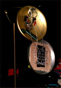

Now that we have the lamp head made with all the wires needed, we can add it to the lamp body itself.
Here I have to apologize I didn't take any pictures of mounting the switches to the lamp body. I'll leave it to your imagination to drill / file / or however you want to make, or enlarge, the holes in the lamp. Just don't use C4 to enlarge the holes, it will leave the edges too ragged.
Here I'm using a special three connector switch that is supposed to light up the duck billed plastic switch on the outside when the switch is turned on. As such there is a third connector for ground. On a normal switch you don't connect ground to the switch.
If you are using a normal switch then just follow the plan in step three for wiring.

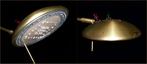

During this construction I have been soldering as I went along, and only managed to burn myself twice. In using a regular soldering iron I picked it up by mistake as you would a pen or pencil. And in this step you can see a lighter, it's actually a micro butane torch that I do soldering on wires away from the normal soldering iron. Well that and I use it when I have to solder a large area that the small iron takes forever to heat up. It takes a number of seconds for a large area of metal to cool down once heated to the point of melting solder. I forgot and went to move the wire out of the way so I could do the next.
Also in the line of safety, once all the wiring is done, I put the aluminum ring back onto the lamp body. But before I did that, I taped off any protruding metal wire ends that could ground out against the LEDs. I mean the wires that go to the switch in this case, I wasn't sure if the switches would have enough clearance not to be pressing against the backs of the LEDs.

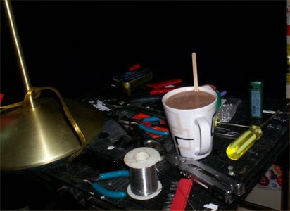

Step 6: Midnight...
It's midnight so I'm taking a hot chocolate break...

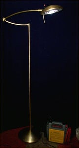

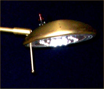

Once the plug has been soldered on, and shrink wrapped for protection, I'm done except for micro adjustments, and taking pictures.

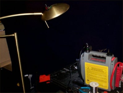

I have this nice portable battery that I can plug into my 12V devices. Here I have finished testing the lamp, taken pictures. Now time to think about additions.
There is a number of instructables out there that deal with steampunk, and as this is a brass lamp, it could take some mods, some wood accents, and black painted designs to qualify it as steampunk.
I could add a carved wooden crest to the front of the lamp, maybe add a meter to make it look better, skin the meter in wood. Ow that idea hurt, I could have used a sheet of thin plywood instead of the vinyl. Damn, Damn, Damn.
Final note, before someone asks, I did meter the lamp out and determined that it draws 0.3A at 12V that is 3.4 watts. YES! I replaced the 100 watt fire starter with a 3.4 watt LED lamp. That's gonna save on power. Even more if like me, you use solar cells to charge up a deep cycle battery to run lights like this.
