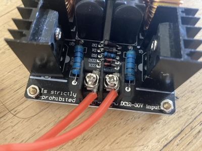

Step 2: Choosing a Power Supply
The low-voltage DC input is the foundation of your entire project. The ZVS driver typically wants 12–30 V DC and draws 5–20 A, depending on your transformer and desired output voltage.
Here's what I used:
Its a 24V 15A switched-mode power supply. It's cheap and gets the job done.
Other options:
Bench power supplies work even better if you want adjustable voltage and current limiting.
Step-down converter+ bridge rectifier + capacitors if you have those around.
If you use any power supply, make sure it is outputting DC and rectify it if needed.
NOTES: The voltage & amps rating of your power supply depend on the driver circuit you are using (see Step 3). I personally used a 12V-30V DC input ZVS Driver, so I got a 24V 15A switch-mode-power supply.
If your power supply is the right voltage rating, but your driver is still failing to start, check the amperage of your power supply. My original power supply was 24V 5A, and the ZVS Driver was trying to draw too much current. Switching it out for a 24V 15A power supply fixed the problem. Be careful though, never exceed the voltage rating of your driver.

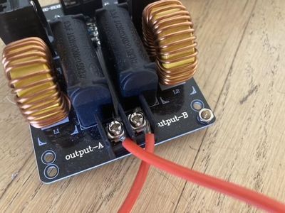

Step 3: ZVS Driver
The job of the ZVS Driver is to oscillate the input current and drives the flyback transformer efficiently.
Here's what I used:
It's rated for 12-30V DC input. I actually found that buying a prebuilt driver was cheaper than building one myself.
Other options:
You can find ZVS Drivers being sold as drivers for induction heaters. Just search up "induction heater driver".
Feel free to build your own. You'll need some MOSFETs (mount them onto heatsinks, they get hot fast), capacitors, diodes, resistors, and inductor. Reference the schematics and search up a guide. (Here's one I found: https://www.instructables.com/ZVS-Driver/)
NOTE: Some drivers will have three output terminals. If this is the case, it just means you need a center tap when wiring the ZVS driver to the flyback transformer.

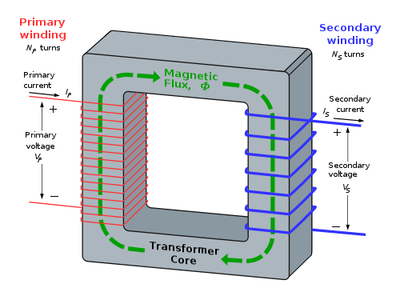

Step 4: Flyback Transformer
! This is where the voltage jumps up exponentially. Please be safe and do not attempt to do this if you don't have experience with high voltage.
Now it's finally time to generate some high voltage with a flyback. Here's a breakdown of how to connect the ZVS driver to the flyback:
Primary winding: Connect the ZVS driver output to this part of the transformer. Usually five to ten windings on the primary is perfect.
NOTE: If you have a third terminal at the output of your ZVS driver, you will need a center tap. Refer to a schematic with a center tap and search up a guide on how to wire it correctly.
Secondary winding: This is already wound internally and the output is what produces the high voltage. Make sure it is insulated in some wax, epoxy, or something that prevents the windings from arching to themselves.

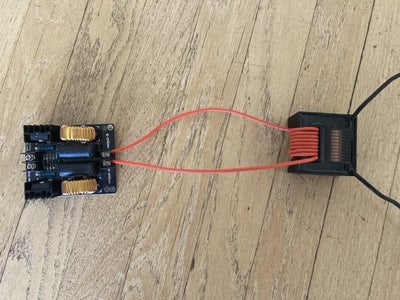

Step 5: Wiring It All Together
Before you turn anything one, make sure it's all wired correctly.
Connect the DC power supply to the ZVS driver input. (see Image 1)
Connect the primary coil of the flyback to the ZVS driver output. (see Image 2)
Ensure the secondary winding is not near or touching anything. This is the high voltage output.
Make sure everything is on an insulated/non-conductive surface (e.g. wood).
