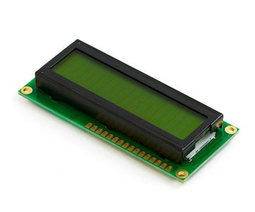

In this instructable I'm writing about 16x2 LCD interfacing with msp430g2553 microcontroller. If you don't know about 8 bit mode then I recommend that you read my instructable on 8 bit interfacing. Now I'm assuming in this instructable that you've already read that part.

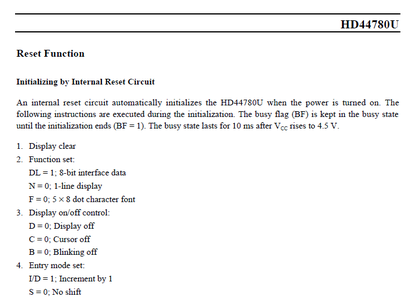

This is perhaps the most tricky part of this interfacing. When LCD is powered ON it is by default in 8 bit mode.
reset(see pic)

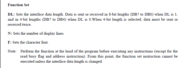

The function set bits are explained in the following section.
functions_mode_set_bits(see pic)
We need 4 bit mode so make DL '0'. Thus the upper nibble of the command code is 0010b which is 0x02. If we need 2 lines we set N and the normal font so F is 0 thus lower nibble comes out to be 1000b i.e 0x08. Thus total command code is 0x28.
