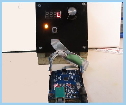

For the Dupont wires, locate the two LED where at each LED will be a manufactured hole as shown. Additionally at the location marked LED2 is another manufactured hole that is associated with the pushbutton. Simply solder the stripped end of the severed M-M Dupont through the holes. The colour scheme has no bearing on the functionality but here red was used for the two LEDs and the blue for the switch. Some times it is helpful to keep thing simple with a bit of uniformity.
Step 4: Wiring
The diagram shows an equivalent wiring of the LEDs and pushbutton of the Prototyping Shield. The GND connection to the Arduino part of the shield’s pin configuration, to work with the following code the male Dupont pins must be connected as:
- LED1 to Arduino Pin 8
- LED2 to Arduino Pin 9
- Pushbutton to Arduino Pin 2
Plug the Prototyping Shield onto the UNO or UNO stack. The ‘nifty’ platform hardware is complete.

The Prototypingnippet code uses the wiring of the Prototyping Shield from Step 4 and has essentially the same goal of proofing the shield but by using the pushbutton not as a toggle but HALT event. The code is not elaborate and is commented. Some output to the serial port is provided mostly to show the sketch is executing the loop. The HALT is performed if the shield’s pushbutton is held down for at least 1.25 seconds. Once the Halt is requested the sketch performs a ‘shutdown’ sequence of blinking LED and then literally whiles away the time away.
