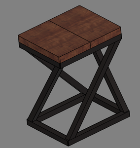

Look how easy is to make a Bench Twist Furniture on Fusion 360.

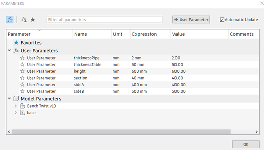

Step 1: Drawing and Parameters
With this parameters you can change the measurements of this projects.

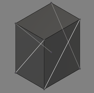

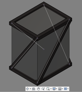

Step 2: Box and 3D Sketch
Follow this parameters to make the box and the lines to create the pipes.

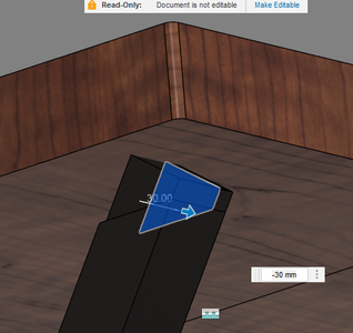

Step 3: Split Face
Use the Split Face tool to cut the pipe. Select all the 4 faces of the pipe and the top and bottom face of the horizontal pipe.

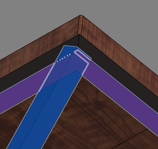

Use the Press Pull tool to cut the excess pipe.

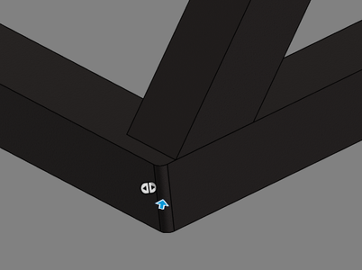

Step 5: Fillet
Add some fillets to this project !!!
