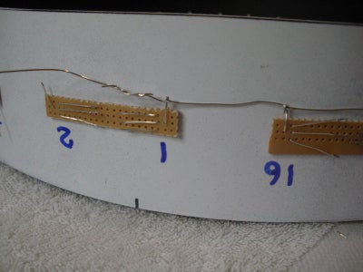

This step can be tricky to understand, the RGB LEDs have to be inserted from inside the circle through some perforated board on the outside.
Insert the LEDs:
- Lay the Inner Wall down flat in a well let work area
- Mark where the controller will be placed, it should be where the seam is on the inner wall.
- Starting to the side of the seam, place a LED through the hole from the inside.
- Align the flat part of the LED case down, so the leads are vertical.
- Take a piece of perfboard, the size for the inner walls, and insert the LED leads into their holes.
- Once they are in place, bend the 3 leads towards the center of the perforated board and the common anode(purple on the diagram) lead pointing upwards.
- In the same fashion, place another LED through the inner wall and position the leads onto the same perforated board, so two LEDs share a single perforated board, but the common anode pin should be on the other side, both common anode pins should be on the outside ends of the perforated board. With the other three leads on each bend inwards towards the center.
- Continue all the way around in the same manner, making a mistake here means changing it later when it will be more difficult, so double check everything.
- Optional: Label the LEDs, 1-16 then 1-16 again, so all 32 LEDs are labeled.
Running The Anode Wire:
- Start by stripping the included solid strand wire bare. It can also be cut into two pieces if you like.
- Starting at the controller point, hook the first LED's anode(longest lead, was bent upwards) around the solid strand wire leaving 1/2" space between the wire and perforated board.
- Solder it in place and snip off the excess.
- Continue all the way around, connecting all the LED's anodes to the solid strand wire, leaving a space. Try to keep it neater than in the images...
- The wire comes in two 31" lengths so in the middle somewhere it will need to be spliced together.
- Straighten out the wire and make sure there is a 1/4" to 1/2" space away from the perfboard, out of the way.
- Solder all the connections, make sure the joints are nice and shiny, snip off the the excess of the lead.

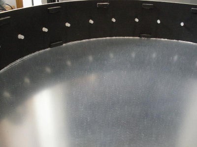

- Lay the frame face down on a towel or blanket on table with good light. Don't let it get scratched.
- Take the 1/4" two way mirror, remove the masking on the non-shiny side, and place the mirror shiny side up(so it will be on the inside) into the frame. Leave the masking on the shiny side for now.
- Center the round two-way mirror in the hole. Use a flashlight or something to shine under the frame to see if it is centered. Should be 1/4" all the way around. This is real important to get right.
- Using a tube of the included glue, apply a fat bead, 1/8" thick or so, around the outside of the two-way mirror, right up to the edge.
- With the rear mirror installed in the inner wall, so it can keep it shape, carefully stick the open side of the inner wall onto the glue, the two-way mirror should fit inside, if not wiggle it til it does. Try not to slide the mirror around.
- If you feel the two-way mirror may have moved, check either by viewing it from the front, or measuring the distance between the inner and outer wall all the way around. It should be 2.75", some of the support ribs can be used to help center the inner wall.
- Place a few items on the inner wall's top edge, to weigh it down enough to keep it tight to the frame.
- Wait for the glue to dry before moving it, the ribs can be installed while it is drying.
- If you haven't yet, double check the position of the inner wall is correct.
- Apply some more glue to the seam, especially where the first bead didn't ooze out. Keep it off the wires and controller, but otherwise be generous.
- 8 of the ribs go on the bottom, Start by test fitting the bottom pieces all the way around.
- Once they are positioned evenly, pull one out and apply glue to both ends and one long side of the piece.
- Put it in, and don't push it to the bottom until you have it straight then push down, so the glue on the bottom doesn't get smeared.
- Apply a drop of glue, on either end of the support where it meets a wall. These should be well adhered.
- They should sit flush with the top/back of the inner wall, the outer wall is 1/2" deeper than the inner.
- Glue can only be applied to the ends.
- Wait for them all to dry, then apply some more glue if you still have some left, to reinforce the support ribs.

- If you haven't yet, take out the rear mirror and remove the masking on the rear and the front.
- If you got any finger prints on the mirrors use some Windex or similar non-streak glass cleaner and clean both mirrors to perfection.
- Re-install the rear mirror
