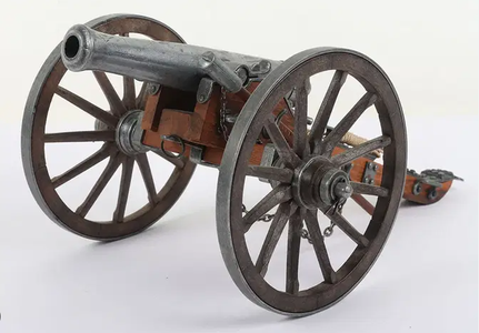

This is my mainly 3D Printed version of an 1861 Dahlgren 12 Pounder Cannon.

I went online and found some free images of the Cannon that I thought might print reasonably well in component form.
This 1861 Dahlgren 12 Pounder will do nicely, I would like to use some other material as well in this project like Galvanized wire for the carriage lift handles etc.
I will copy the Image and use this as a reference throughout the design stages in Canvas form.
