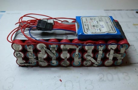

I wanted to build a high-voltage battery pack from laptop-reclaimed 18650 cells. (for an e-bike) DIY solutions either required soldering to the cells (heat bad for the cells, no good way to swap out bad cells), spot welding (spot welders for this application are $$, also no way to swap out cells that go bad), or building (somewhat) elaborate enclosures that allowed for battery replacement.
All these solutions also required sanding/grinding off all the nasty little bits of nickel strip that remained after separating the batteries from their laptop bodies.
