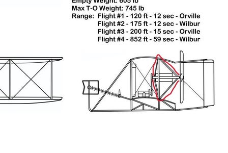

Step 1: Main Wing Assembly
First step is to print out the template and cut out the front and back wings. Then mark the spots for the supports with a knife or drill bit. Cut out 18 of the supports but only glue the back row on. Make the motor by cutting a piece of skewer and sanding down a side to make it flat. Then drill a hole and stick a small piece of wire into it. Make the propeller shafts by cutting out a piece of wire and gluing the wood supports on the top and bottom(pic. 13, 14, 15). Add some horizontal spacers for the propeller shafts and glue those in place. Glue the motor on just to the right of the center(pic. 17, 18)(The back support in the picture is centered). Take the thread and glue in onto the motor, wrap it around one of the propeller shafts, loop it back around to the motor, then wrap it around the other propeller shaft back to the motor. Glue on the rest of the back supports and then put the top wing on. Make sure to add two "ribs" to the underside of the top wing(along the dotted lines in the template) before gluing it on. (Optional) Curve the edges of the wing with sand paper.
Step 2: Main Frame and Front
First step is to start with the side profile on the template, cut out the main horizontal and vertical supports and then glue them together. Cut out two pieces, for the width, and glue one to the front and one to the back. Cut out both of the front wings. Then drill two holes the same width as the frame and centered up and down(pic.4). Glue the wing with holes on first(about half way down) and then the one without holes centered on top. We will add additional supports later.
