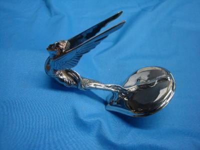

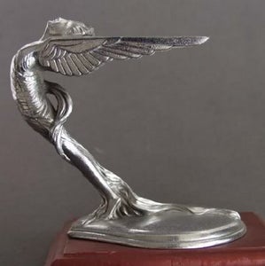

My Father-in-Law is a big classic car guy and one of the cars that he as restored is a 1932 De Soto. Unfortunately the Mascot (Hood Ornament) was missing and getting an original is nearly impossible and a replica was very expensive. When we were at the 2012 Back to the fifties weekend car show in Saint Paul,t MN I said "you know Les, I could probably make one, it won't be perfect, but from 20 feet away you wouldn't be able to tell."
I've never made anything like this before but that's never stopped me in the past. With a basic understanding of the investment casting process I started to stumble along the steps you'll see laid out in this instructable.

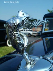

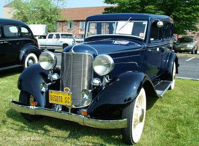

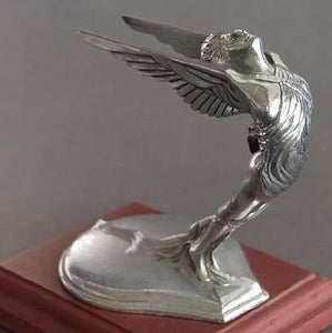

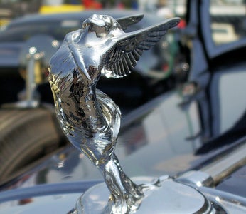

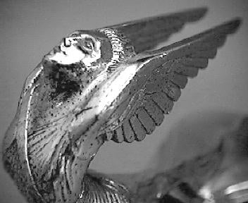

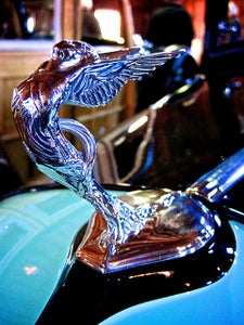

Fortunately since I was at a car show I should be able to find other examples to take pictures and take measurements. Unfortunately the 1932 De Soto is a rare car so the only thing close was a 1933 De Soto. The mascot is very similar in design, but she's swept forward more than a 1932 mascot. The internet filled in the rest of the information I needed along with the dimension from where she will be mounted.

I received two successful metal castings from the original four wax models. One ceramic mold cracked in the kiln and the other failed the pour because it solidified too early using a brass alloy. The two good ones were a zinc alloy.
Step 7: Finishing and Polishing
The 1st four pictures are what I received from the foundry. The rest of the work is smoothing detailing and polishing.
Hand files are used to smooth out the surface and files were used to deepen some of the details.
A bench grinder with buffing wheels and polishing compound was used to polish the surface. A dremel was also used for some of the harder to reach areas.
Sorry I don't have a picture of it on the car, but from 20' away you can't tell that an engineer with no artistic ability made it. (with a little help from his friends)
