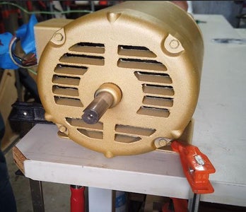

Step 4: Bench Test the Motor to Make Sure Your Electronics Are Right
  1. I clamped my motor to my
  2. Plugging in the VFD to the 120v circuit, I was nervous. I had a fire extinguisher ready but that was unnecessary.
  3. When I turned the VFD on, it makes a bit of a buzz. When I turned the potentiometer and the motor shaft started turning, it felt like MAGIC!
  4. I ran the motor for a 5 minutes and made sure the wires didn't get hot.
  5. After I was confident I wouldn't burn anything down and that this set up was going to work, I decided to mount the motor underneath the bandsaw.

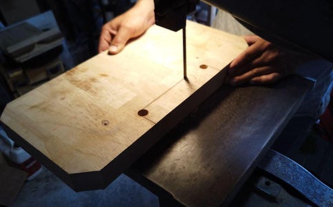

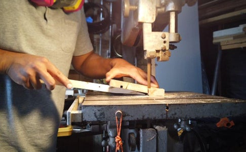

Step 6: Start Using Your Bandsaw With Variable Speed Control!
Once I started using a bandsaw with variable speed my curiosity has been increased in both bandsaws and motors. I'm not quite done with either of my bandsaws but I'm learning a lot and hoping more people can get into upgrading and modifying bandsaws to do interesting things along with upgrading other equipment. Below are some of my thoughts:
  1. The expensive part of these machines is the VFD. I think I can use a 220v twist lock plug to connect the VFD to different motors as long as they’re the same power rating (HP or watts, 745.7watts = 1hp). This way I can use different equipment powered by one VFD and plug into the VFD into different machines as long as they run on the same horsepower.
  2. Having variable speed on machines is a dream. I like the soft start, the quick adjustments that can be made with a potentiometer along with the smooth running nature of the motor is nice.
