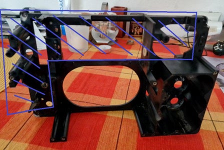

I took out all inner stuff firstly, including old potentiometers keeping sole skin of the radio. As my intention was to keep inner bezel to hold and support original speaker, I kept this part, I just removed parts of it by using a handsaw to free some space so it is not blocking area where I intended to put potentiometer, rotary encoder and Pimoroni display. Later I also partially removed plastic battery compartment as it was blocking a lot of space which I used for positioning Raspberry Pi in the end.
The radio has been put aside for a long time so I also spent some quality of time to clean it to refresh outer colours and texture.

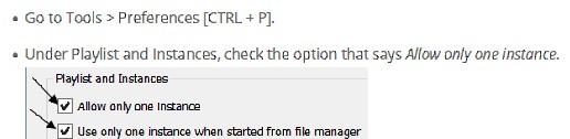

For playing m3u streams cvlc (command version of vlc) is used while only one instance of vlc is allowed at a time which had to be defined in vlc preferences to play one radio station at a time.

After decision to remove almost complete inside of the radio as well as all original knobs and buttons assembly has been a challenge and had to be considered thoroughly from early phases of the project.
For the final assembly I used:
  • One original screw hole close to small transparent window for Pimoroni screen device positioning and with two cork pieces pushed between the device and radio walls I disabled any device rotation displacement to the sides (I did not want to attach it permanently in case device would have to be removed or replaced)
  • Two orginal holes at front for mounting both RGB potentiometer and rotary encoder (both had to have thread to screw it between front panel sides) with two newly purchased beautiful knobs fitting the overall radio style - though RGB potentiometer comes with a transparent knob for LEDs to shine, I removed it for design reasons and went for the purchased one
  • One orginal hole at the side for external switch (also with thread to screw it between wall sides), the other one was filled with a plastic hole plug fitting the hole diameter
  • One original hole at the back for micro USB female plug sugrud to a plastic hole plug fitting the hole diameter
  • One smaller-sized plastic hole plug to fill in antenna hole at the top - obviously not needed with wifi radio ;-)
The rest was about making all the wire connections inside and securing them using insulating tape and "gluing" LED on one of the side walls from inside.
Unfortunately I was not able to secure (mount) Pi as I thought but the good thing is there is not a space for Pi to move freely even if it is laying there (where battery compartment used to be) just like that.
