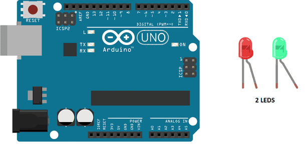

Introduction: 2 Alternating Blinking LEDs With an Arduino
I created an Arduino Uno circuit with 2 LEDs that alternate blinking.
Instructor: Mr. Sweet
Source: Mechatronics 1 class (SparkFun SIK Kit)
You will need:
  1. 1 Arduino Uno
  2. 1 power source (I used a Chromebook)
  3. Something to code on (I used a Chromebook)
  4. 1 cord to connect Arduino Uno to your power source
  5. 1 small breadbord
  6. 2 LEDs (I used red and yellow)
  7. 1 100 Ohm resistor (You can also do it with 2, but I won't show you how to do that in this instructable)
  8. 4 jumper wires (I recommend using black and red for negative and positive)
Step 1: Connecting the LEDs and Resistor
Place both LEDs in your breadboard as shown in the image, with the cathodes (the cathode is the long leg) on the outside and the anodes in the same hole on the inside. Then, place your resistor as shown in the image, with one end in the same hole as the LED anodes and the other end in a negative hole in the same column.
Step 2: Wiring Your Circuit
First, connect a jumper wire to ground on the Arduino and to the hole directly to the right of the resistor in the negative row (image 1). Second, connect jumper wires from the LED cathodes to the 13 and 12 pins on the Arduino (I connected the red LED cathode to pin 13 and the yellow LED cathode to pin 12) (image 2).
