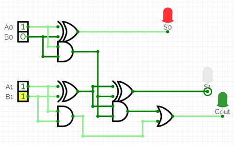

Step 7: Let’s Build the Hardware: Assemble the 2-bit Adder- Understanding
1. Let’s begin the build for the 2-bit adder. Follow the schematic to ensure the wires are going into the correct logic gates. (Recall, that each chip has 4 logic gates with 8 inputs and 4 outputs).
2. Play around with the schematic by creating it yourself to develop further understanding. You will observe how the inputs affect the binary output.
I have also attached an image of the wiring for the 2-bit Adder.

2. I would suggest placing the XOR chip closest to the dip switch, followed by the AND chip, and finally the OR chip. Connect the top left pin of the chip to power and the bottom-right pin to ground.
3. Add the three LEDs to the right end of the Breadboard. Connect the cathode to the ground. The anode will receive power from the outputs of the logic gates.
4. Order the LEDs from Least significant to most significant. The Sums and Carryout should be two different colours. Connect each of the anode legs of the LEDs to the Analog inputs of A0, A1 and A2 on the Arduino UNO.
Step 9: Let’s Build the Hardware: Complete and Test the Adder Circuit
1. Once the 2-bit adder circuit has been completely built, you must test it.
2. Connect the Adder circuit to power and ground, to ensure it's working properly.
3. You will know it's working properly if the LEDs blink by following the pattern of the schematic, and TinkerCad circuit.
Once tested, begin the second phase.

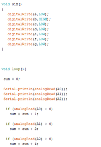

Step 11: Let’s Write the Software: About the Code
Copy the code (Refer to the next section) onto the Arduino IDE. (ATTACH Link to code), and upload to the hardware using the USB cable.
- The code is directing the 7 segment display to output a decimal value based upon the binary values of the LEDs.
- The code is dictating when the buzzer will sound. In my circuit's case, it will ring when the display shows a 5.
I have included additional descriptions in the code to help you understand each line.

//define each digit from 0-6. High represents OFF and Low represents ON for each bar between a-g
// run calculations to convert led signals (Binary) to a digital number
void loop(){
// set starting value as zero
sum = 0;
// define analog pins A0-A2 as read. They are already input so no need to define them as I/O
// Serial.Println prints data to the serial port as human-readable ASCII text followed by a carriage return character (ASCII 13, or '\r') and a newline character (ASCII 10, or '\n'), in this case it reads the analog input on pin A0-2
Serial.println(analogRead(A0));
Serial.println(analogRead(A1));
Serial.println(analogRead(A2));
//establish
if (analogRead(A0) > 0)
sum = sum + 1;
if (analogRead(A1) > 0)
sum = sum + 2;
if (analogRead(A2) > 0)
sum = sum + 4;

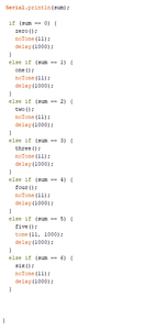

//to display the digital equivalent value on the monitor
//call out the equivalent sub program (Void) base on sum (e.g. if sum = 0, run the digital 0 generator script)
//Add buzzer feature, to turn on when the total is 5
Serial.println(sum);
if (sum == 0) {
zero();
noTone(11);//use notone to mute the buzzer for all non-5 numbers
delay(1000);
else if (sum == 1) {
one();
noTone(11);
delay(1000);
else if (sum == 2) {
two();
noTone(11);
delay(1000);
else if (sum == 3) {
three();
noTone(11);
delay(1000);
else if (sum == 4) {
four();
noTone(11);
delay(1000);
else if (sum == 5) {
five();
tone(11, 1000); //use tone to ring the buzzer when display reads 5
delay(1000);
else if (sum == 6) {
six();
noTone(11);
delay(1000);
//close program scirpt
