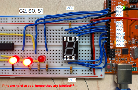

Step 2: Adding 7-Segment Display and LCD
Once your adder works, you're going to need to connect wires from the LED outputs (S0, S1, and C2) directly to 3 pins of the Arduino to display the result. Start by wiring the outputs of the adder to the Arduino pins listed below. These connections are important in the upcoming coding sections, which will be further explained. Here are the pin connections for the outputs:
S0 = Pin 3
S1 = Pin 4
C2 = Pin 5
The next step is to wire your 7-segment display and LCD. The seven-segment display has seven LEDs arranged to form numbers, with each segment labeled a through g. Two pins are connected to power via 330Ω resistors. To control the display, connect each segment pin (a, b, c, d, e, f, and g) to the corresponding Arduino digital output pin. In this way, you can set the corresponding Arduino pin HIGH or LOW in your code to turn each segment on or off, displaying the corresponding adder sum (further explained in the coding section). Make sure the wires are in the correct pins and are deep enough in the Arduino, as if they are not securely connected, they will flash and become glitchy. Here are the pin connections for the seven-segment display:
Segment a = Pin 9
Segment b = Pin 10
Segment c = Pin 13
Segment d = Pin 12
Segment e = Pin 11
Segment f = Pin 8
Segment g = Pin 7
The next step is to add your LCD. An LCD (Liquid Crystal Display) is a screen that shows text, numbers, and symbols so that users can see output straight from an Arduino. In this case, the 16 x 2 shows 16 characters across each line, with two rows. To simplify writing, the LCD uses a I²C interface using two communication pins, Serial Data (SDA) and Serial Clock (SCL). The SDA pin is used to send and receive data between the Arduino and the LCD (letters, numbers, and commends), whereas the SCL pin carries the clock signal (which indicates when to read data sent via the SDA line). Both are connected to analog pins: in the example above, the SDA line (white wire) is connected to A4, and the SCL line (brown wire) to A5. Here are the pin connections for the LCD:
SDA Line = Pin A4
SCL Line = Pin A5
