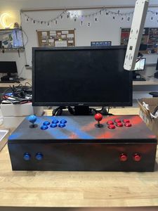

Step 3: Prototype
Now that you have RetroPie set up on your Raspberry Pi and have confirmed it's working, it's time to prototype the arcade machine. Using cardboard as a temporary prototype is a great idea because it allows you to experiment with the layout of the buttons, joysticks, and overall design before committing to the final materials.
Here’s how you can create a cardboard prototype for your arcade machine:
What You’ll Need for the Prototype:
  1. Cardboard (preferably thick and sturdy for better durability)
  2. Ruler and Measuring Tape (to ensure your dimensions are accurate)
  3. Pen or Pencil (for marking the layout)
  4. Scissors or Craft Knife (for cutting the cardboard)
  5. Hot Glue Gun or Tape (for assembling pieces)
  6. Arcade Buttons and Joysticks (to visualize and test the layout)
  7. Raspberry Pi (for testing the setup with the controls connected)
  8. Zero Delay USB Encoder (to connect the buttons and joysticks to the Raspberry Pi)
Step 3: Prototyping the Arcade Machine Using Cardboard
Instructions:
1. Plan the Arcade Layout
  1. Measure the Size of the Arcade Box:
  2. Decide on the dimensions of the arcade machine. A common size for an arcade control panel is around 24 inches (60 cm) wide and 10 inches (25 cm) deep, but feel free to adjust based on your preferences.
  3. Sketch the Layout:
  4. On a piece of paper, sketch how you want the buttons and joysticks to be arranged.
  5. Typically, you would have two sets of buttons and one joystick per player. You can arrange the buttons in a 3x3 grid for each player, with the joystick beside them. Include space for start/select buttons as well.
2. Cut and Shape the Cardboard
  1. Cut the Main Control Panel:
  2. Using the ruler and pencil, mark the dimensions of the arcade control panel on the cardboard.
  3. Carefully cut out the shape using scissors or a craft knife.
  4. Cut Holes for the Buttons and Joysticks:
  5. Using your sketch, mark the spots where the arcade buttons and joysticks will go.
  6. Use a round object (e.g., a spool or a circular template) to trace the correct sizes for the button holes. For the joystick, you can cut a slightly larger hole for the base of the joystick.
  7. Carefully cut out the marked holes with scissors or a craft knife.
3. Test the Layout with the Components
  1. Position the Arcade Buttons and Joysticks:
  2. Take the arcade buttons and joysticks and place them into their respective holes in the cardboard.
  3. Use tape or a small amount of hot glue to secure the buttons and joysticks in place temporarily.
  4. Connect the Buttons and Joysticks to the Zero Delay USB Encoder:
  5. Use the 3-pin wires to connect each arcade button and joystick to the Zero Delay USB Encoder. The encoder will send signals to the Raspberry Pi to register button presses.
  6. You can connect each wire to the appropriate pin on the encoder based on your layout.
  7. Test the Controls:
  8. Plug the USB encoder into one of the Raspberry Pi’s USB ports.
  9. Power on the Raspberry Pi and check if the buttons and joystick are mapped correctly in RetroPie.
  10. You can test the configuration by navigating through the EmulationStation menu and seeing if each button press is recognized.
4. Adjust and Refine the Prototype
  1. Test the Button Layout:
  2. If needed, adjust the placement of the buttons and joysticks by cutting new holes in the cardboard or shifting them around.
  3. Ensure that each control feels comfortable and easy to use.
  4. Re-test the Connections:
  5. After adjusting the controls, re-test everything to make sure that all the buttons and joysticks are properly connected and working with RetroPie.
5. Assemble the Cardboard Prototype
  1. Secure the Components:
  2. Once you're satisfied with the layout, use hot glue or tape to firmly attach the buttons and joysticks to the cardboard control panel.
