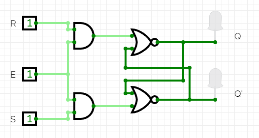

Step 3: Constructing the Gated SR Latch: Placing Components
First place the dipswitch, AND and NOR gate chips as well as both LED outputs (representing Q and Q not) for the latch onto the mini breadboard.
Then jump power from the power rail using wires to 3 of the top pins of the dipswitch (representing Enable, Reset, and Set) and jump ground from the ground rail using 10k Ohm resistors to the corresponding bottom pins of the dipswitch.
Next Jump power and ground from the corresponding rails to the VCC and GND pins of the AND and NOR chips (Top left and bottom right respectively)
Finally, jump ground to the cathodes of the LED's using 330 Ohm resistors
Step 4: Constructing the Gated SR Latch: Logic Connections
Now that we have placed the components, we need to string the logic together to create the latch. A schematic and picture of the real circuit is provided above.
The general rundown is connecting set and reset to their own AND gates with the second AND gate input coming from enable. The the outputs of the AND gates connect to their own respective NOR gates, the output of these gates are connected to Q and Q not respectively. The second input to each of the NOR gates comes from the output of the other NOR gate. This allows the circuit to latch a value and keep Q and Q not in opposite states.

Gated SR Latch:
The image above is a truth table for the circuit
Q not is 1: pause
Q not is 0: un pause
