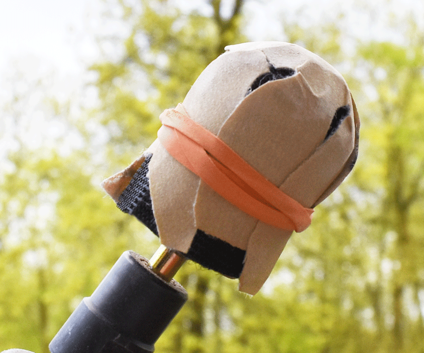

Step 1: Prepare Your Bench Top
A dowel of any size can be used depending on functional choices. I recommend 1/2" or bigger diameter for most woodworking applications. Drill a dog hole in your bench top, enlarge the hole with a file and a smaller dowel wrapped in sand paper. The fit should be tight, there should be <0.5 mm of wiggle room. If it is too loose it may damage your dog hole over time.
