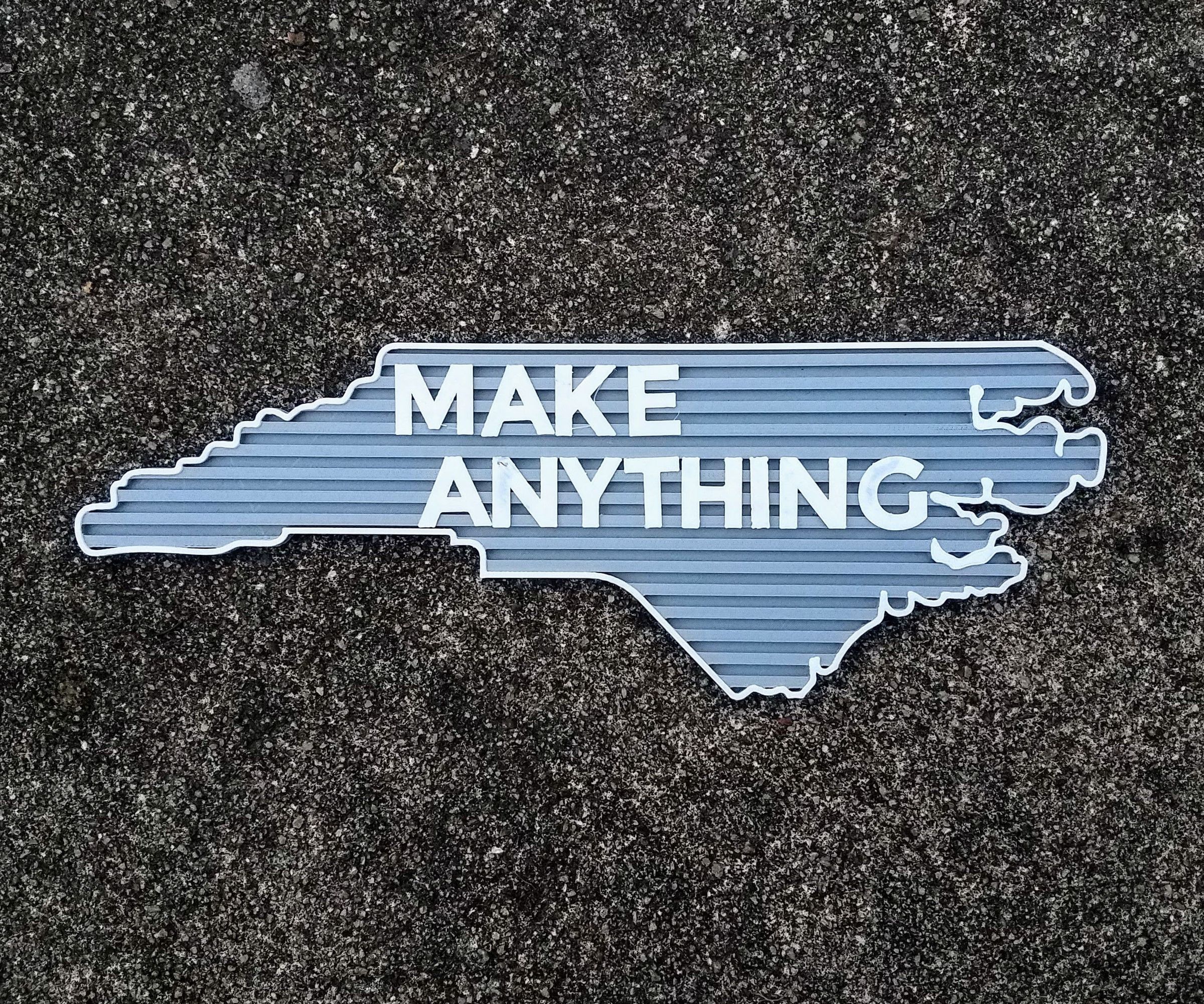

- On your CAD file, extrude an outline of your features another increment in the Z to make a cool accent around your base color. You can see my attempt at this in the first picture.
