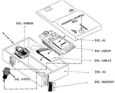

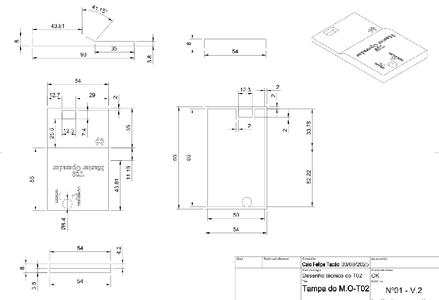

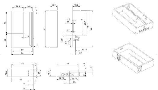

Step 1: 3D Printing of Cases
In order to support the entire internal structure and use the ESP32's Bluetooth serial communication, I decided to design the protective and containment covers for the entire circuit. I will make the STL and g.code files available below so that you can print the cases; in my case, I used the Creality Ender 3 printer; the photo above shows the "exploded view" of my equipment.

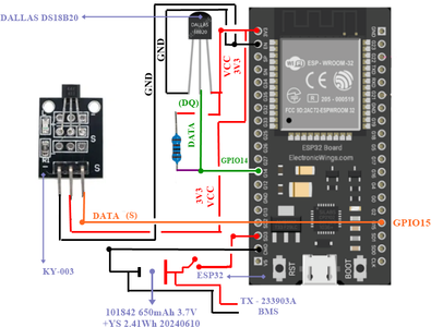

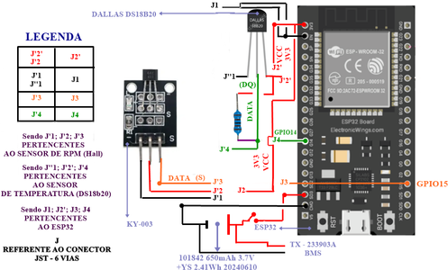

Step 2: Creation of the Electrical/electronic Circuit
CAUTION: Here you have access to the electronic circuit I created for this project. Follow exactly what I describe, as the programming will govern all inputs and outputs used on the ESP32 microcontroller. The first image shows no connectivity via the JST connector, while the second image reveals the use of the 6-way JST connector's inputs and outputs... although you may notice that I only use 4 ways...
What I'm telling you is that FOLLOW THIS ENTIRE SCHEMATIC AND NOTHING CAN GO WRONG - I know that such equipment has its costs, and I'm not someone who's in trouble and will make you waste your money on something useless.

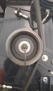

Step 3: Creation of Sensors - RPM Hall Effect

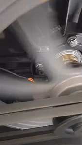

Due to the inspection points of agricultural machinery, I decided to make some observations. I noticed right away that the frames where the shafts that rotate the pulleys go have a spacing from the bearing base to the pulley coupling of about 50 mm. Based on this information, I knew where my limit would be (45 mm total height). Based on this height, I developed the Hall sensor head... and I'm making available all the parts I printed on my 3D printer.
The Hall sensor is flexible and moldable to the height by tilting, similar to a joystick system; this guarantees me malleable heights and better reception of the distance and recognition of the neodymium magnet placed on the shaft between the bearing and the pulley.
I know... my design is very amateurish and without any finishing, but I will improve it, I swear!!!
To adjust the tilt, simply turn the bottom cover of the sensor and tilt it to where you want the inspection magnet to be.
important detail: when you are going to unify all the parts... I used epoxy adhesive-based glue, or epoxy glue... remember the rules of fitting and geometry, the cover I mentioned previously, MUST be placed before the sensor head, otherwise... nothing will work as it should...
The fixing style I used, knowing that all the parts are metallic, from the base of the bearings of the agricultural machines; was through magnetic fixing, with the help of 4 neodymium magnets.

For the practical and minimalist design of the DALLAS Ds18b20 temperature sensor, I made a protector for the sensor via 3D printing; the entire circuit was made (OBSERVE THE DIAGRAM TO MAKE THE EFFECTIVE CONNECTION OF THE ELECTRONIC COMPONENTS TO THE SENSOR).
I will be making the print file for this part available.
NOTE: For a completely plausible sensor attachment, you must run the 3 wires before soldering the 4.7K resistor inside the 3D printed structure, otherwise everything will go wrong.

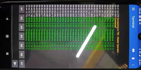

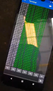

Step 6: Tests and Data Obtained.

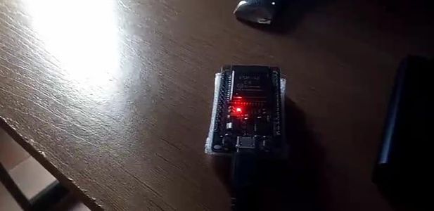

Now, on your smartphone, install Kai Morich's Serial Bluetooth Terminal 1.49 (many thanks to the developer!
Open the terminal, turn on the device using the switch, and connect until the "Master Operator" message is connected. Observe the data computation... The programming I used reads data every 5 seconds. You can change it if you want, but I'm concerned about data refresh and the accuracy of the responsive circuits...

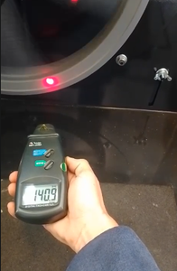

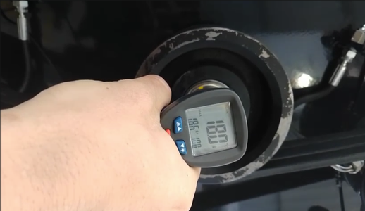

After turning on my data transmitter... and pairing it with the application, it was time to connect them to the machine I need to inspect, of course... with my equipment properly calibrated by the company, where there are no discrepancies in the inspections... I took the real test if my equipment would work for something and after that I calculated the deviations and the results were.......
Fantastic, as you can see in the photos, for the RPM sensor, the reading with the equipment I use reached 140 RPM, while mine, developed with a KY-003 Hall sensor, registered 144 RPM; that is, an error of 2.85%. While the temperature sensor... my thermometer registered around 18°C and my sensor DALLAS Ds18b20 identified a temperature of 17.69°C, with an error of 1.72%.
So... I was successful, thank God!!!!
