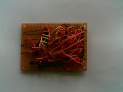

i spent some time thinking on how it could be possible to drive my stepper with only two cables.
then i could use the rest (i have 4 more good outputs remember), to address switches,and boom,i have 16 motors running with only 6 cables (in theory)
i have already built a 2 bit data select device prototype designed to work with this baby.
so i can control 4 motors with 4 cables. (2 for addressing,2 for this device i'm about to reveal)
at the heart of the device is a 4029 4bit up/down counter.
the counter creates a sequence on its four outputs,counting from zero to fifteen(in binary mode),
of fifteen to zero.
it has the four output lines we need,but not the right sequence.

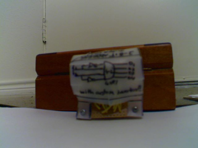

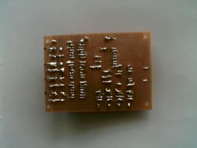

Step 3: Step 3
our counter has four outputs,that is four binary digits.
in binary mode (not decimal),the three digits from right to left repeat themselves after eight counts.
so the last three digits remain the same when we're counting from zero to seven,
or eight to fifteen.
we can use these three outputs to create our sequence.they will keep repeating in the same order forever.
the rest is very simple.
for example for the very first number 'zero',that our counter throws at us,
we have to create '0001'
easy,
0000 ?=> 0001
dcba 4321
now remember we don't care about the fourth digit,
then,
000 ?=> 0001 output
cba 4321
so in order t get output 1 high,
we need, NOT a and NOT b and NOT c
therefore,
output1 is 1 when a'&b'&c' is 1
we will have a table,of all these conditions once we write the logic statements for each member of our output sequence.
notice,the second count,which is 0001 must turn on output1 and output2 at the same time.
output1 and output2 is 1 when a&b'&c' is 1
to do this,i used general purpose diodes.
while the output of the first statement is directly connected to output1,
output of the second statement is connected to output1 and output2
to prevent unintended triggering,i simply placed diodes between the statements which trigger more than one output.
we will have only two inputs,one will be connected to pin 15 of 4029 (CLK)
and the other to the pin 10 of 4029 (1 up/ 0 down).
the outputs are more than strong enough to drive the steppers that i have,but i recommend using them as triggers.
the whole thing is easier to understand once you see the schematic.
i just wanted to go over the theory here.
parts used here are:
(8) NPN 2N3094 transistors
(8) 4001 diodes
(4) red LEDs (i was out of diodes,LEDs worked just fine for this application)
(1) 4029 4bit up/down counter
(1) 4009 hex inverter
(3) 4081 quad 2 input AND gates
total cost:
$7-$10
i will try to post a video of the device running soon
please feel free to make suggestions,criticize,or ask questions.
