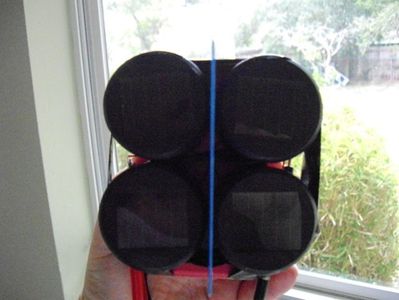

Grab a couple of those cheap garden path solar lights, the kind they sell at the Dollar Store for... well, a dollar. (If you miss the occasional Dollar Store deal on those, damn, you'll probably be out of pocket by two dollars from a more expensive store! :-) )
That's it - to test the circuit you won't need any more components. Just your trusty volt meter, and a soldering iron... (I finally treated myself to a programmable temperature controlled iron from Radio Shack and I have to say I'm really enjoying using it compared to what I had before. The volt meter is that cheap one that's on sale for a couple of dollars every weekend at Harbor Freight)
When I was trying to drive the motor and realised I didn't have enough power I added a second pair of PV cells in parallel, so some of the images below have 4 cells and some have 2. As long as we're just using these as light sensors, 2 will do fine - I didn't feel it was necessary to reshoot the photos...

Connect your voltmeter to the other two wires - the red ones from the PV cells or the yellow ones from the Joule Thief circuit boards,
Now either test this in the sun or use a flashlight . Compare the voltage when the light shines evenly on both photo-cells versus when it shines on each of them one at a time.
In my first test I got 1.5V when illuminating the left-hand cell, and MINUS 1.2V when illuminating the right. The voltage went close to zero when they were equally illuminated. The discrepancy turned out to be from one poorly performing PV cell so I swapped it out with another one I swiped from my garden and then they both output almost identical voltages for the same illumination.
(The raw output directly from the good PV cells was about 3.4V and from the bad one, 2.5V.)

Here I've connected the circuit to a voltmeter (as I mentioned earlier, I doubled up the cells to get more power, but it didn't really help) and took 5 readings, from well left of the sun, through half as far left, then straight on, then the same angles to the right of the sun, You can see from the readings on the voltmeter that this is a good indication of which way you need to turn and when you're pointing in the right direction.
(You'll note that the absolute values of the signals are pretty low - even when one sensor was blacked out completely and the other was in full South Texas sunlight, the best differential I've seen was 1.65V.)
