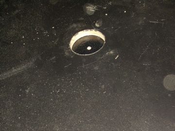

Step 5: Hole Time.
Next you'll be sliding the board into place. I had to tape it into position first to make sure it wouldn't drop out of position while I was flipping the plastic lid over again and putting it back into place on the fridge. Either have someone hold the lid in place, or screw it back in to make sure it doesn't move. Then use a 3/16th inch drill bit to make yourself a whole right down the center of the top. Most hole saws have a center bit to them, and we can use this whole as an initial gide for that bit to make sure we're centered properly.
Now hook up your 2.5 inch hole saw and set it into position and cut through the plastic lid, pull the circle you just cut out off the top, and do the same for the wooden board underneath. After pulling out the wooden circle we'll be on the metal top of the fridge. This is why you want to make sure your hole saw is rated for metal, the wooden ones wont cut it worth a dang, and you'll warp the metal from all the heat it'll generate as you waste your time grinding into the surface.
Before you try and cut through the metal of the top it's a good idea to remove the plastic top and the wooden board again to give the saw some room. The hole saw will have left a small hole you can use as a guide in the top of the metal when you cut through the wood all the way. After cutting through the metal top, pull that circle away and then you can drill all the way through the foam insulation and the plastic interior of the fridge. If you finish the cut and don't see anything that looks like a pipe split or cracked in the foam, then your set and the fridge will still work when we put it all together.
Step 6: More Drilling...
Yes I know I stuck this first image on the last step as well. Deal.
The tap tower comes with a rubber gasket that is used to insulate the area around the base of the tower as it presses into the top of the fridge (or counter for some home installs). The great thing about this is that the holes in this gasket are already in position for the screws, which means we can use it as a guide for figuring out where to drill next.
Start out by placing the gasket down and carefully positioning it so that the holes are lined up so that their parallel to the sides of the fridge. If their not aligned properly the tap tower will be on crooked when we put everything together. I strongly recommend taking Norm's advice and measure twice before drilling.

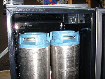

Step 9: A Small Problem...
So by now I'm sure you've tried setting everything into the fridge and found a problem... The door wont close! It's actually a very easy fix. First off a lot of people try to fit the CO2 tank into the back directly behind one of the kegs. This wont work. You need to position it between the two kegs with the regulator set up so the adjustment screw is coming straight out at you and is essentially "upside down" (Seriously see the picture bellow or it'll just sound crazy. This way everything will fit in there just fine. The adjustment screw will fit just fine resting on top of one of the kegs. The height of the thing comes out just right so that the bottom of the CO2 tank will be resting on the small ledge in the back of the fridge, the canister will be held in place by the sides of the two kegs, and the regulator's adjustment screw will be just fine and shouldn't be damaged at all.
That solves half the problem, but the door still wont close. Turns out that the only problem is the bottom shelf on the door. The other shelves are no problem and I use them to hold my yeast and hops for brewing, and the pop (Yes it's Pop, I'm from Michigan damn-it) dispenser holds some Pepsi or Coke for my friends when we don't feel like a brewski. Simply pull out the bottom shelf that runs the length of the fridge and the door will close just fine.
Alternatively you can turn the shelf sideways so that it's flush with the black plastic of the door and it'll fit just fine. I just have mine shoved in there like that to hold some micro-brewed beers. A few other people have drilled holes for the stubs of the shelf to grip into the door properly and you wont have to worry about it falling out.
