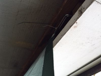

I used a 4'x6' waterproof nylon tarp that I had lying around. The bigger the tarp the more rain you will channel into your barrel. It should have grommets on the corners and in the middle of the sides (8 total). You may have to get creative with how you string it.

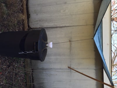

I decided to secure mine longways along the wall of the shed, just under the roof overhang. I used a couple eyelets screwed into the joists and ziptied the two corners to the eyelets, one on either side. I then strung up the other two corners at equal height. One side I strung to a nearby tree. On the other side, since there was no tree nearby, I fashioned a pole using a shovel handle that was secured to the wall with zipties and and eyelet. This is not necessary if you have something like a tree or structure to string it to on either side. You basically want something that resembles a sun shade on an RV.
Step 3: Created the V-shaped Water Channel
When you have your tarp secured and just about level with the ground, secure your rain barrel or trashcan underneath it. Tie a braided string from the center grommet on one of the long sides of the tarp. The string should be about five feet long or so. You want to weight the string down a little to create a 'V' in the tarp for the water to channel down (I tied mine to a 5lb weight on the inside of the trashcan).
What happens is when it rains and water collects on the tarp, it funnels to the point where the grommet is and through capillary action follows the path of the string. This will be described in the next step, but essentially you want the water to channel along the string, through a funnel secured in the removable top of the trashcan or rain barrel, and into the container.
Step 4: Funneling the Water

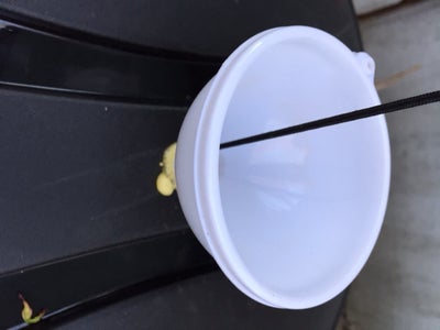

I got a funnel from the Dollar Store (3 for a dollar) and used the largest one. I drilled a 1/2" or so hole in the middle of the lid, popped the funnel in, and put a bead of expanding (Gorilla) glue around where the funnel meets the lid.
Once it dried, I threaded the string through the hole and tied it with a half-hitch around the 5lb weight I had lying around in the bottom of the trashcan. This serves two purposes. It keeps the tarp weighed down and the V in tact, and also keeps the trashcan anchored when there is no water in it so it doesn't blow away.

Although my 30gal trashcan is elevated on a couple cinder blocks, it can just as easily sit on the ground. I chose not to mess with a spigot and hose and instead lift the lid and dip a 5 gallon bucket inside. It fills quickly and I just carry it to water my plants.
The funnel/lid setup keeps mosquitoes out for the most part, since the hole is so small, and also keeps debris from entering since it's fully sealed. It's amazing how capillary action works. I went out in a rainstorm and watched the system work...the rain literally just follows the string and dumps into the container. In a recent 2-3hr rain storm, the trashcan was full at the end of it.
