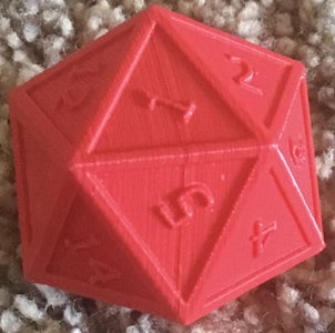

As promised, here are pictures of the 20 sided dice I 3D printed. (For some reason, 13 didn't print.)
