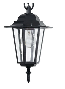

a cheap light fitting (6 Euros)

Unscrew the bottom of the light fitting and screw through it in to the end cap of the pvc pipe. I used stainless steel screws so it would last a long time. The cheap plastic lights from DIY shops can have the bulb holder mounted at the top or the bottom of the casing. After drilling a hole for the cables through the end cap and mounting the glass surround to the cap, I then attached the wires to the bulb holder and fixed it back on to the base of the light surround.

Additional things: I sprayed it black with an acrylic spray paint. I would also like to do a dry-bush effect with a gold or silver to make it look metallic, but I have not got around to that yet. I also forgot to spray the adapter, and ran out of spray as it was only an old half full can to begin with. So still some work to do, and maybe if you don't have the wires, the cement or other things lying around, you might go over the 20 quid budget. But it is still a lot cheaper than buying one, and my wife and kids love it.
