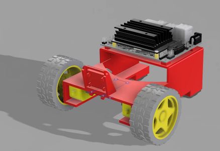

Step 8: Vision Team ( Writer : Hye-ri Jung )
We are conducting tests while studying opencv with the goal of mars rover's autonomous driving.
Currently, it is finished in the form of separating lanes by making lane divisions and small autonomous vehicles. We plan to continue making various signs classification.
[ opencv list - notion ]
[ lane detection video ]
Results of self-driving car production for track lane division
[ cam 3d modeling ]
