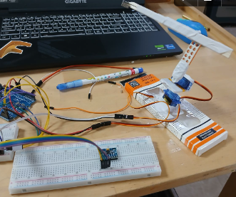

Step 4: [Code] Author: Kim Sihoo
This is rover code.
Modification is free.
