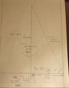

Step 1: Some Trig
The lighted section of the lights was 23 feet. So that was the hypotenuse of the triangle. I figured the angle of the tree would be about 70 degrees, so I did some math to see what the other sides would be. With the angles, the center of the tree should be about 21 feet 7 inches. So I built the center of the tree with 6 2X4 studs 8 feet long.
I laid them out 8 8 8 and then backed them with 4 8 8 4 as you can see in the drawing. Initially I put them back to back, but they were too wobbly, so i put them together in a "T".

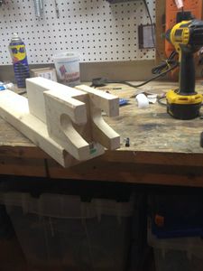

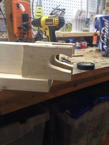

I added two 1x4 sections with a "U" cut out in the top to lay the lights in. See photo. This created two "valleys" for the light strings to go through.

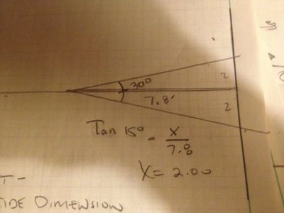

The base was a 12 sided polygon, which meant that every interior angle was 150 degrees, or 15 degrees per side.
That being said, I need 12 four foot pieces of 2x4. Each one was cut 15 degrees on each end (photo).

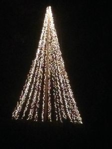

We plugged them in and HUZZA, a tree.
Done!!!
