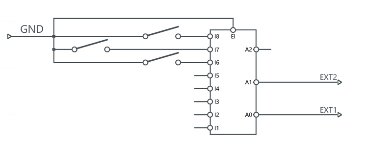

Step 5: Expanding Number of Inputs *optional
I wanted to use 74148 for this, but since I don't have it. I've used its Russian analog - K155IV1.
It will work as follows:
1) If no button pressed, there's a high level on both outputs;
2) If the button attached to the I6 is pressed, there's a high level on A1 and a low level on A0;
3) If the button attached to the I7 is pressed, there's a low level on A1 and a high level on A0;
4) If the button attached to the I8 is pressed, there's a low level on both A0 and A1.

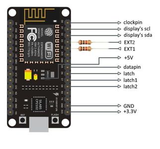

Step 6: Expanding Number of Outputs (Hardware)

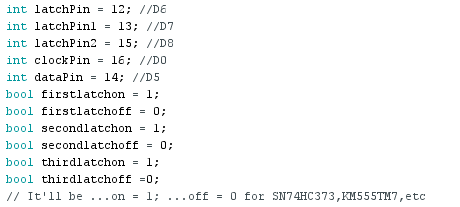

Since ESP8266 only has nine digital ports. And four of them are already used by the buttons and display. There are only five ports left. To expand those five ports to twenty-four outputs. It will be rational to use one 8-bit shift register and three 8-bit registers.
The whole thing is made of D-type bistables. That means that if you don't have some components, you can make them yourself. An 8-bit shift register can be built from eight flip-flops. An 8-bit register can be built either from eight latches or from eight flip-flops.

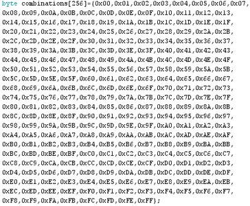

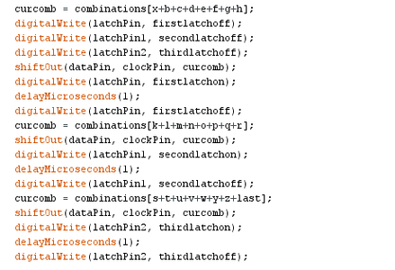

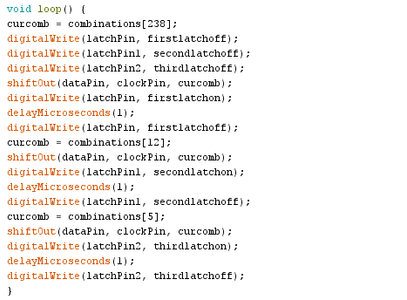

Step 7: Expanding the Number of Outputs (Software)
There's an array that has all possible combinations. To output a combination, the number of an array's element should be passed to the "shiftOut" function. After the function has done its job it's time to send "1" to the latch of the first register and write whatever was on the outputs of the shift register into the first register. Then send "0" to the latch of the first register, send another value to the function "shiftOut" and write the value that was given to the shift register by the "shiftOut" function into the second register by sending "1" to its latch (latchPin1), etc.

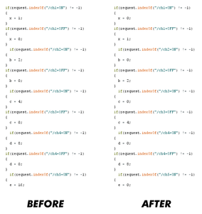

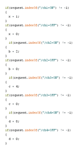

Step 8: Turning Channels on and Off
When the button is pressed, a certain value is assigned to the variable (0,1,2,4,8,16, etc). Later on, the sum of the values of eight variables is matched with a corresponding element in the array. This element is feed to the "shiftOut" function.

Step 12: Connect the Display
Connect:
display's GND to ESP's GND
display's VCC to ESP's 3V
display's SCL to ESP's D1
display's SDA to ESP's D2

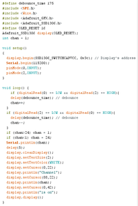

Step 17: Manual Mode *optional
In case you don't have Wi-Fi, you can still use this device. To do this, build this extension. You now will be able to use this device without Wi-Fi.
