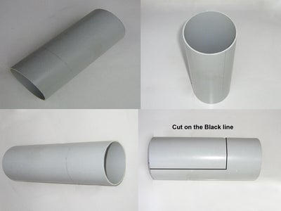

Take a PVC pipe and cut it to your required length, the Diameter of the pipe should be big enough to fit in the Transformer.
Step 2: PVC Pipe

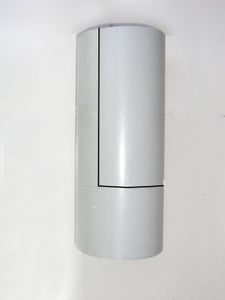

Cut the PVC pipe from the top leaving about 4 inches from the bottom
to place the Transformer, as shown in the diagram. Fix hinges on the top of the cut
out portion so that it opens and closes as per your need.

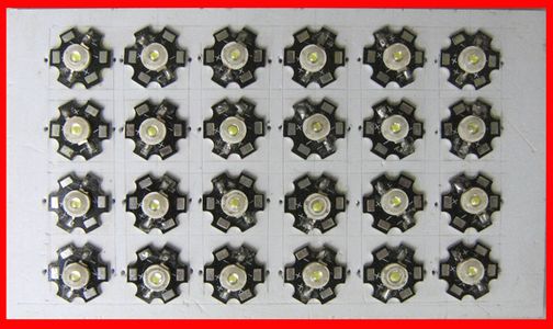

Now take a flat PVC sheet and cut it to the required size to fix the LED’s on to it.
Fix Four rows of 6 LED’s with Dendrite so that the LED’s stick to the PVC sheet.
Make small holes on the sheet to connect the LED’s with wire.

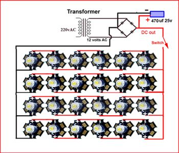

Step 4: The Circuit.
Follow the Circuit and solder the LED’s and connect it to the output of the Transformer.
Place the switch where ever you want.

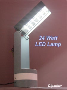

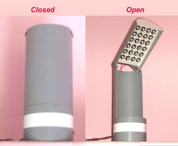

Step 6: The Lamp.
Here you can see the Closed and Open positions of the Lamp.
Now your light is ready, Plug in, switch on and Enjoy….
