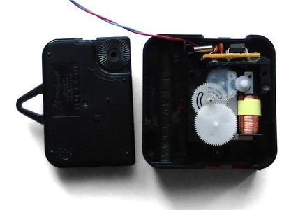

If you don't want to buy a 24-hour movement, you can make your own from a standard clock motor. My Astronomical Clock instructable explains at length how to modify a clock motor so I'll just give a short description here.
You should be able to buy a junk clock for £0.50 in a car-boot sale.
Remove the hands from the motor. Open the motor and take out the gears and the rotor. Extract the coil and the small PCB. The battery contacts should come out as well.
Unsolder the coil wires from the PCB. Unsolder and keep the 32768Hz crystal.

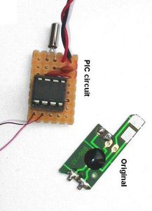

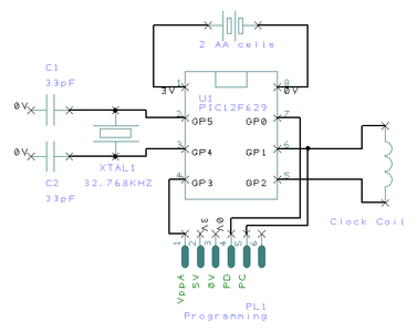

We want to make the clock run at a different speed so we need a circuit that will produce the pulses at the right rate. In this application, the motor should run at half speed so the pulses should be every two seconds. A microprocessor circuit will do the job. We want the microprocessor to run for a year on two AA cells so the current has to be 100uA or less.
I chose a PIC 12F629. I happen to have quite a few of them but any of the small PICs would do instead - they might not even need changes to the code.
The PIC circuit is shown above.
The PIC processor runs using its 4MHz internal oscillator but spends most of its time asleep. Timer1 uses an external oscillator: the 32768Hz we unsoldered crystal from the clock motor. Whenever Timer1 overflows (every 2 seconds), the PIC wakes up and calls an interrupt. The interrupt produces a pulse in the motor coil then returns to the "main program". The main program goes back to sleep.
The total average power consumption when it's driving the clock coil is around 50uA. It needs two AA cells and they'll last a year. Great!
The Timer1 oscillator is "low power" - it drives the crystal with a low current. Clock crystals need a lower current drive than you would normally use on, say, a processor crystal. I tried the PIC circuit with a few 32kHz crystals and they all worked fine with 33pF capacitors.
I've attached the hex and the assembler for the PIC code I used.
I built the PIC circuit on a small piece of stripboard. It fits where the old PCB used to go or you could fit it where the AA cell used to go in the clock motor.

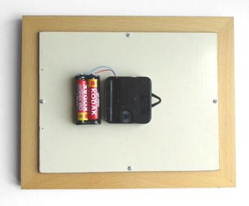

Step 4: Construction
I printed the map as an 8"x6" photo and found an 8"x6" photo frame in a charity shop for £1. 7"x5" frames are easier to find but I thought they were rather small.
Draw a large + on the back of the map so you can line it up later then carefully cut out the space around the equator. Glue the number disk onto thin card to stiffen it then cut carefully around it.
You could glue the map onto the inside of the glass using clear glue such as UHU. I thought it was better to glue stiff "celluloid" from packaging on the back of the map photo to centre the "Northern hemisphere" inside the "Southern hemisphere".
The number disk needs to be fixed onto the hour shaft. You might work out your own way to do it. I used three squares of 1mm polystyrene sheet. I carefully drilled and filed holes in the pieces so they were a tight fit on the shaft (it's tapered) then glued them together. Then I glued the squares onto the back of the number disk while carefully supporting it to ensure it was completely flat. To reduce friction, I glued small pieces of thick card at the edges of the disk to keep the disk slightly away from the back of the map.
The details of how you attach your clock motor will depend on your particular picture frame. I cut a piece of hardboard that could be screwed onto the back of the frame, drilled a hole in it and glued the clock motor and battery holder onto the back.
