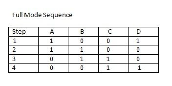

If you have read a basic description about stepper motors.. they just work on by switching the coils on off on off one by one or more than one at a time which create a magnetic field that let the metallic part to rotate, so the sequence is like if we have 4 coils .. how we will trigger them at a time.. so this info shall come in product description or just GOOGLE it.. (in the uploaded pics there are two types of sequences) ,.... any way.
So this 28BYJ-48 sequence is gonna be like
1000, 1100, 0100, 0110, 0010, 0011, 0001, 1001 at a time to cause a step
since arduino library could make our stepper not to rotate because of difference in sequences that is the reason of one direction :D
