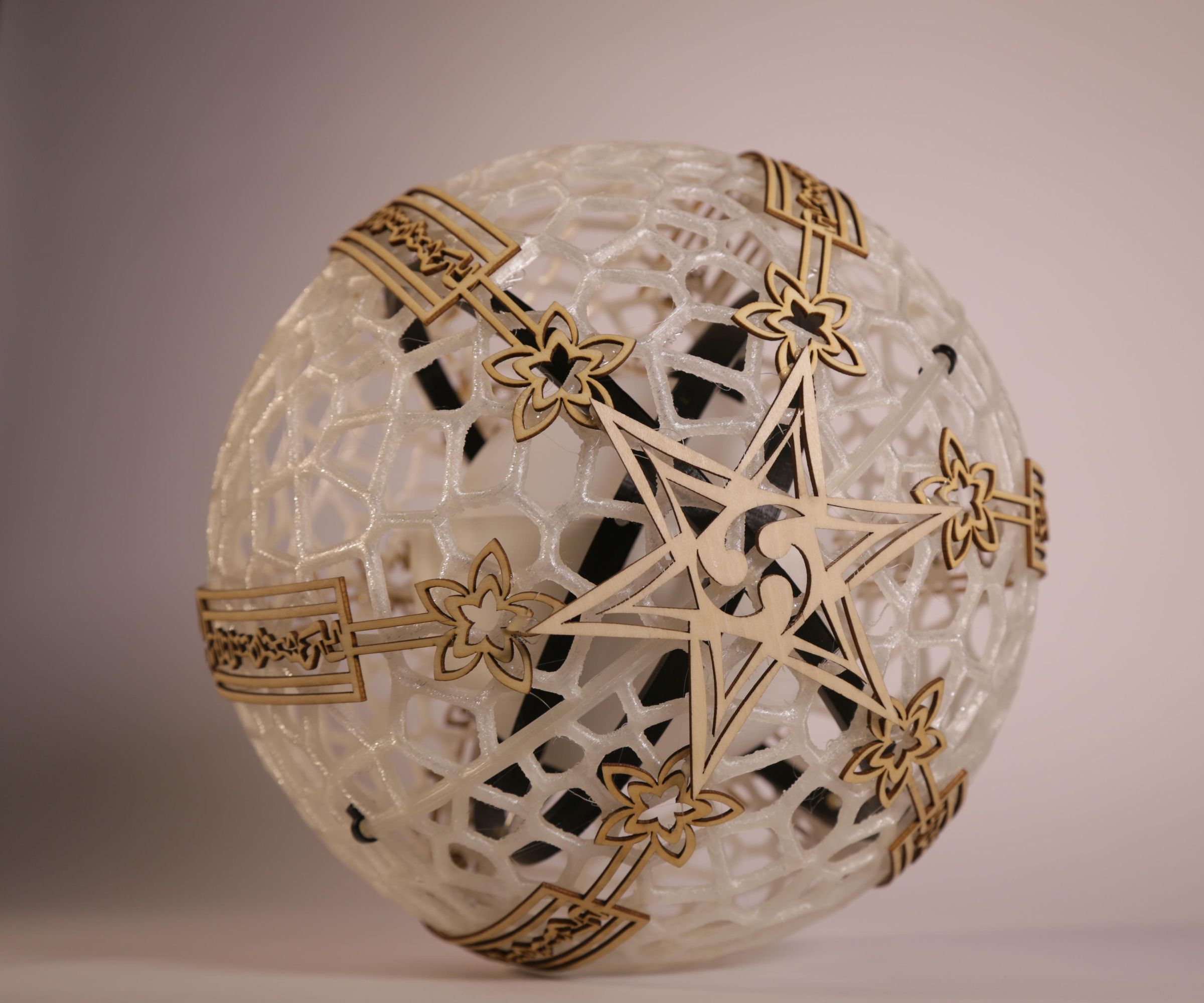

Step 4: Final Products
We got no time left, so we connect our modules together and also hang the acrylic bars on it (the first one in the pictures), and with some plywood strings that does not have gaps in the middle, we bend them and connect them into weird but very gene-like product(the second one). By keep adding the modules, this item could develop even bigger.
