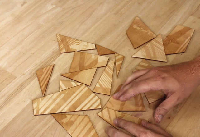

Introduction: 2D Puzzle
In this lesson, we'll learn how to make custom laser cut objects using Adobe Illustrator. We'll make a 2D puzzle and learn how to draw, cut, and etch a laser cut design.

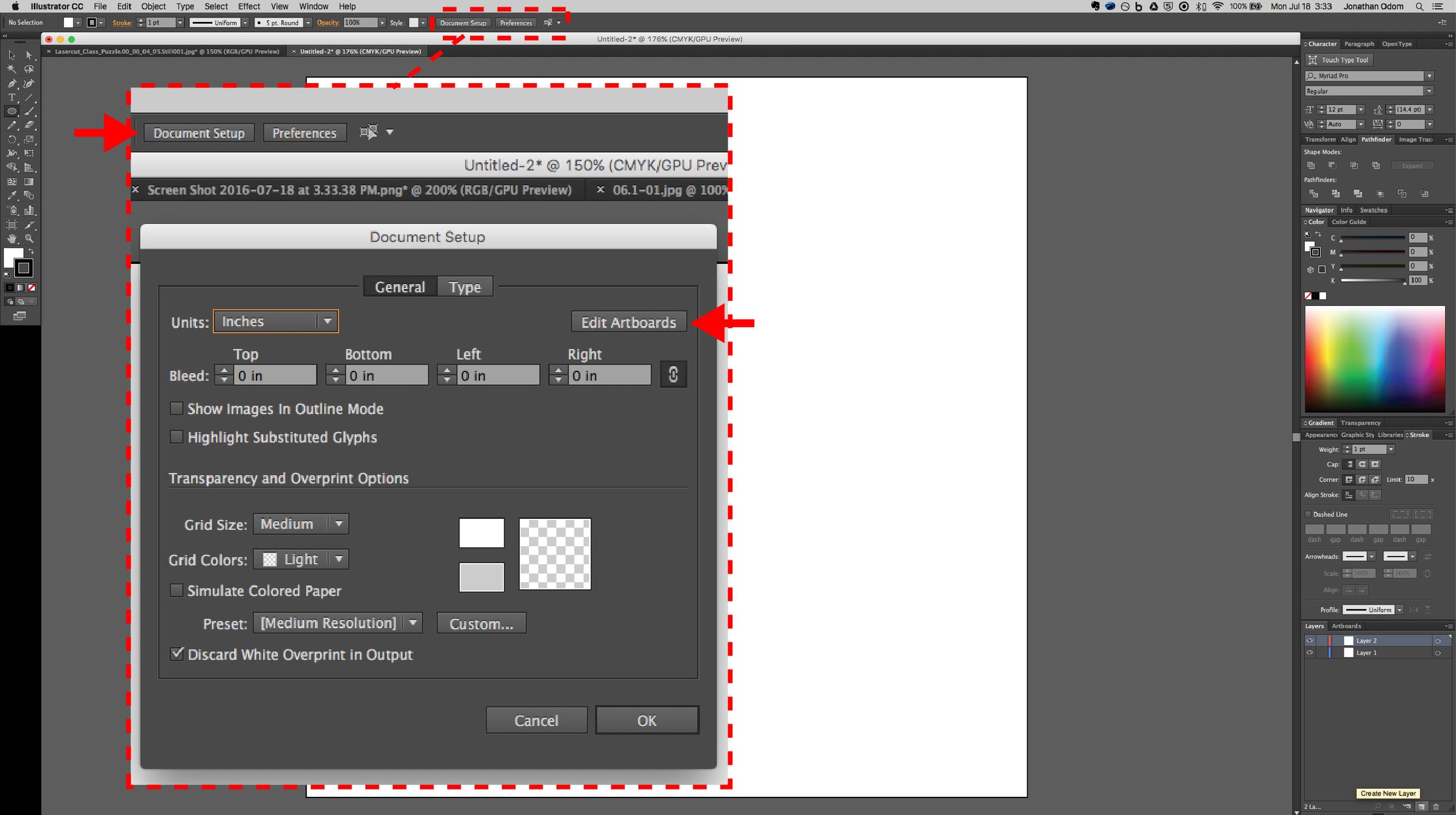

Step 1: Set Up Illustrator File

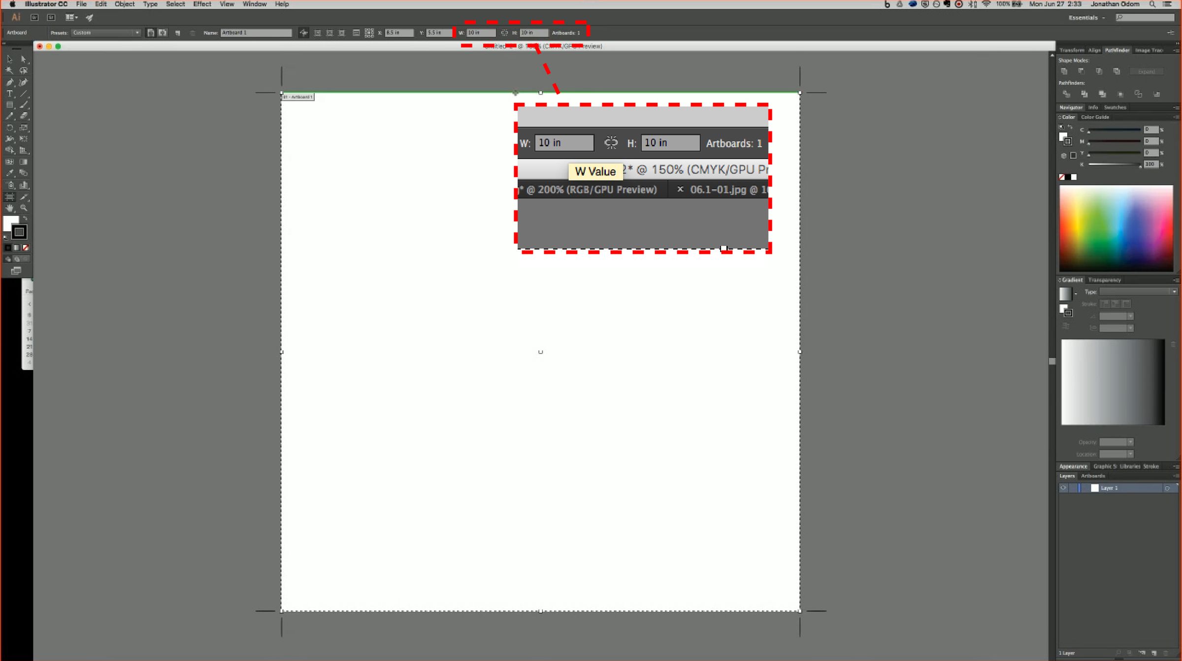

Let's start by opening Adobe Illustrator and making a new file. As long as the canvas size is less than or equal to 36" X 24" (the size of the laser cutter bed), our design will work just fine. Click on Document Setup, then Edit Artboards and change the canvas size to 10" W X 10" H.
Document Setup > Edit Artboards
W: 10 X H: 10

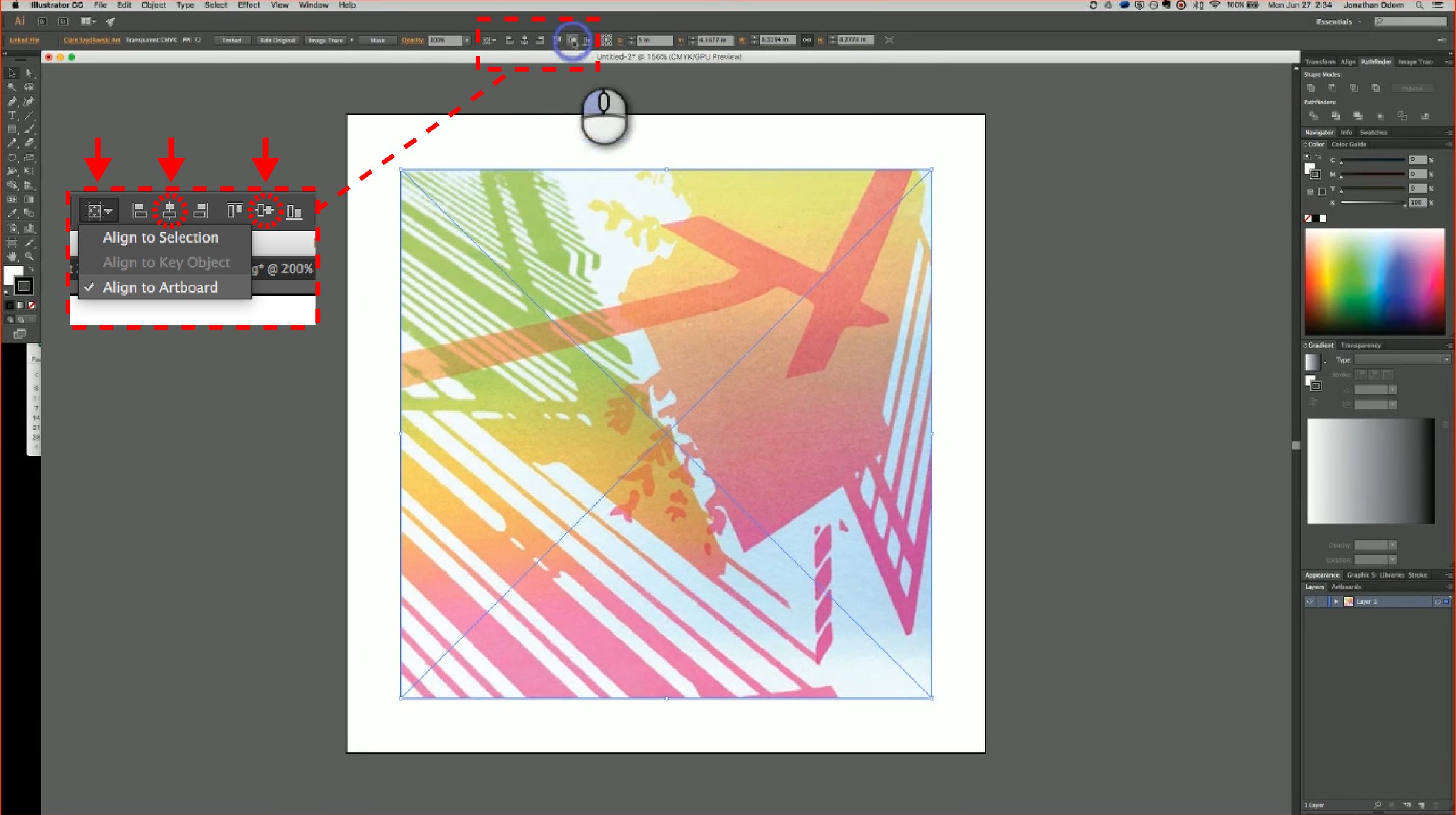

The jpeg comes into the file at actual size, so you'll need to scale it to fit the size of my puzzle. With the image selected (using the default Selection tool), click the Align icon on the Control Bar at the top of the screen and select Align to Artboard. Then click the Horizontal Align Center and Vertical Align Center icons to center the artwork.
Align image to Artboard

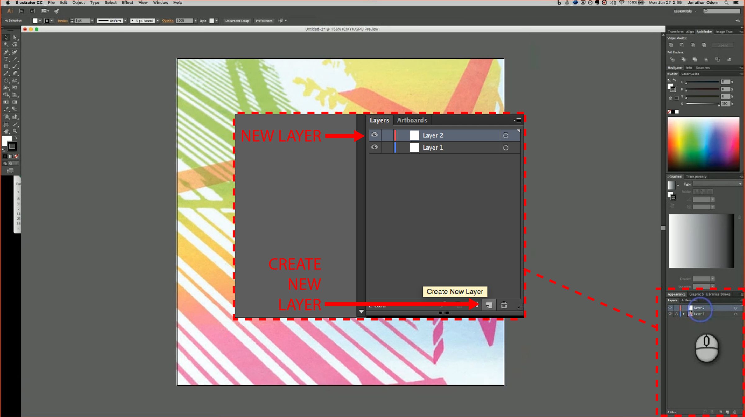

Step 3: Draw Cut Lines
Now that your artwork fills the artboard, it's time to start drawing the cut lines. Go to the Layers panel and click the Create New Layer icon, then click the Lock icon for the layer with the artwork on it. This will prevent accidentally moving the artwork.
Create New Layer

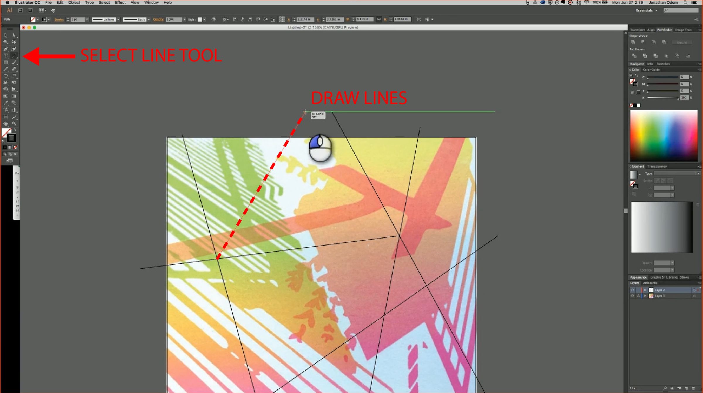

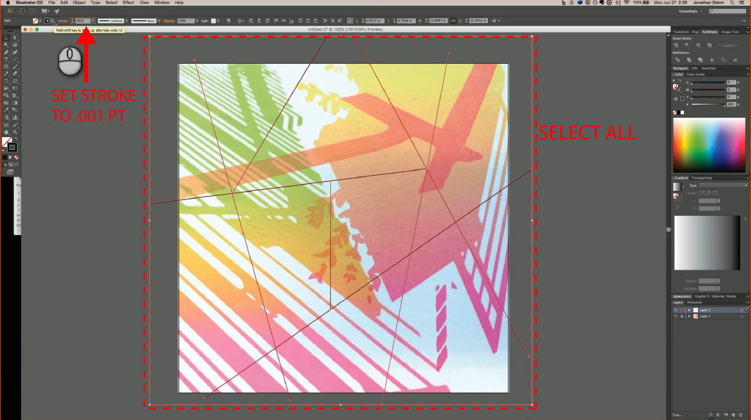

Select the new layer, then click the Line Tool icon and start drawing your cut lines. Illustrator has a lot of sophisticated drawing options that allow you to make any shape you can imagine, but for this class, we're sticking to the basics. I'd encourage you to play around with the drawing tools on your own and learn how to make new kinds of shapes.
Draw lines on new layer
With my cut lines finished, select them all and change the Stroke Weight to .001 pt. This is the line weight that the laser cutter recognizes as "cut".
Change stroke weight to .001pt

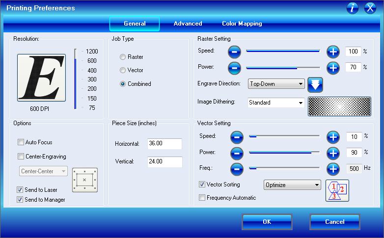

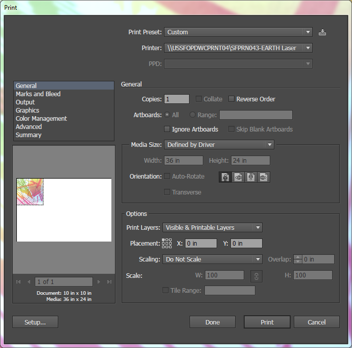

To cut and etch the puzzle, go back to the Print Dialog and place the file in the upper left corner of the media again. This layout shows the bed in landscape orientation, but the result will be the same as it was with the portrait orientation we saw for the tissue box project.
Print Dialog
This project will use both cutting and etching, so the Job Type must be set to Combined. The Vector Setting remains the same as it was for the tissue box since we're cutting 1/8" plywood again. The Raster Setting is set to Speed: 100% and Power: 70% as recommended in the Epilog Settings PDF provided in the previous lesson.
Epilog Printing Preferences

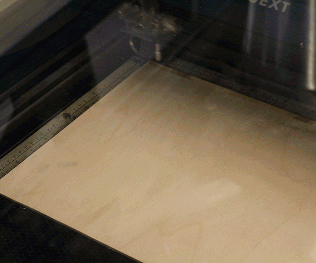

Step 5: Etch and Cut

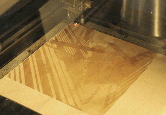

The Combined cut / etch setting runs each operation in turn. It starts with etching automatically, which is great because there's less chance of distortion since there is only one uniform surface to etch on.
Etching is time-consuming because the head burns the surface of the material one-line-at-a-time, just like an inkjet printer. The Valueof the image corresponds to the depth of the etching: darker parts of the image etch deeper, and lighter parts are shallower. Black will etch the maximum depth according to the speed / power of the settings, and white will not etch at all.
Sometimes it's helpful to use grayscale images for etching because it's easier to see what it will look like once it's etched.
Etch

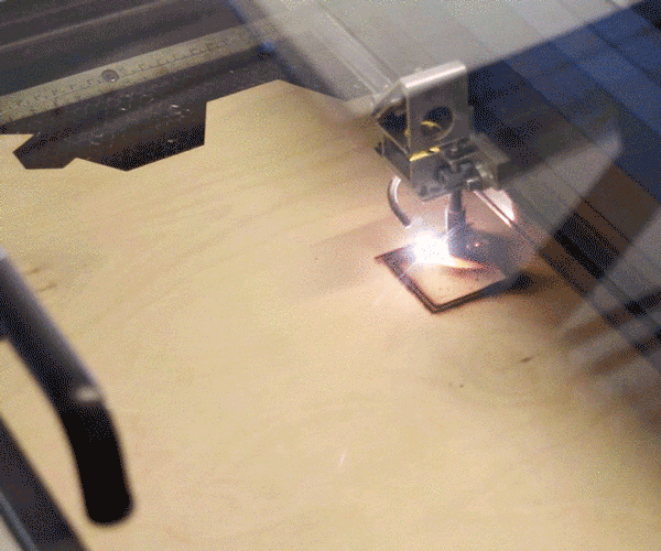

With the etching done, the machine runs the cutting operation as seen in the GIF below. I'm not using masking tape on the top of the material because that would probably ruin the etching, so there will be a small amount of soot on the top surface.
Cut
