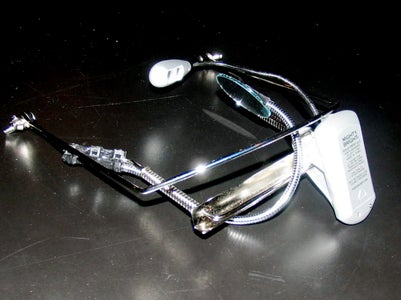

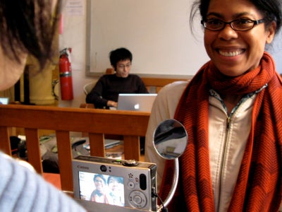

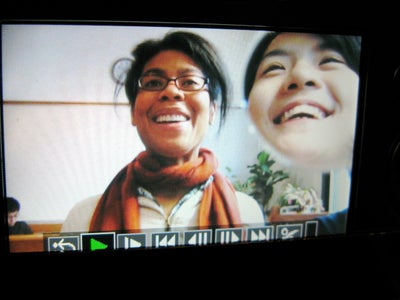

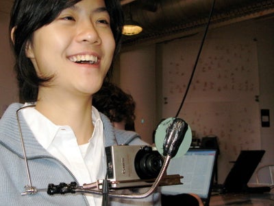

An interview camera rig designed to enable an interviewer with 1 small digital camera to capture picture in picture interviews with good audio on both subjects without a camera-person. Made with a harmonica holder, Canon SD1000 camera, small mirror, quick-ties, Shoe Goo and flex pipe. The rig captures narrative efficiently by both interviewer and interviewee without two cameras or post-production. Audio is mostly balanced due to interviewee speaking into the camer's mic and further away, while the interviewer speaks behind the mic, but is closer. Presence and awareness of both interview and interviewee is more viceral while it focuses appropriately on the interviewee. Further development could include fill and subject battery powered LED lights, and exploring square mirrors.

Camera. Any small point and shoot with good video and audio capability that will fit in a harmonica holder and has a front mounted mic. I found the Canon SD1000 to fit well with the Lee Oskar holder and be a great video camera with wide focus and a front mounted mic. The mic placement means the interviewee is talking directly into the mic and the interviewer is talking above it, but is closer, This seems to balance out the audio volume.

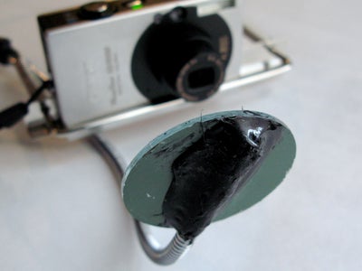

Mirror. Any small non-magnified round or square mirror about 2 inches in diameter. If there's no edging on the mirror, just a glass edge, it creates a nice blurry line in the video that makes it seem almost like the picture in picture was done in post production. Some people liked square mirrors more because they looked like picture in picture on a TV. I like round because it fits faces better.

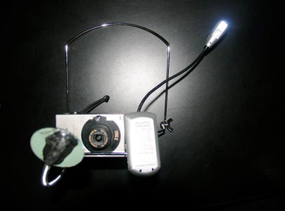

Optional: LED Fill light
This light has two settings and clips onto the rig as a fill light. You can white balance to get rid o the blue tint:
Mighty Bright Xtra Flex 2 LED Book Light, Silver:
http://www.amazon.com/Xtra-Flex-Book-Light-Silver/dp/B000OOSDTW/ref=sr_1_1?ie=UTF8&s=home-garden&qid=1196876720&sr=8-1

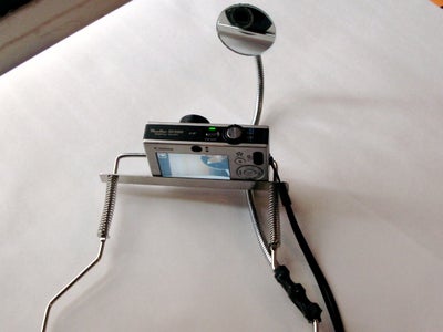

Step 2: Making

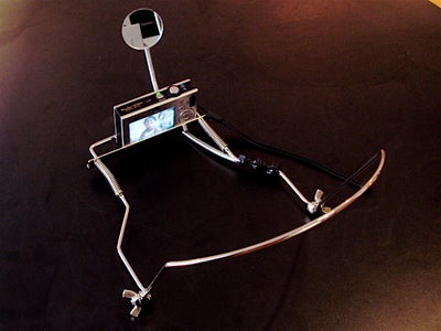

It's pretty simple.

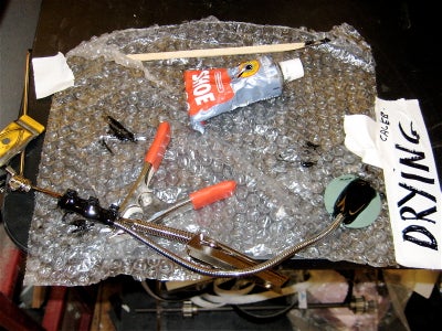

Get your 11 to 12" of flex pipe, mirror, Shoe Goo and cable ties.
Test the mirror by clipping camera to harmonica holder and using your fingers to hold the mirror.

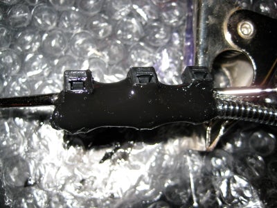

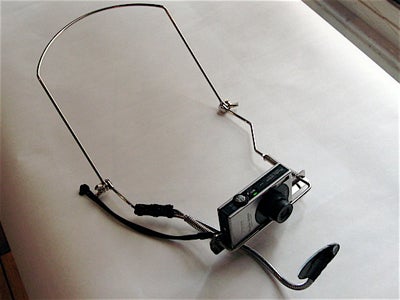

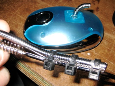

Cable tie flex pipe to harmonica holder on the angled part nearest the holder's spring. Use two pliers to pull the cable ties as tight as you can.

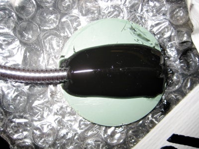

Clamp rig in a position that lets you Shoe Goo the cable ties on one side and Shoe Goo the mirror in place so the flex pipe is in tight contact with the mirror.
Drop Shoe Goo on cable ties and back of mirror liberally. Shape before it sets.
Let dry for a good 24 hours
Shoe Goo other side of cable ties and let dry for another 24 hours
Interview!
