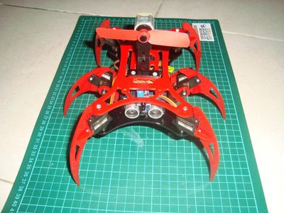

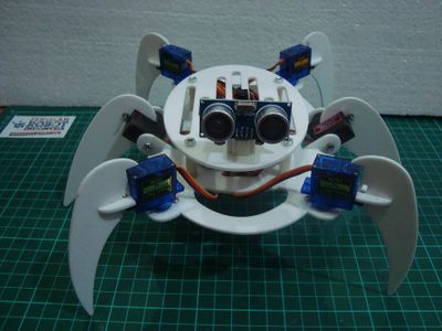

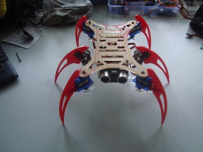

This is a mini O-fat the quadruped robot, frame made from 2mm Acrylic cut with laser cutter.
Mini O-fat is 2dof quadruped legged robot, consists of 8 metal gear micro servo, 2 servo in each foot, for this tutorial I am going to make an avoider robot using ultrasonic sensors. for the future you can upgrade any into robots as desired, could be a robot fire fighting and other.

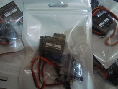

2. 8 micro servo metal gear, use a micro servo type SG90 will mate for this frame

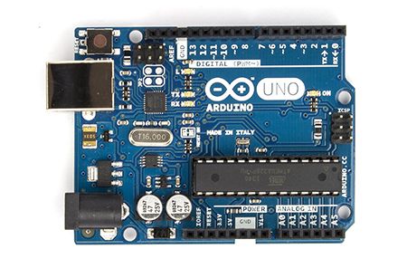

3. Arduino Uno.

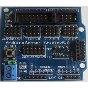

4. Arduino Sensor shield

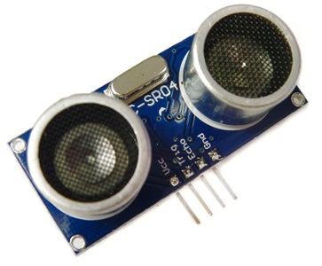

5. Ultrasonic sensor, you can use HC-SR04 with jumper wire

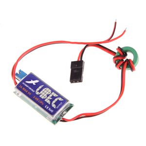

6. Ubec 5V 3A-5A

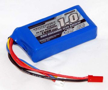

7. 2 cell 1000mAh lipo battery, or you can use 3 cell 100mAh lipo, but 2 cell more better because it more lighter, and 1000mah for small dimention because the robot is mini.

Step 2: Assemble the Frame of the Robot
First we raft body section, see the image fine, search forms part of the frame as in the picture, prepare nut and bolt the small M3, M2 and super strong glue.
Body:
Search part acrilyc as in picture 1 and attach Nut M3 on already provided, attach with bolt on a cell cover robots like in Figure 2-3, and acttach to base body as in picture 4, if the part mate take out from the base body frame, in other side (down side) in base body attact the little part like as picture 5-6 on second hold for lock with the cell part, look for the result in picture 7-8.
Up Leg :
prepare a parts as in the picture 9 look carefully there are 2 same part with different size hole, acttack little part join look the picture 10 carefully the hole on join part must be be like the picture.and attack up leg frame in other side pic.11. now build for part join to down leg look a picture 12. attact the block part to up leg in to the hole look the picture 13, attack the other part in mate place. For join with down leg attact the servo Horn to side join with large hole same size with the circle of servo hole pic.15 , add some glue on the joint area of acrilyc and to horn servo do it the same thing for 4 up leg part.
Down Leg :
Pic. 17 prepare the part, and like Up leg part attact the little join part on the midle down leg. do it for 4 down leg, the result look the last picture in this step.

Prepare 8 micro servo Sg 90 metal gear for first servo attact on top the up leg frame, look pic.5 add screw for join servo and frame Pic.6. for the Next servo attact on the join frame for down leg part the horn is already installed before add a screw on the hole shaf servo pic 9-10. and than attact the down leg part to the second servo and screw it. pic 11-12. do it the same thing for other leg.

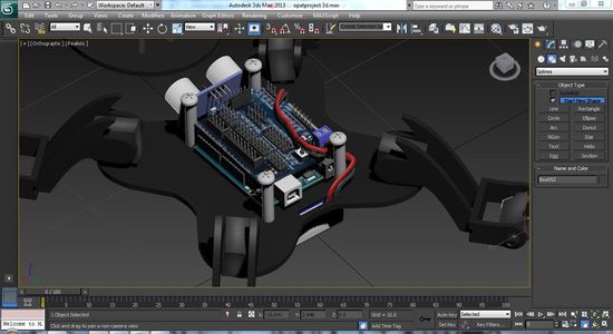

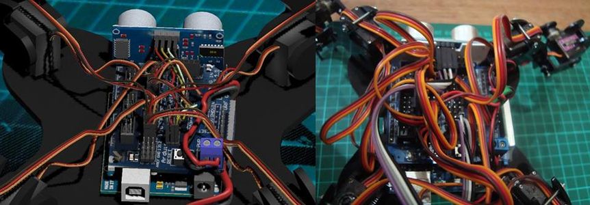

Prepare the arduino Uno, sensor shield, ultrasonic sensor and the jumper wire for sensor. put the arduino uno on the midle of body robot in the body is aready screw hole same size and position with arduino uno board screw it, than attact the sensor shield arduino on the top arduino uno, make sure the all pin is conected, the attact the 4pieces feame t0 female jumper wire red foe vcc pin sensor black for ground white for echo and yellow for triger. use a hot glue for placed the ultrasonic sensor on the midle front of robot the sensor fungtion as eyes.

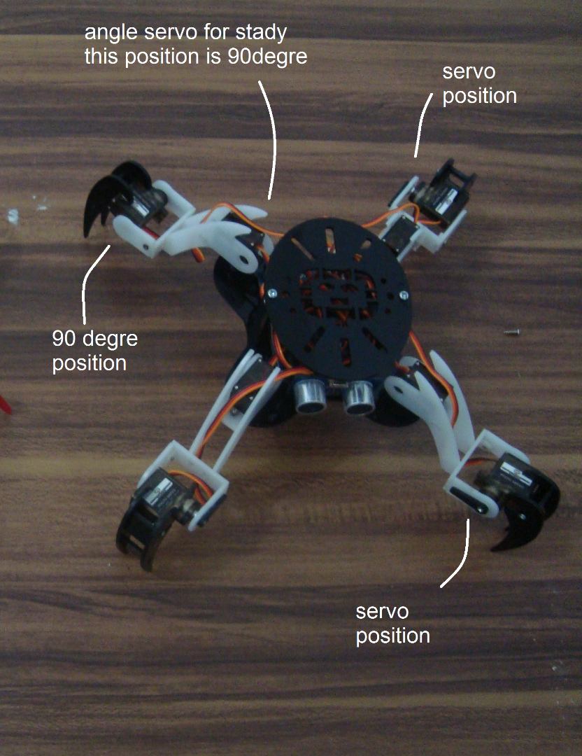

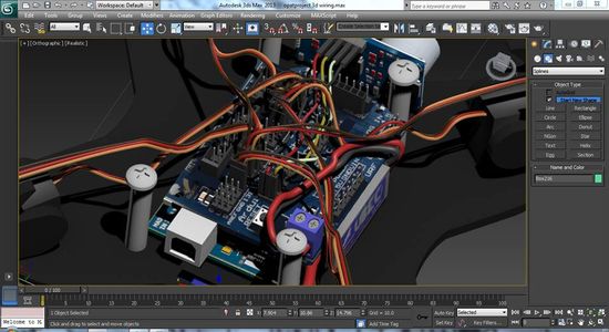

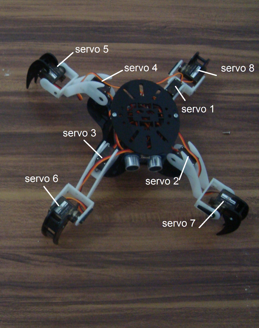

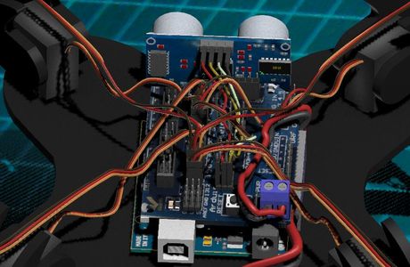

Frame and mechanism is aready now for wiring forfirs you must connect the servo pin to the input pin arduino sersor shield , for first look Pic1 carefully, remember the servo position, and this a list where the servo connected
1. Servo 1 to Pin 2
2. Servo 2 to Pin 3
3. Servo 3 to Pin 4
4. Servo 4 to Pin 5
5. Servo 5 to Pin 12
6. Servo 6 to Pin 11
7. Servo 7 to Pin 10
8. Servo 8 to Pin 9
9. Triger Ultrasonic sensor to Pin A0
10.Echo Ultrasonic sensor to Pin A1
Make sure you connect the pin to the right position Red for vcc, black or brown to the Gnd yellow or white for data.

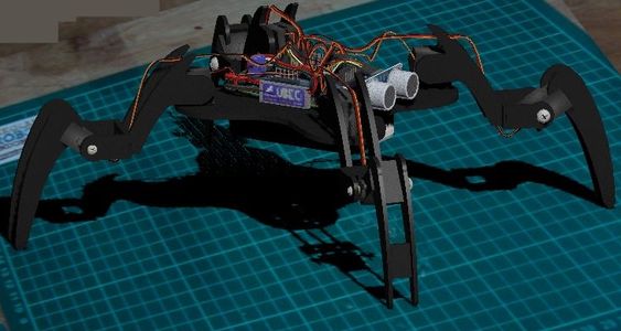

Next you must attact the Ubec protector power system, connect the output pin Ubec to the power pin on servo shield, Red for Vcc black for Gnd.

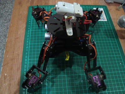

Last step connect the arduino to the computer with USB camle, download the .ino file is aready attact in thes step. open the arduino.ide open the file program and upload to the board.

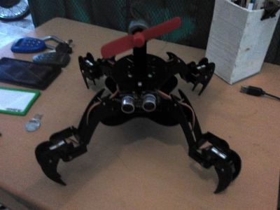

in fact this program for my 3dof quadruped robot, but it's not a problem for robot 2dof could use a 1 and 3, while 2 are ignored for 2dof robot.
Your Robot now is aready to action, he wallk and avoider from the obstacle. connect the input ubec to the lipo battery put the battery under the body of the robot.
