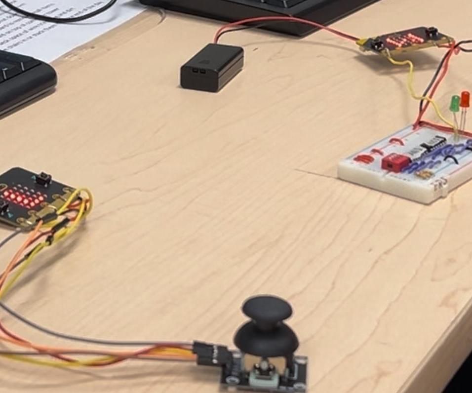

In this project, we will be creating a 3 by 3 bit binary multiplier using logic gates and arduino microcontroller. This circuit is able to multiply 2, 3 bit binary numbers together and display the output. The entire circuit on its own is about 30 total gates, 9 individual gates, 3 half adders and 3 full adders. This requires 8 chips to drive which does not fit on a standard breadboard. To work around this, this circuit has the full adders logic be performed by the arduino which takes 3 inputs and sends out 2 outputs per full adder. The output is displayed across 6 led's which represent the binary output (a 0 or a 1 depending on whether the led is on)

As previously stated, the logic portion of the circuit related to the 3 full adders is controlled entirely through arduino meaning we connect pins for digital read and digital write purposes to our existing logic in order to simulate the logic of a physical full adder. Follow the connections as shown in the image above. The 3 full adders use a total of 13 pins meaning all digital pins expect 1 will be used for this step
