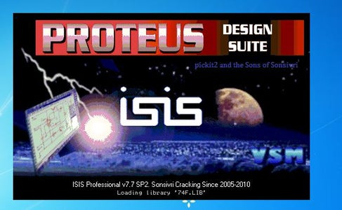

==> First we need to have Proteus V7 Software with installed libraries.
==> Then Open the suit and start your design.

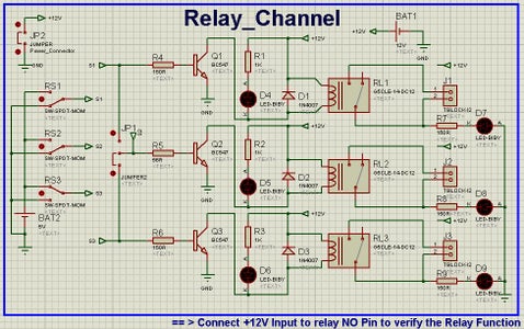

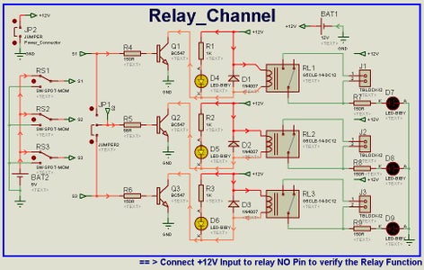

Step 4: Design Schematics and Circuit Connection.
Designing the circuits and Schematics is the complicated procedure in this but this is only way to make it happen.
We all know that Schematic is the only file which Enable us to start our PCB Design. So we need to learn how to do this circuit and designs as well.
The Schematic is clearly given in all 3 Images, refer any one which you feel best.
One of the Image shows How this circuit is going to work on real time, Which you can also do it in Proteus V7. But need to go through few procedures about it.

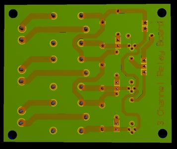

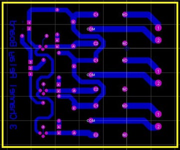

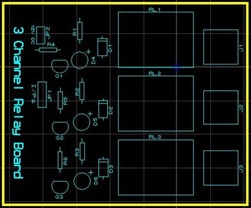

Step 6: PCB Design and Track Design.
Look at the diagrams and try to make the PCB as shown, Its quite difficult for the first time. This may take a most of you time , but worth of doing this.
Please follow the IPC standards for PCB designs if your going with mass production, else just for prototyping and etching it is OK.
I uploaded bottom, Top and Silk layer designs, Please look at them.
If you done with this, Then Check with Pre Production Check Visible in Output.
If everything is OK, Then you done with your PCBs, Export it how you want and do next work.

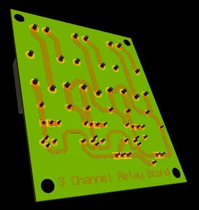

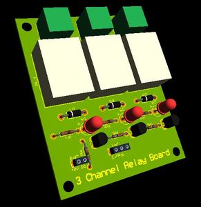

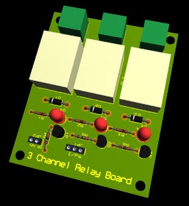

Step 7: Final Look.
This is how it looks, If you want you can see this using Output --> 3D Visualization.
This is what i did, Even smart you can do it, But need to check with size and PCB packages.
