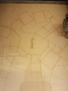

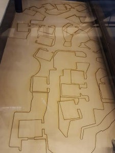

Step 4: Laser-Cutting
On a visit to San Francisco, I booked a day at Pier 9 to use their Epilog Laser Cutters. Having taken the training course a couple years earlier, I took a brief refresher with one of the instructors, who helped me determine that the best workflow was to save each "contour template" separately, with red lines for engraving linework and green lines for profile cuts. We then brought each file into Adobe Illustrator, made minor modifications to lineweights, and sent each "contour template" to the laser cutter. Pieces like floor plates that had linework engraved had to be sent in two passes: once for the linework, and a second time for the profile cuts.
The Epilog machines could handle 1/4" plywood pieces 2'-0" x 3'-0", which means I could fit between 2 and 3 contour templates on a sheet. In all, I used 26 sheets of plywood with about 1/3 of it as "off-cuts" for recycling/re-use.
Laser-cutting was s-l-o-w, and it took about 12 hours of cutting (feeding plywood, modifying and sending data, watching the machine cut, and carefully removing cut pieces, some of which were pretty fragile), which made for a pretty long day on my feet! Watching a laser cutter in action is a bit like watching grass grow, but the risk of a fire is too great to leave it unattended, so it's really time you have to put in when laser-cutting plywood.
At the end of the day, I had over 500 pieces of plywood to stack and arrange, but even "dry fit" the pieces began to take shape, and the scale of the entire dungeon became apparent: at 36" x 42" it is huge!

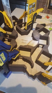

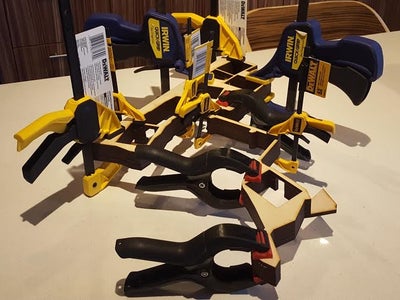

Step 6: Gluing the Laminations
Once the pieces arrived at home, it was time to glue them. I used "Titebond" wood glue with a foam brush (both readily available from the local home improvement store), and glued and clamped, and glued and clamped, and glued and clamped...
...until after several days, all of the floor plates and all of the wall sections were assembled into thick "chunks" of wood, built out of several laminations each.

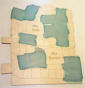

Step 7: Painting the Rooms
Once the gluing was complete, the pieces stacked up into a handsome monochrome, mono-material model, not unlike the earlier VR model in my walkthrough. It was actually two colors, with the sides of each contour (every wall and stair) a dark "burnt" brown and the top surface of each a blonde "plywood" color. This wasn't bad, but since the original game board was so brightly color-coded to indicate each level of the dungeon, I decided to color the rooms as well before gluing the walls onto the floor plates.
To do this, I used cheap watercolor paints readily available in any craft/art store. For the first (top) dungeon level, I used a yellow wash. Second was orange, third was red (rose), fourth purple, fifth blue, and sixth green, just like the original gameboard coloring. I also tried to increase the value (darkness) of each level color, so the coloration got darker the lower you got into the dungeon (from pale yellow to dark green).
I masked each room to keep paint pigment off the door thresholds and corridors. Unfortunately, the painter's tape did a poor job of masking watercolor wash on fresh plywood, so in some spots the colors bled across the threshold. I'm not thrilled with this development, but the color bleed is minor overall, and does add to the "hand crafted" aesthetic of the model.

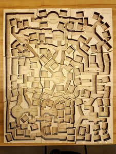

Step 10: Final Game Board, Ready for Play
Once all the pieces were glued and dried, it was time for a final fit. The tight fit of the laser-cut pieces, combined with a little hand-assembled construction tolerance, meant a few pieces rubbed and squeaked as they snapped into place. I've since taken a file to a few select areas to ease the fit, and of course rubbed in a bit of stain in the places I've filed to restore a dark finish to the vertical surfaces I filed down.
Here you can see the dungeon completely assembled and ready for play. The "monster" and "treasure cards" drop in quite easily, and I expect it will enhance the game play tremendously.
