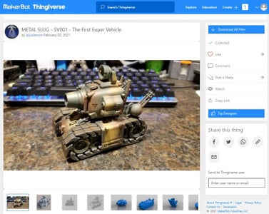

I chose the tank because it was a fairly basic shape that, even if there were errors, I could do something with. Plus it's Metal Slug, and I like the chunky, greasy, jungle aesthetic.

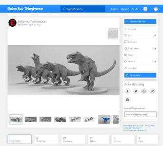

For my starting projects, I downloaded a Tank, some Carnosaurs and Soldiers, all from thingiverse.

The last picture is that carnosaur model from above printed with the refined settings, but I cut time down by about a 3rd by adding another variable that allows for increased speed while printing the supports. (They don't need to be as accurate)
