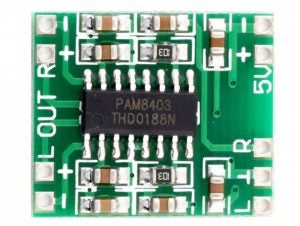

With this connection, your bone conduction earphones are ready…… somewhat. You’ll be able to hear through this but the volume will be negligible. You need to be on a silent place to hear a little.So we need an amplifier in between this to amplify the signal. For that, I have used PAM8403 class D amplifier. It is a stereo amplifier but I have used in mono mode rather than stereo.
After this amplifier, the quality of sound got better. We can actually hear just like our normal earphones.But yeah, the bass was missing in this piezo headphones. But as we are just making a sample project to test bone conduction technology, it’s really good. Volume is so much amplified with this amplifier, that we can hear from a distant through our outer ear also. But put this piezos anywhere touching the skull, close your ears and you’ll be hearing music without ears. Just like MAGIC……….

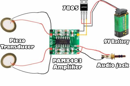

Connections with amplifier circuit are as shown below.
With this connections, you’ll get the amplified output at piezo transducer. This is the final circuit of bone conduction headphones.Not only headphones, this is the circuit for all the three projects – bone conduction headphones, bone conduction speakers. and bone conduction band.
