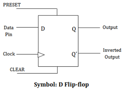

  1. D-Flip Flop ICs

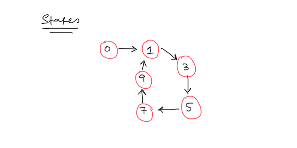

Step 1: States
First of all we will write down all the states for our counter. That is how our odd counter using D-Flip Flops will initiate and continue. To make a 3-digit odd counter we only need to change the 1st digit on ones decimal place to odd number. That is the counter starts from 0 and then goes to 1,3,5,7,9 and then again at 1 not zero i.e. because its an odd counter. Now for the tens and hundreds decimal place we will use simple BCD counter IC to count from 0 to 9, the clock for this IC will come from the odd counter, basically we will cascade 2 BCD counters with the ODD counter.
