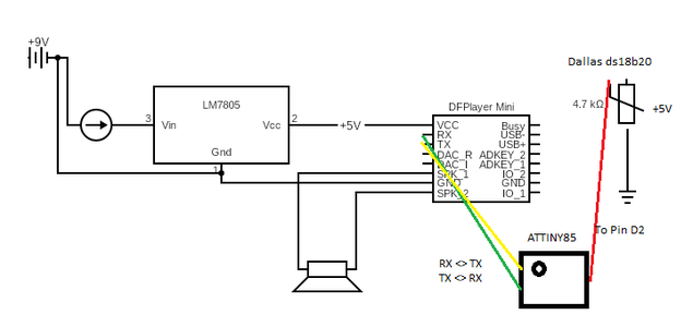

This is a 3 dollar speaking thermometer using an ATTINY85 to read temperature from a a Dallas DBS1820 thermometer and announce it every 30 seconds through a DF Player Mini.
Step 1: Supplies Required
To do this you need to build the circuit shown above
You need
A DFPlayer Mini
ATTINY85
Breadboard and 3.3 volt power supply
A passive speaker ( I used a recycled one from Poundland)
A DBS1820 Dallas thermometer
An SD card, ideally 4 gb or less (FAT32)
Arduino IDE environment and UBASP avr programmer

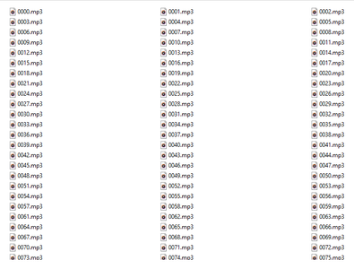

You then need to format an SD card in FAT32 format and add your mp3 files to it. Each MP3 file corresponds to a number but there is an offset of 30 so that 0.mp3 is -30C etc. The files must be numbered 000x.mp3 as shown in the image above.
