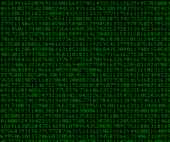

Step 1: Project 1 : Matrix
what is the matrix?
The matrix look's like this
the matrix is falling numbers, the matrix is on the hacker's computers on the movies.
Step 2: Project 1 : Matrix
1. open the notepad
2. write the code
code :
@echo off
color a title cmd :code1 echo loding. timeout /t 1 /nobreak >nul cls echo loding.. timeout /t 1 /nobreak >nul cls echo loding... timeout /t 1 /nobreak >nul cls echo loding. timeout /t 1 /nobreak >nul cls echo loding.. timeout /t 1 /nobreak >nul cls echo loding... timeout /t 1 /nobreak >nul cls echo loding. timeout /t 1 /nobreak >nul cls echo loding.. timeout /t 1 /nobreak >nul cls echo loding... timeout /t 1 /nobreak >nul cls echo loding. timeout /t 1 /nobreak >nul cls echo loding.. timeout /t 1 /nobreak >nul cls echo loding... timeout /t 1 /nobreak >nul cls :start echo %random% %random% %random% %random% %random% %random% %random% %random% %random% %random% %random% %random% %random% %random% goto start
3. save as .cmd
Step 3: Project 1 : Matrix
4. finesh
