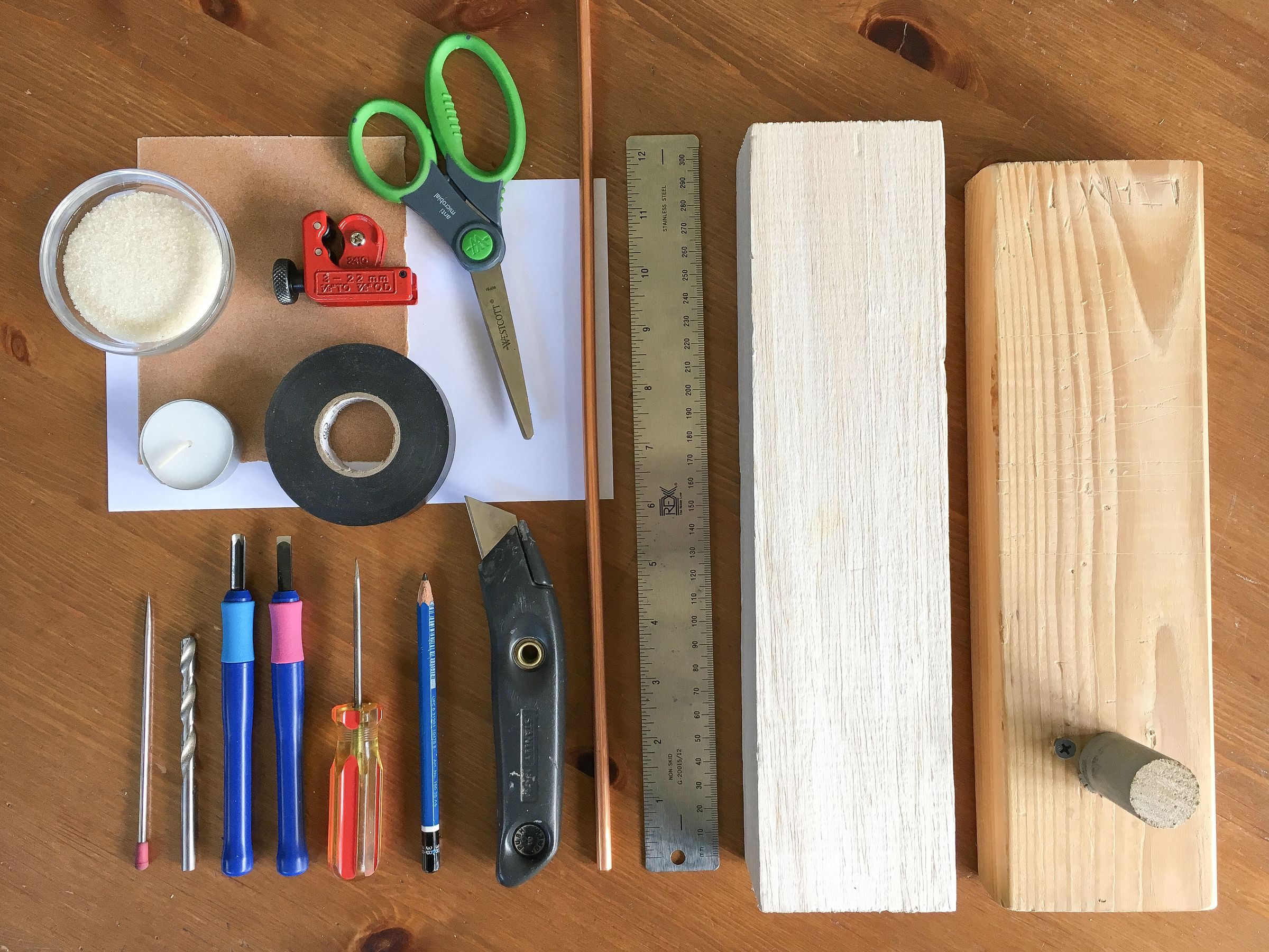

MATERIALS
You will need the following items and tools to create a putt putt boat:
  • Coiling Mechanism (instructions follow)
  • 6x3x1 inch balsa wood block
  • Ruler
  • 18 inch piece of 1/4 inch diameter copper tube
  • Scissors
  • Utility Knife
  • Pencil
  • Small Screwdriver
  • Wood Carving Tools
  • 1/4 inch drill bit
  • Awl
  • One sheet white printer paper - or scrap piece of paper
  • Copper Tube Cutter
  • Tape (I used electrical tape but any will do)
  • Tea Light Candle
  • Fine Grit Sandpaper
  • 2-3 Tablespoons sugar, salt, or sand
  • 1/3 inch diameter Steel Tube (not pictured)
  • Fire Starter (not pictured)

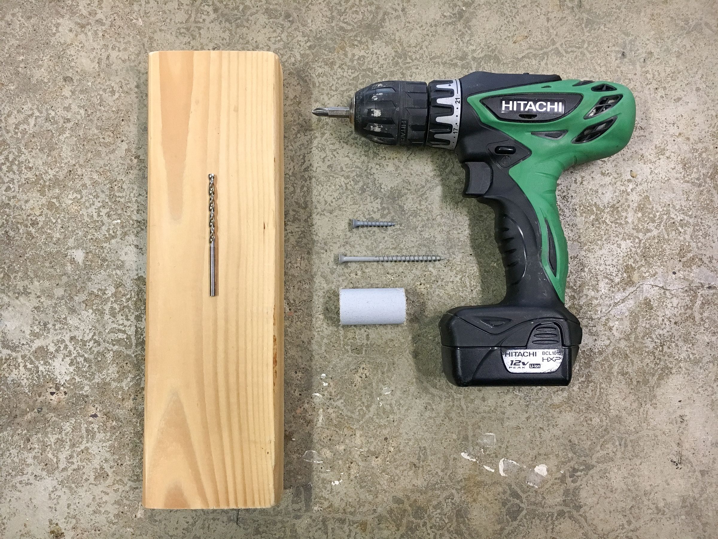

BUILDING THE COILING MECHANISM
Preparation for making putt putt boats with students will require constructing a coiling mechanism. This is a very simple tool that will help make coils that don't collapse or flatten during bending. I recommend doing this first and having it ready before beginning the boats. The process of coiling only takes a few minutes so you only need to make one of these that you could use over and over with multiple students.
You will need the following tools:
  • Drill
  • Drill bit (slightly smaller than screw size)
  • Screwdriver bit

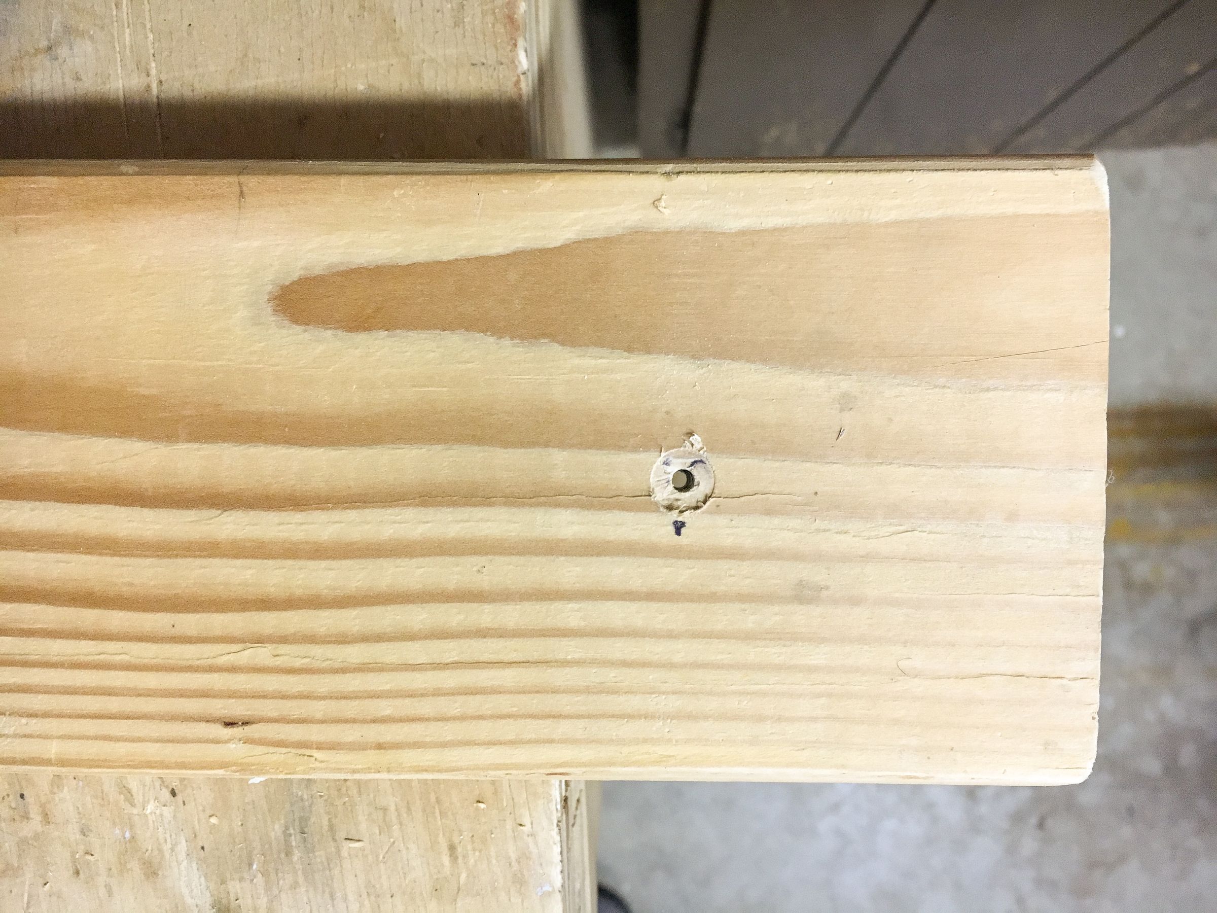

  • 12 inch piece of 2x4
  • 3 inch screw
  • 1 1/2 inch screw
  • 1 inch diameter dowel - approximately 2 inches long

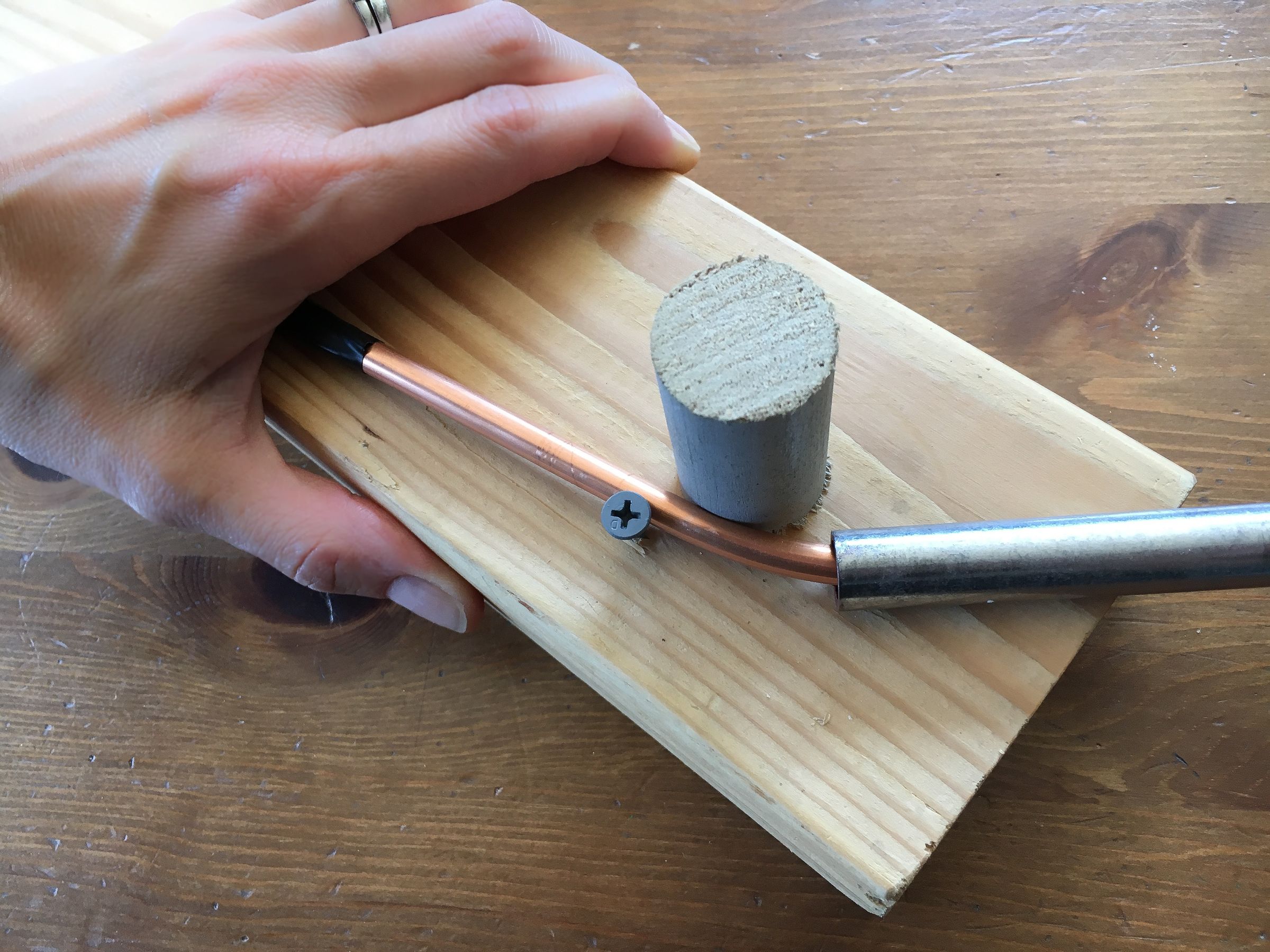

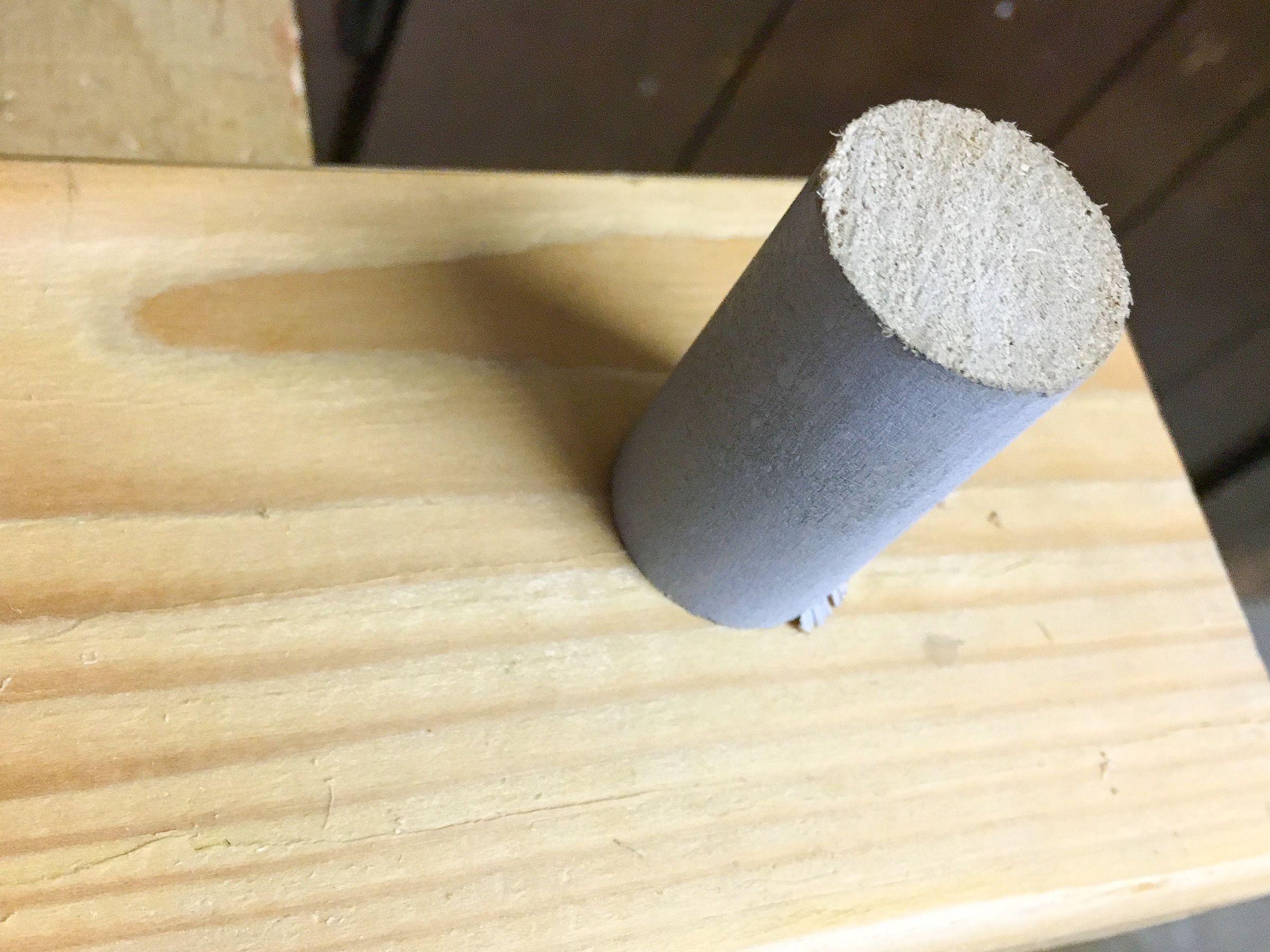

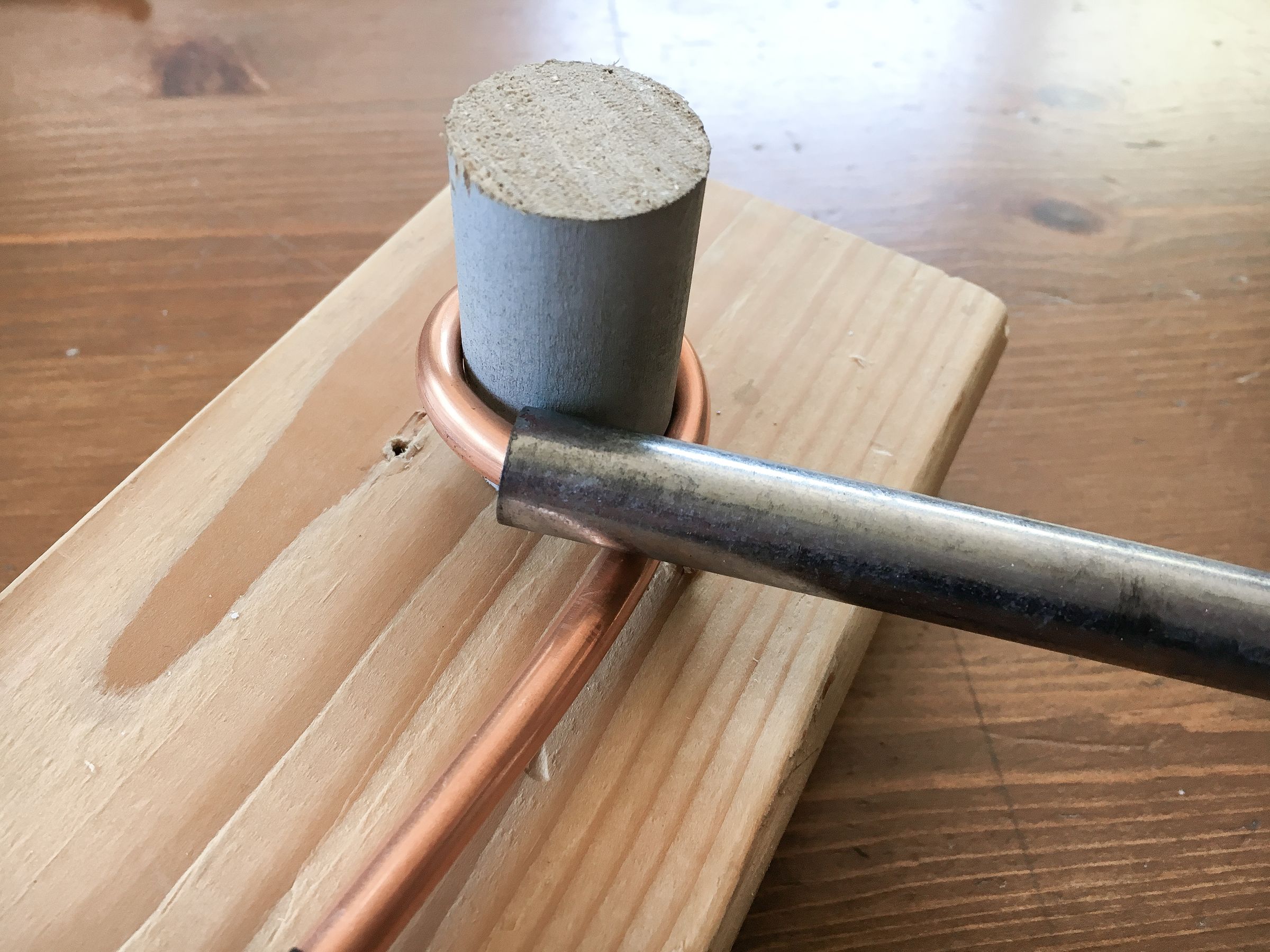

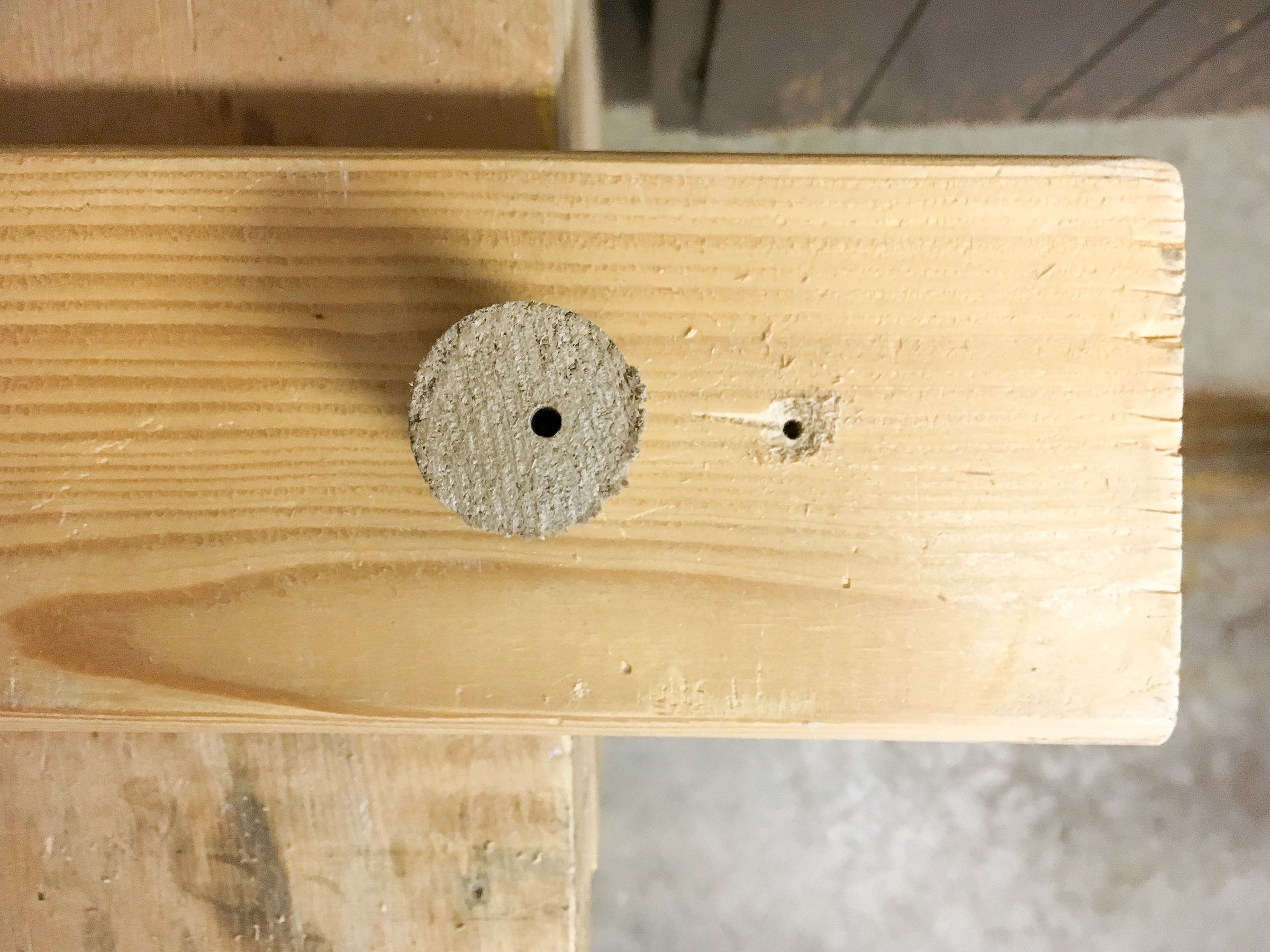

1. Mark a spot where you want your dowel to be positioned on the 2x4. I suggest centering the hole toward one end. This will allow you to hold the other end when it comes time to coil the copper tube. Drill a pilot hole in the wood and the dowel.
2. While holding the dowel in place over the pilot hole in the 2x4, screw the 3 inch screw through the wood into the dowel making sure it is tightly secured.

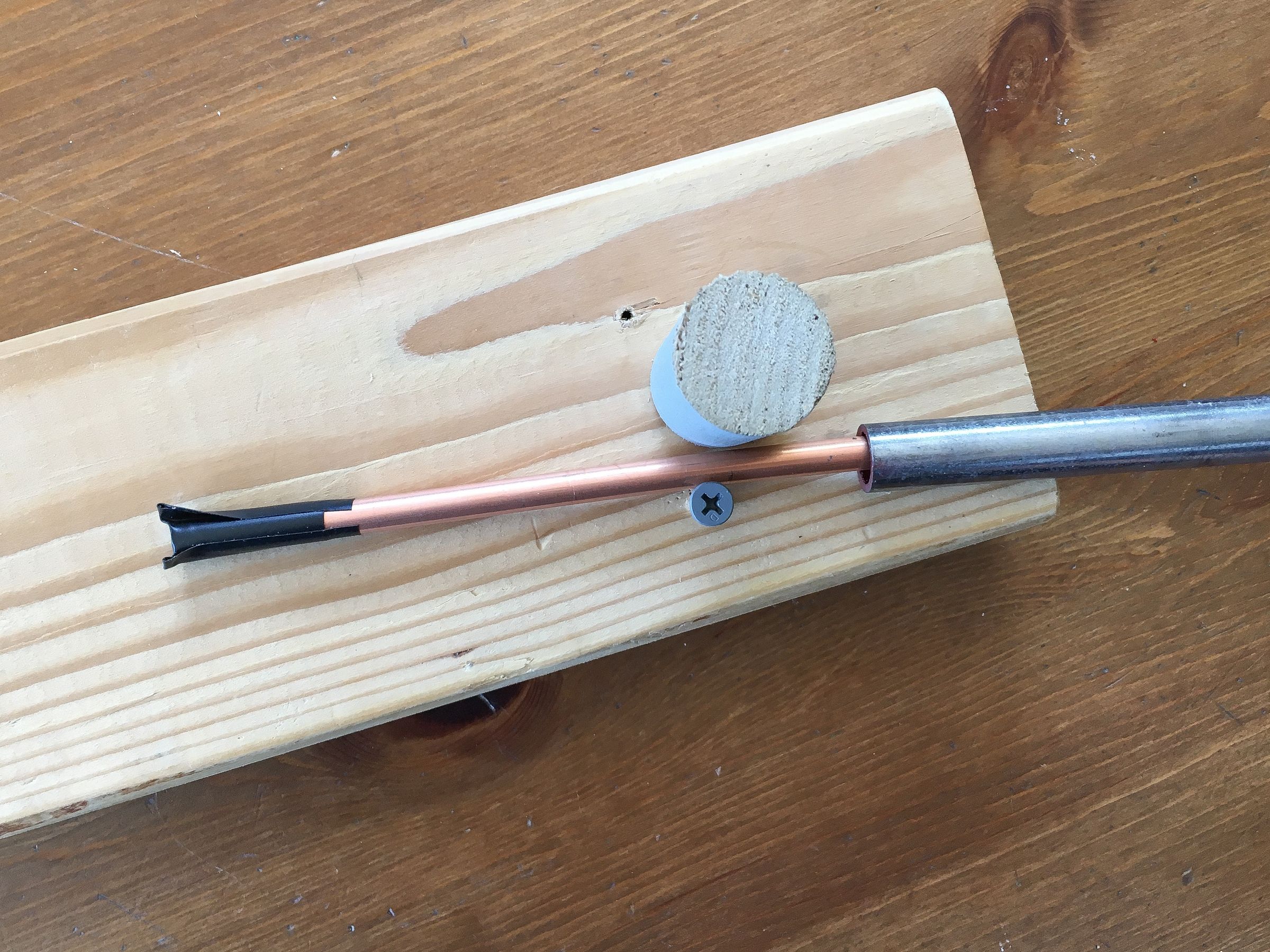

3. Measure and mark a spot that is slightly larger that the diameter of the copper tube. In this case 1/4 inch. Screw the 1 1/2 inch screw into place.

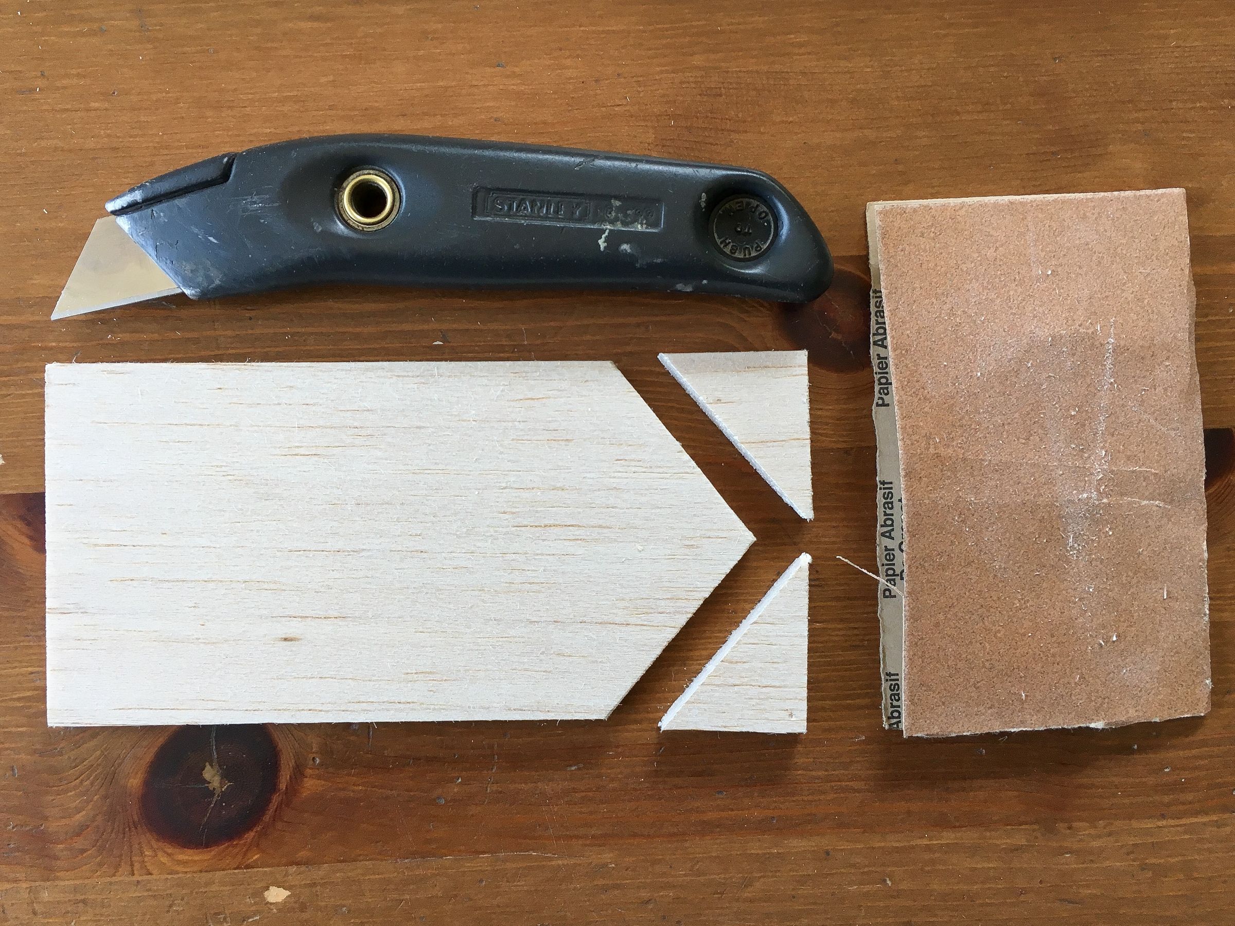

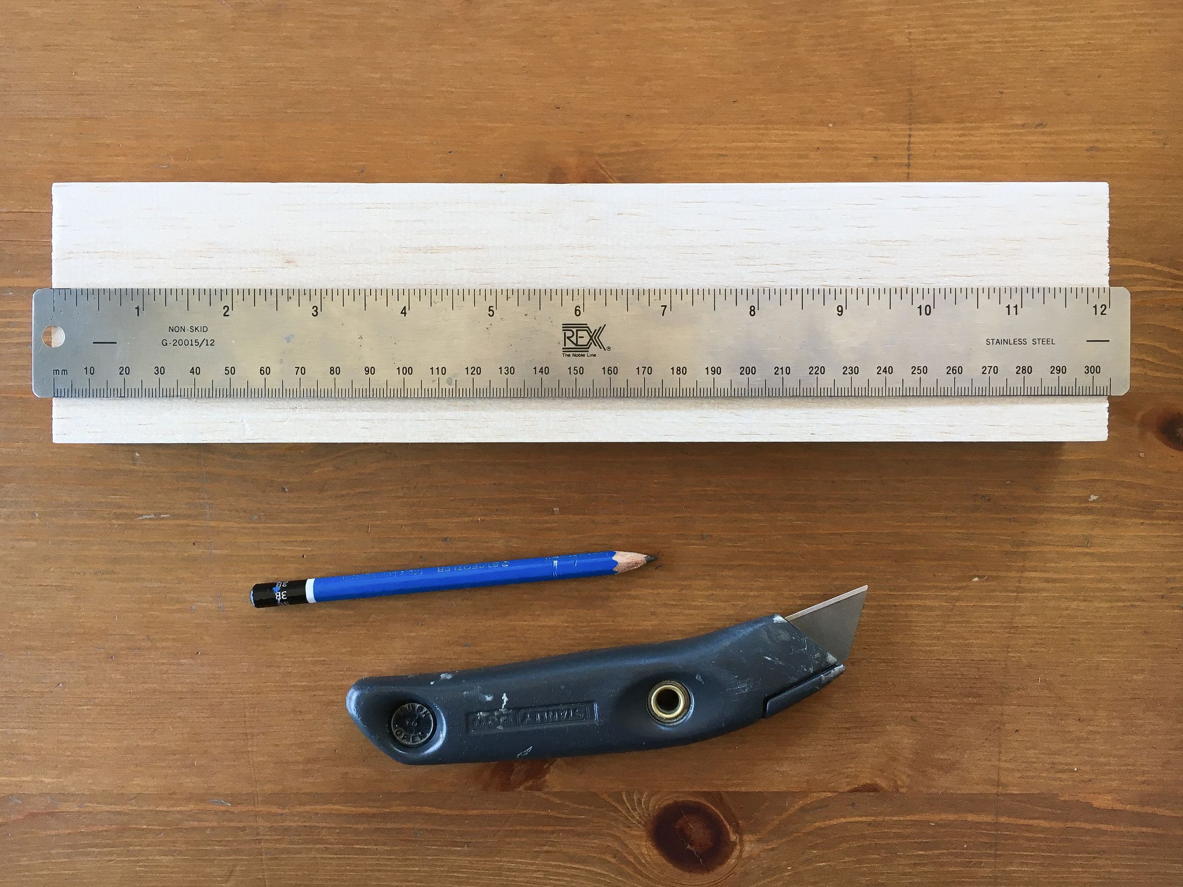

CUTTING, SANDING, & SHAPING

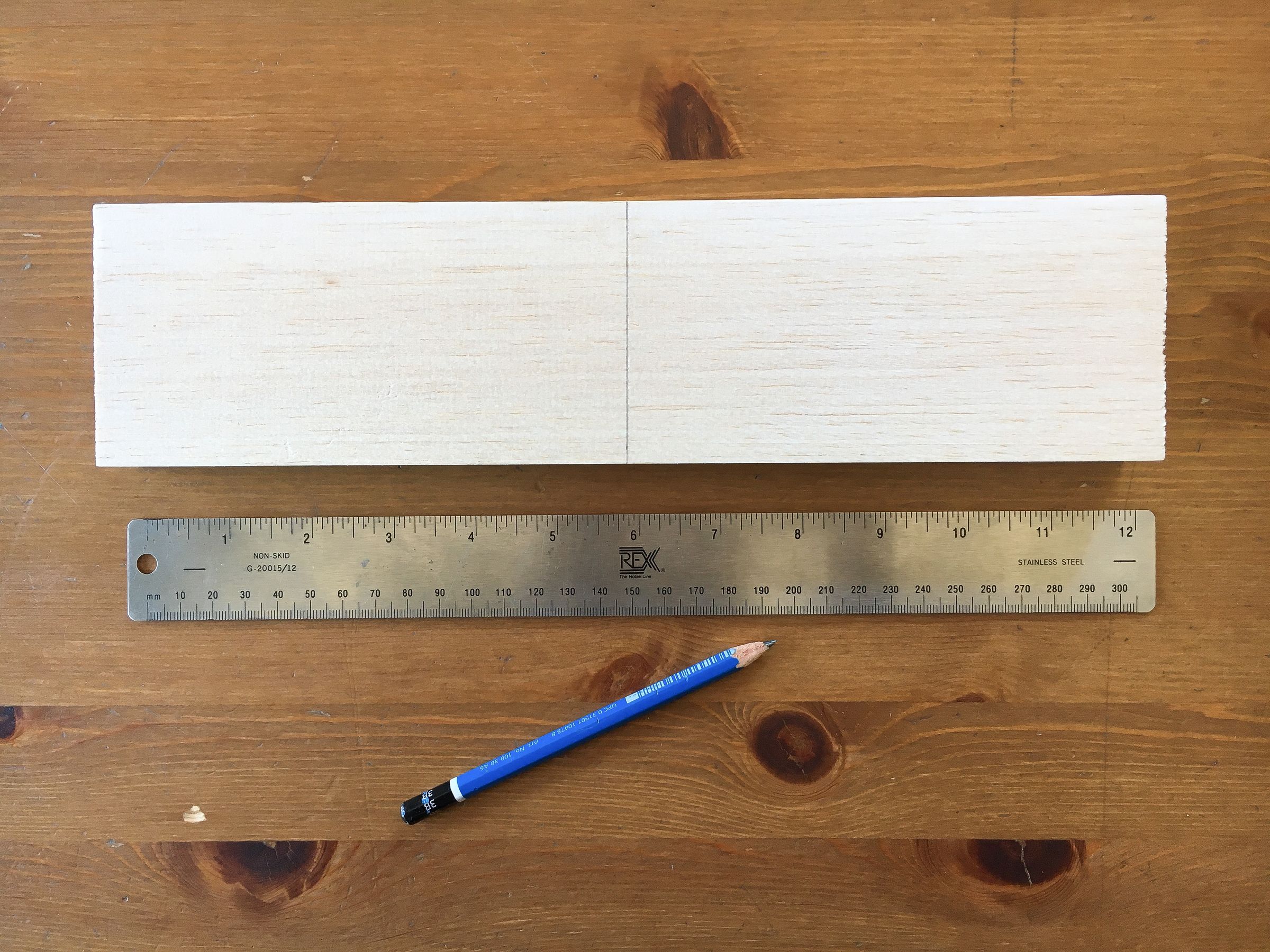

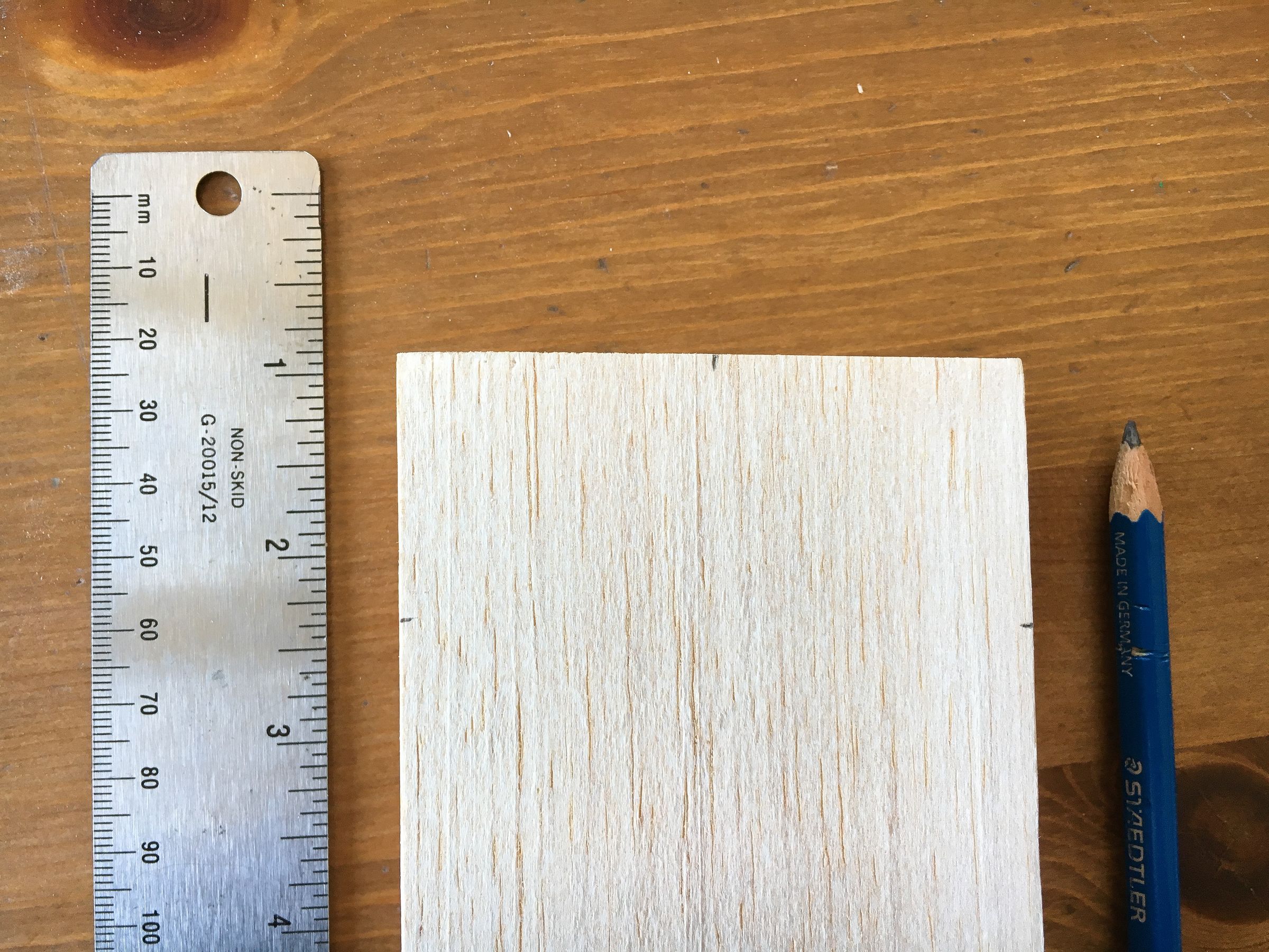

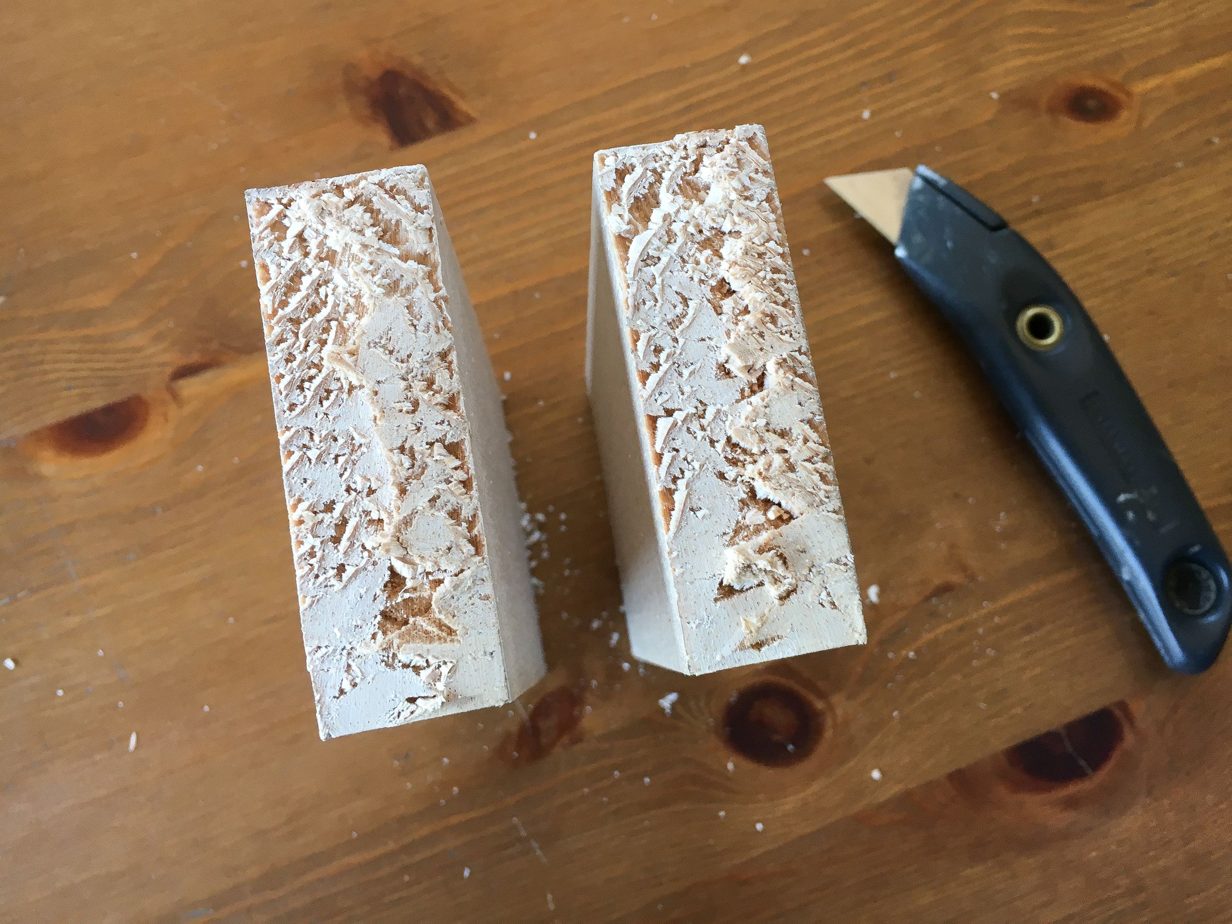

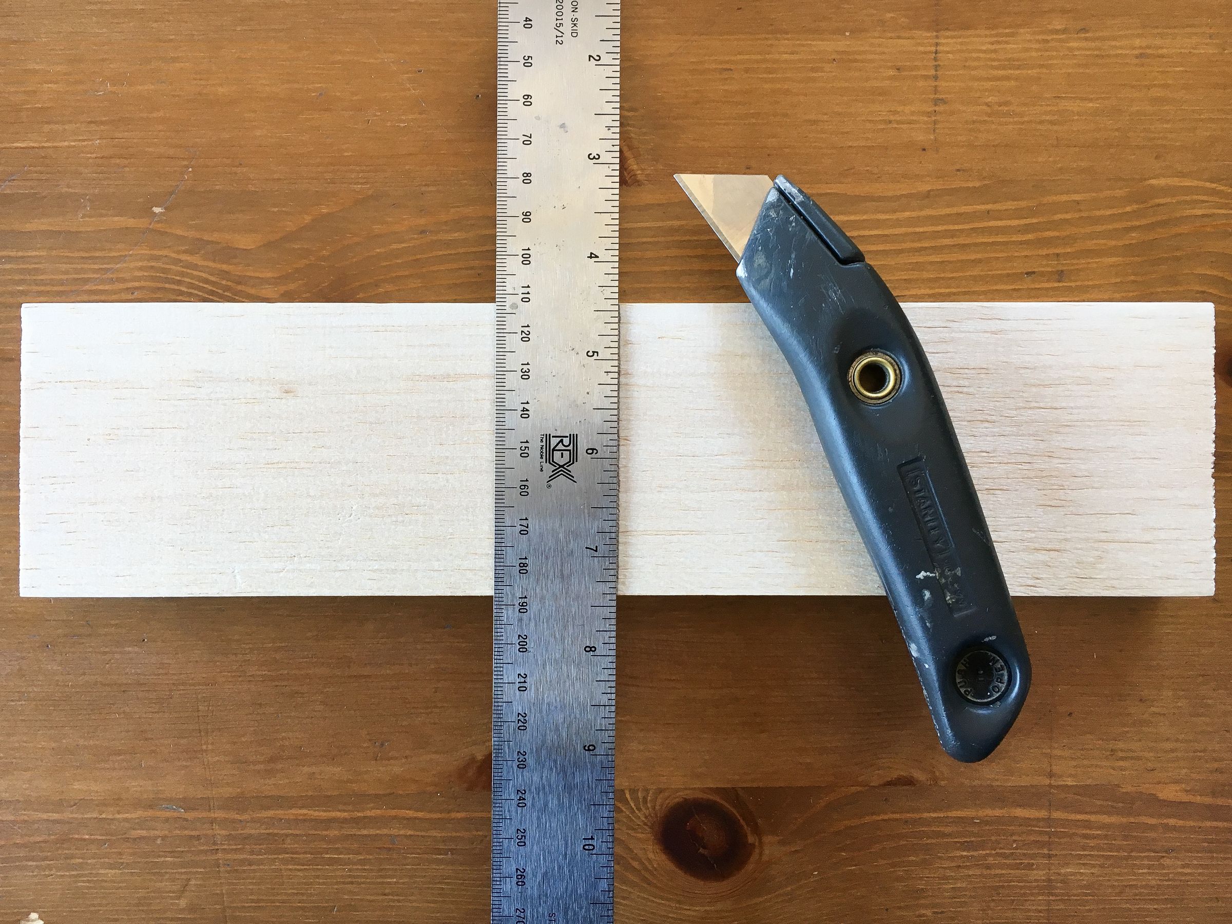

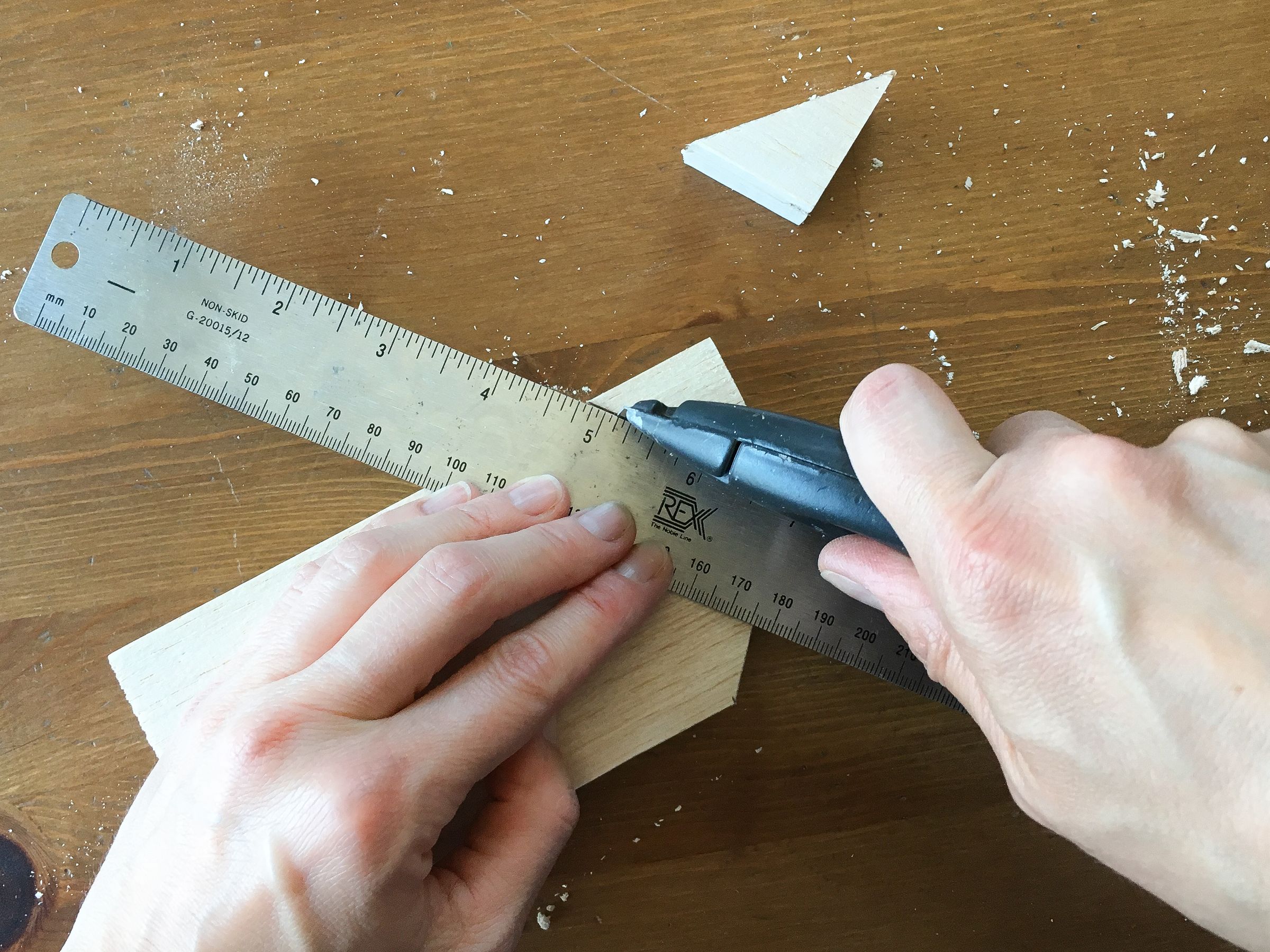

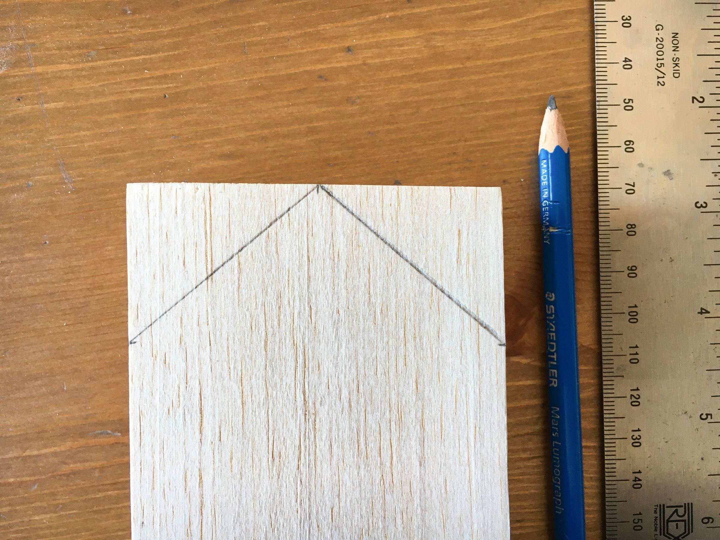

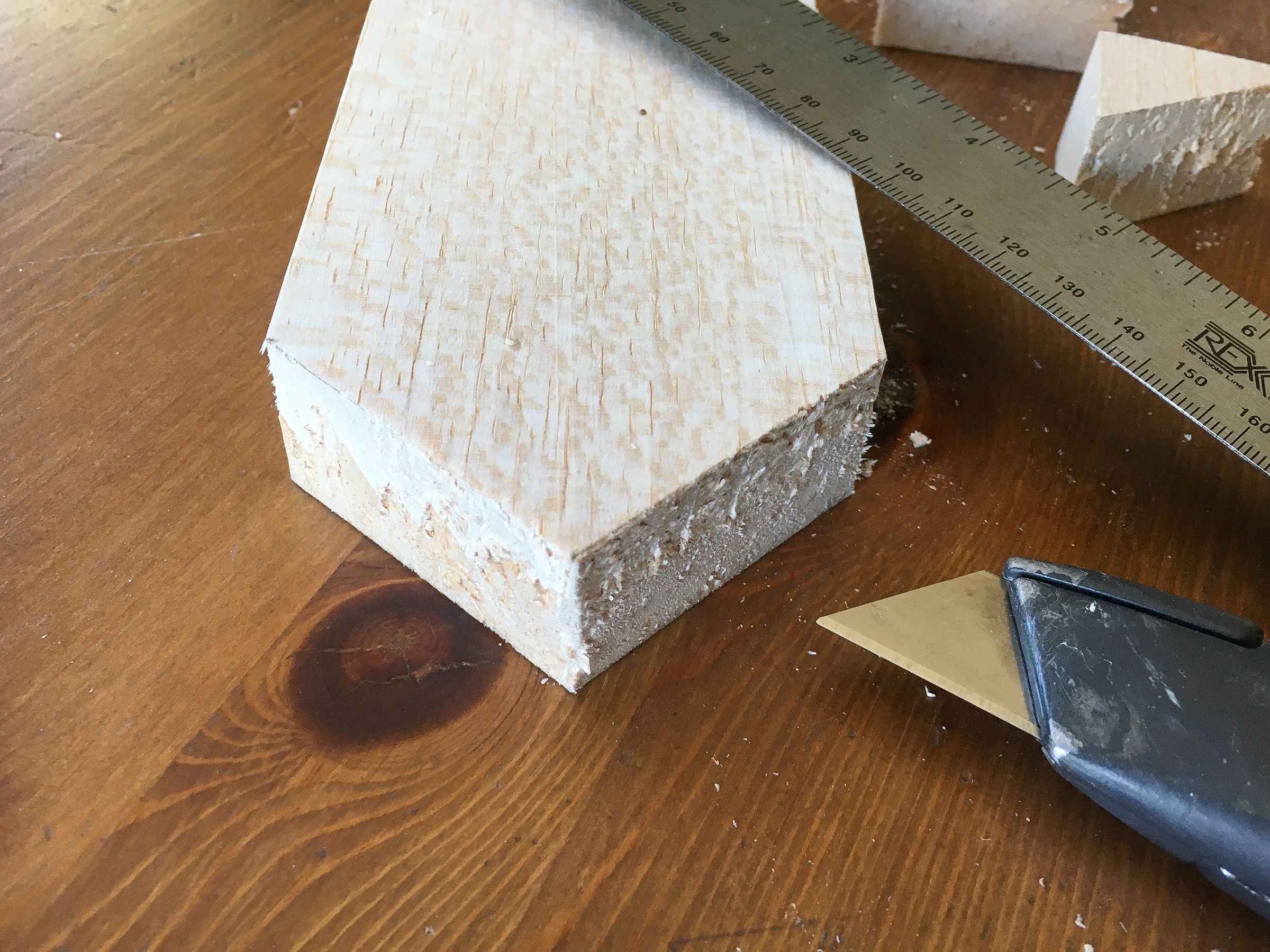

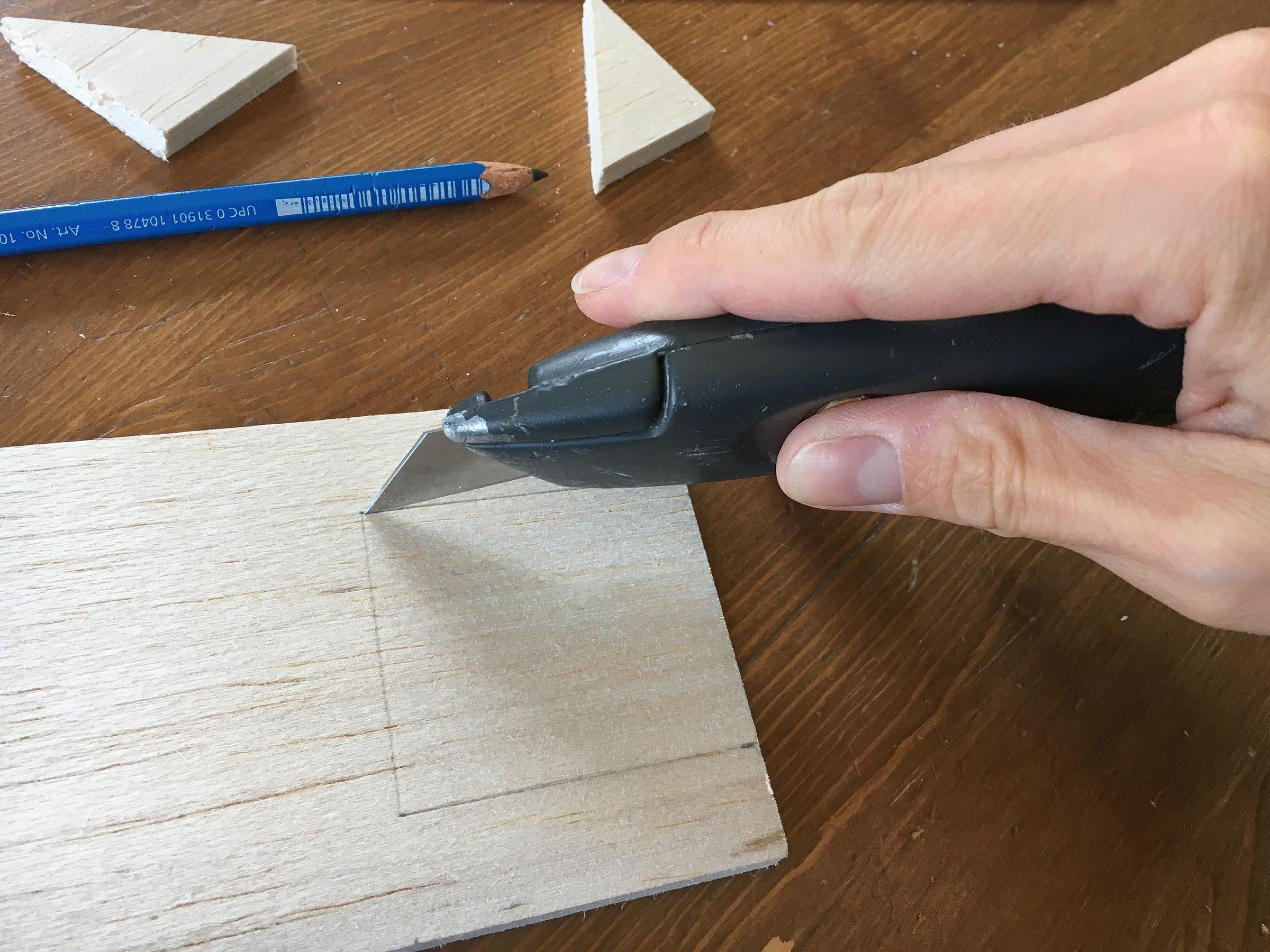

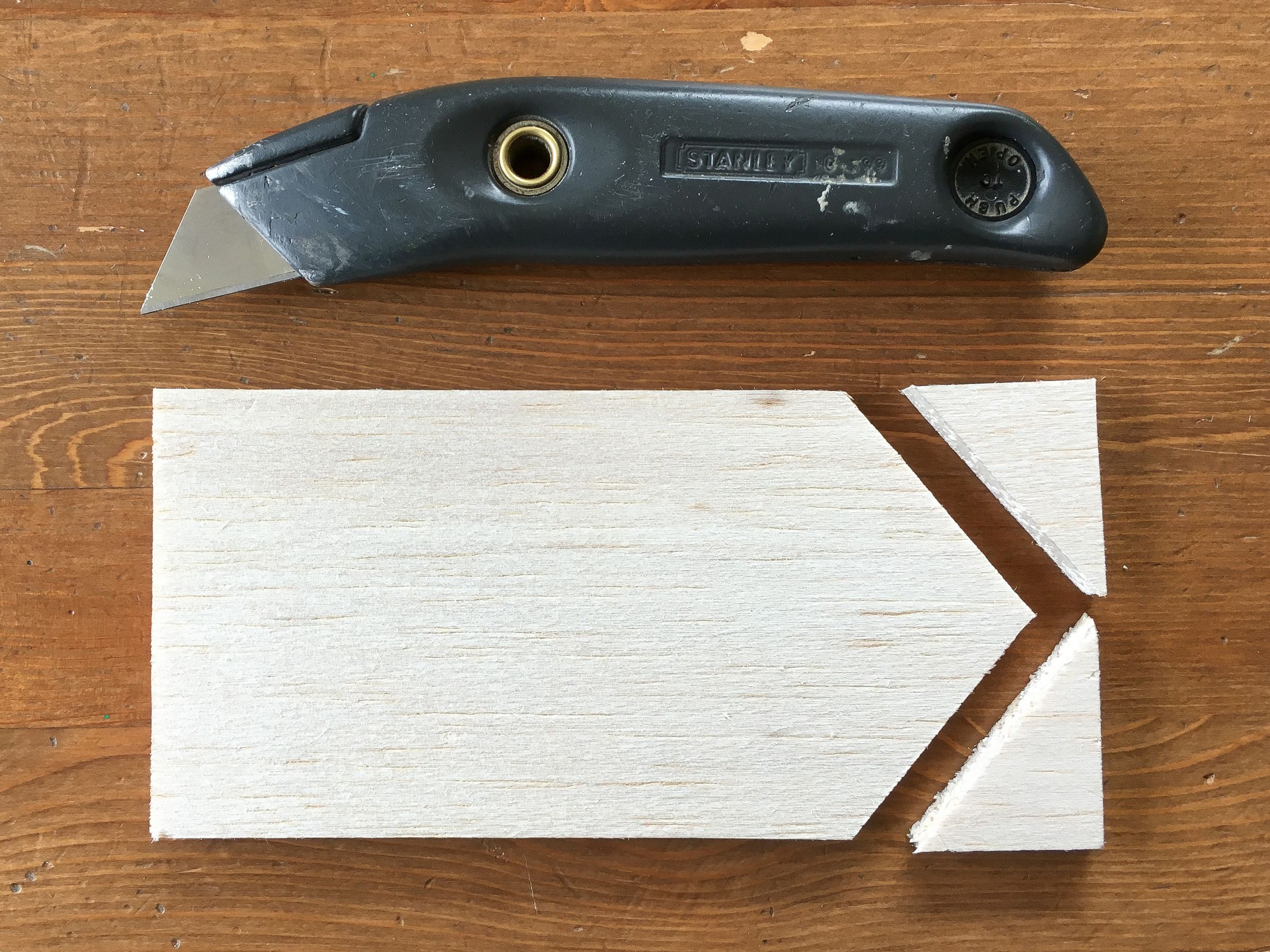

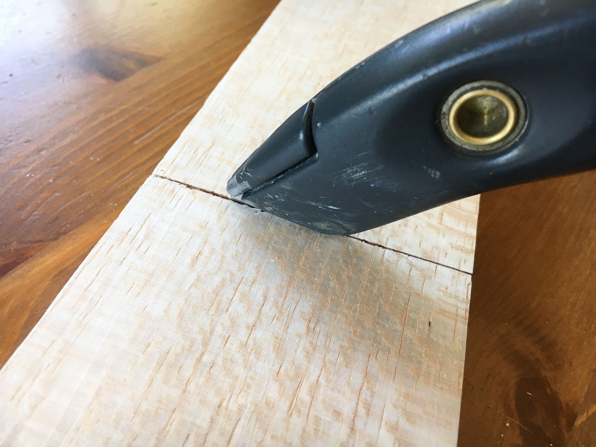

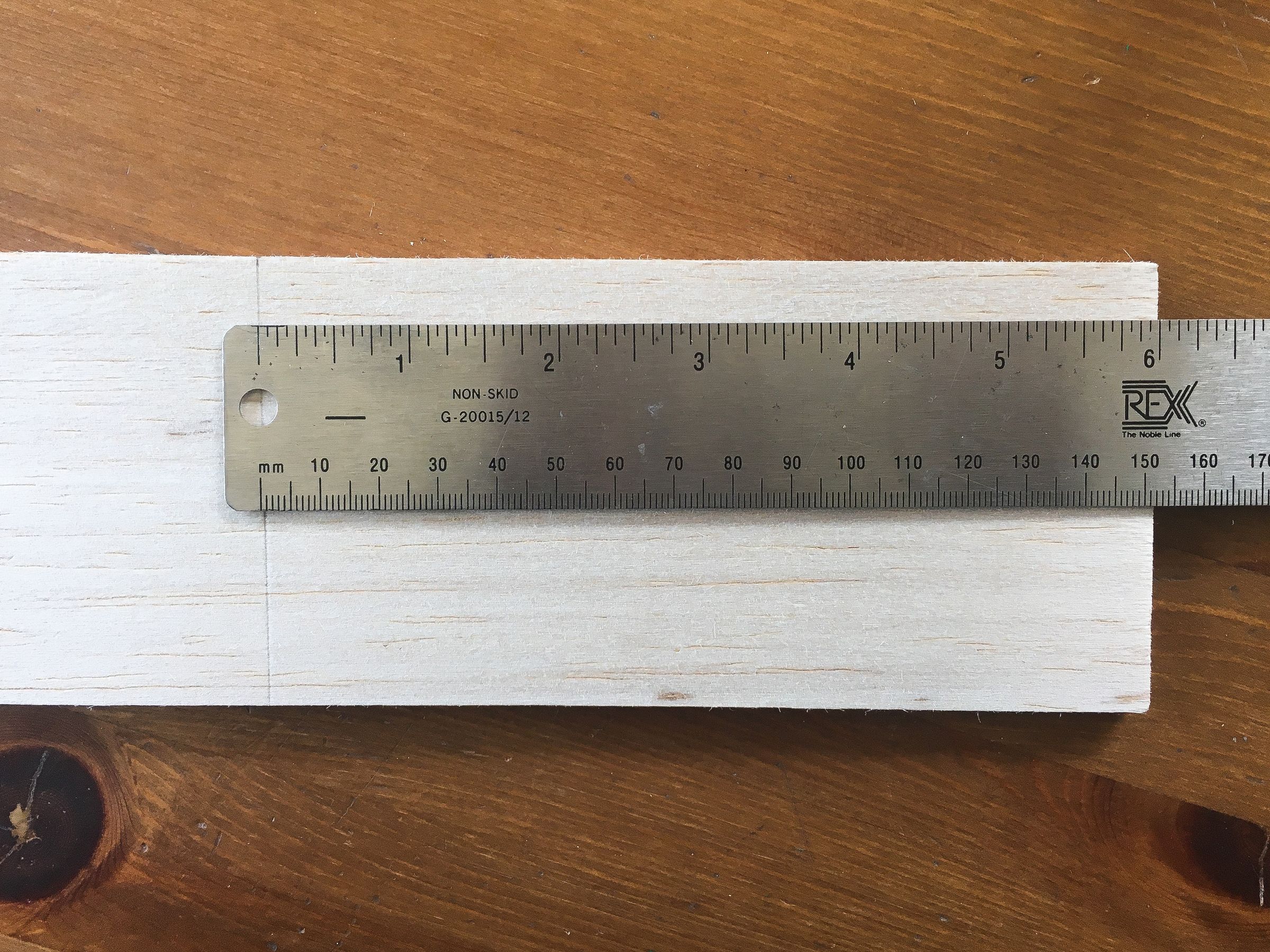

1. If you can find 6x3x1 inch balsa wood blocks great! I could only find 12x3x1 inch pieces so cutting was necessary! Measure a six inch mark on each side of the balsa and draw a straight line with a ruler. Cut the balsa wood using a utility knife. Make several passes as to not crush the balsa wood cells. Some will inevitably crush, but several shallow passes will get the best result.
2. Make another mark in the middle at one end of the block. Measure down 1 1/4 inches on each sides and draw lines to match up the middle and the side marks. We are making a pointed end for the front of the boat.
3. Using the utility knife and a ruler cut on the lines using the same method as described above.

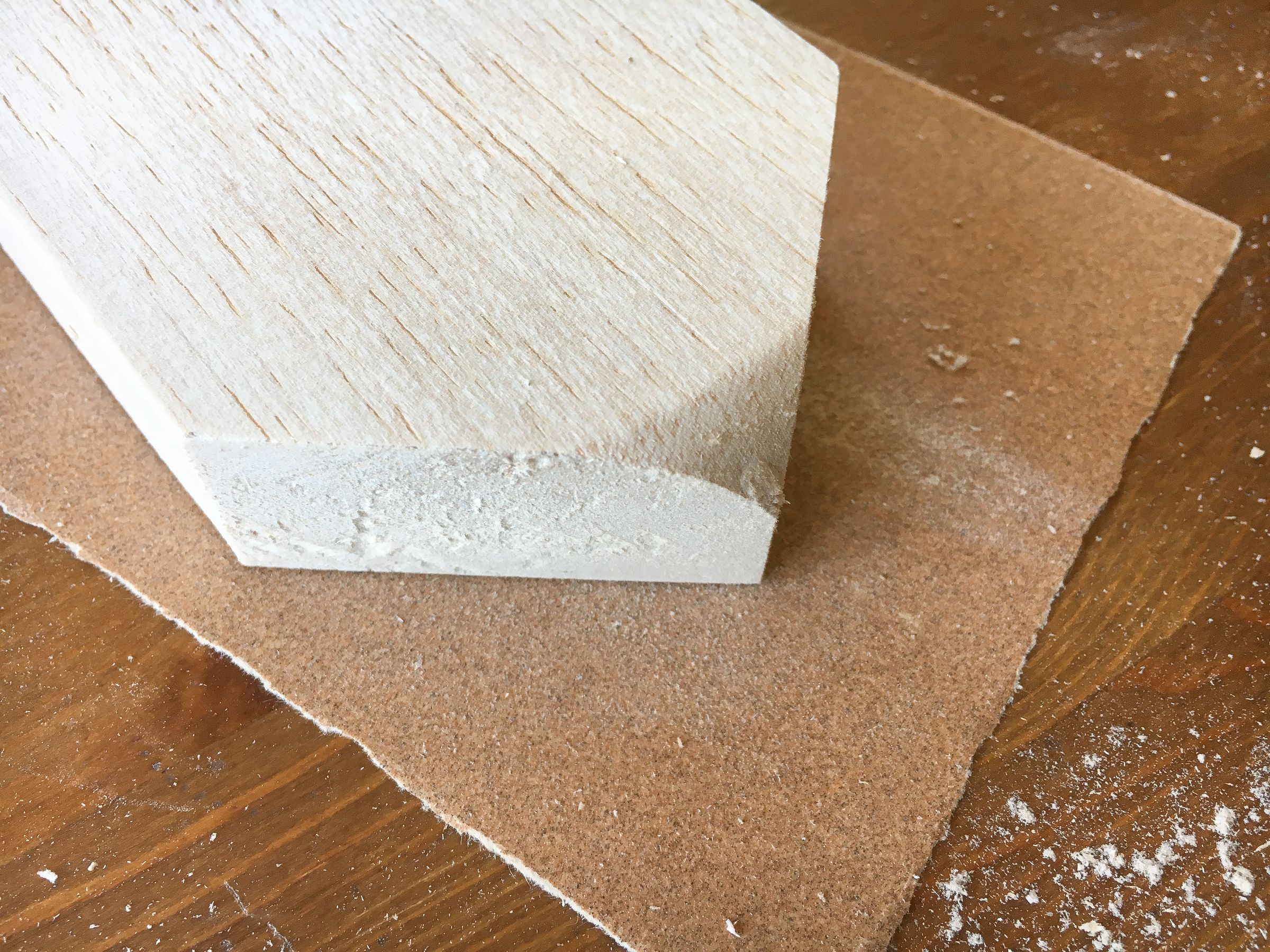

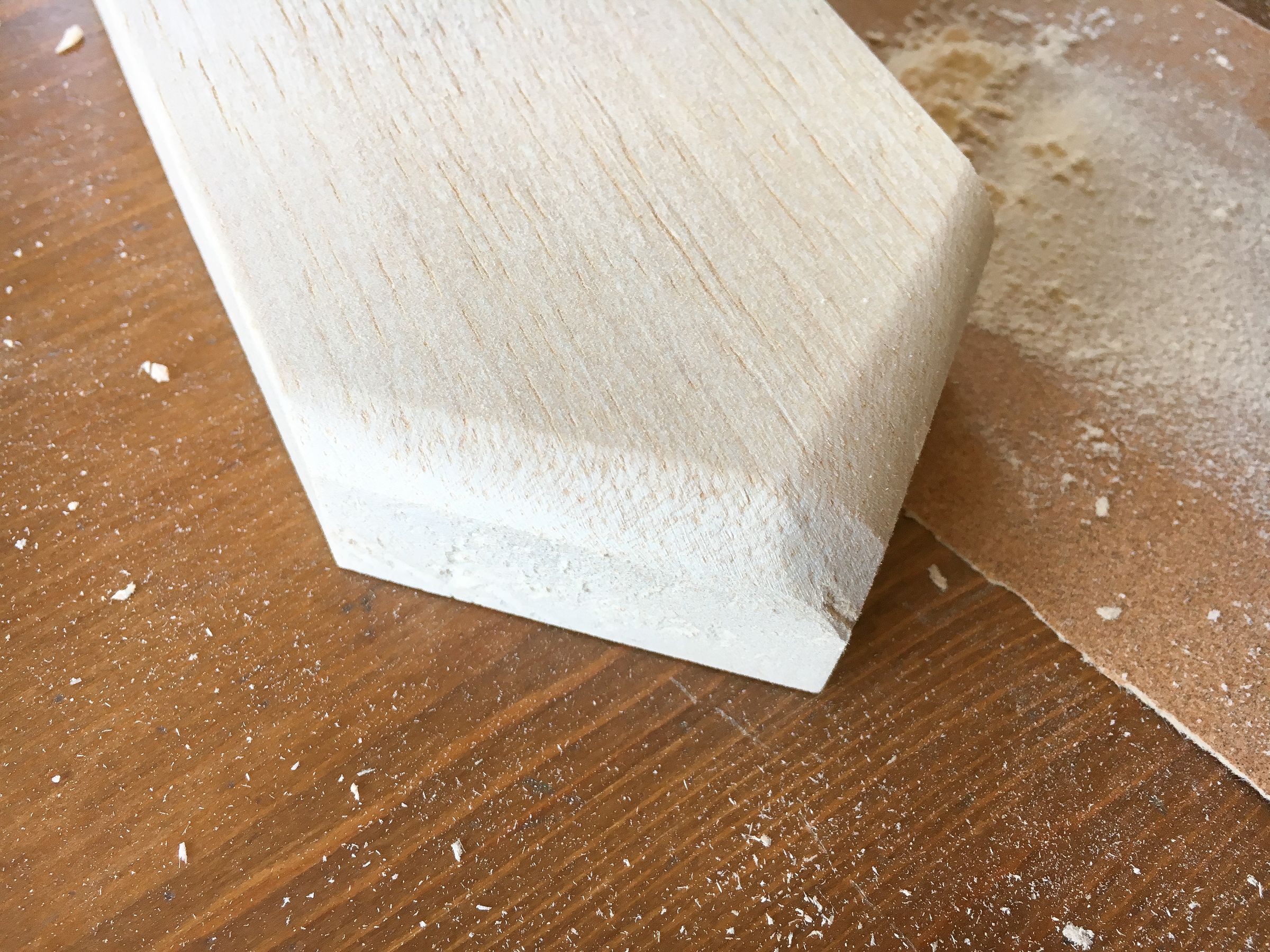

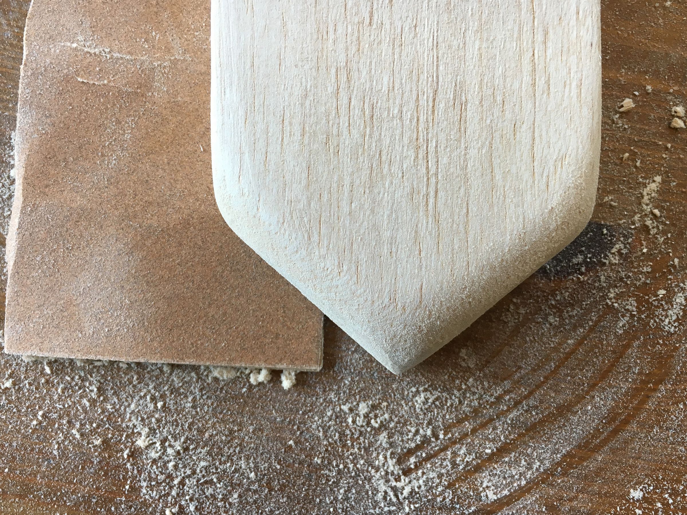

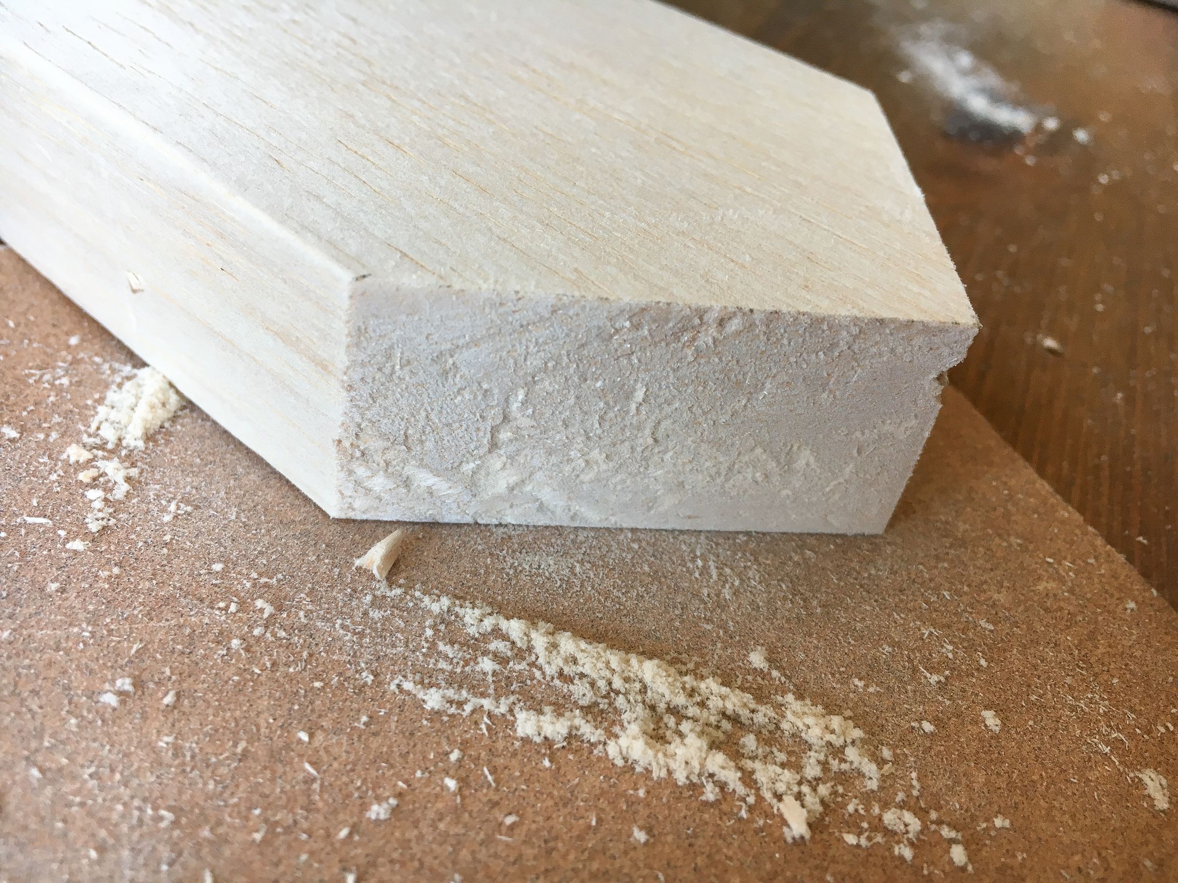

4. Sand the cut sides and edges with fine grit sandpaper to smooth them out. This is a good point to choose whether or not to shape the boat or round the bottom edge. If this step is omitted it won't affect how the boat functions, but will add an artistic element (making it a STEAM project). The boats could also be painted or decorated in some manner.

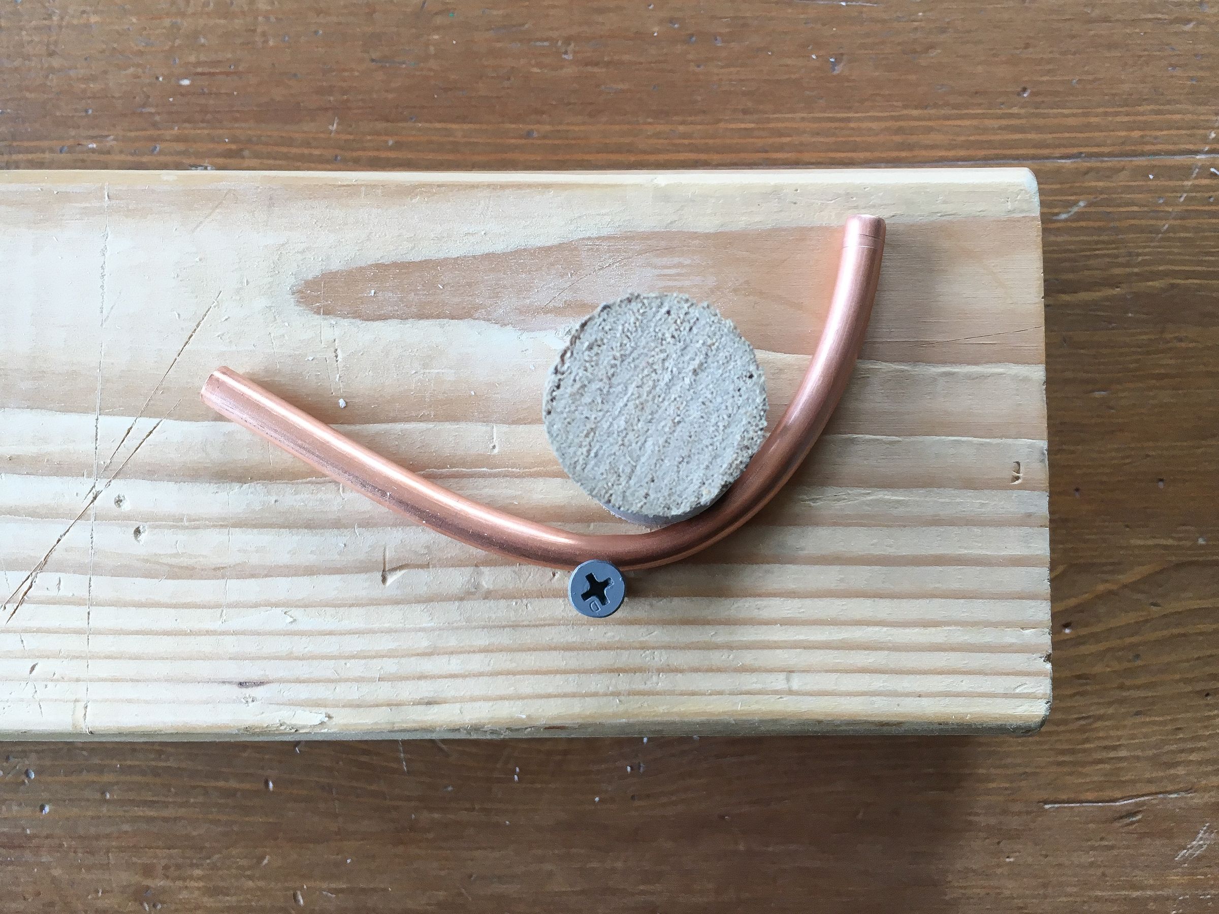

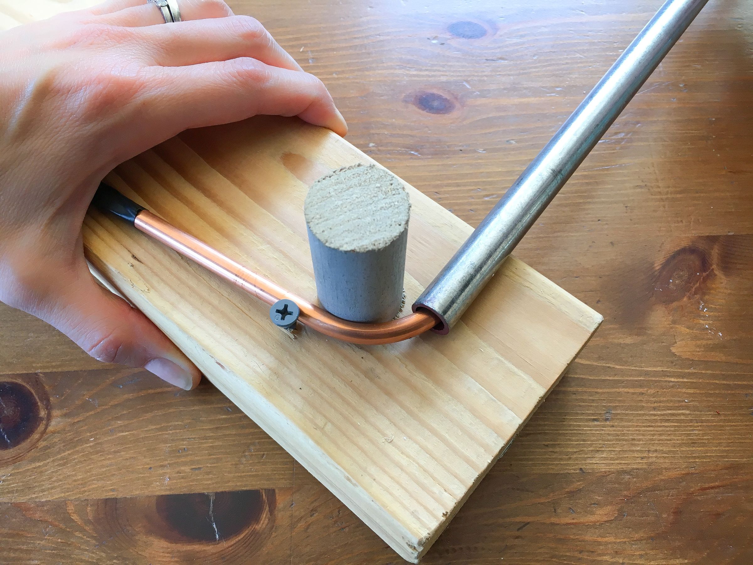

COILING COPPER & MAKING HOLES

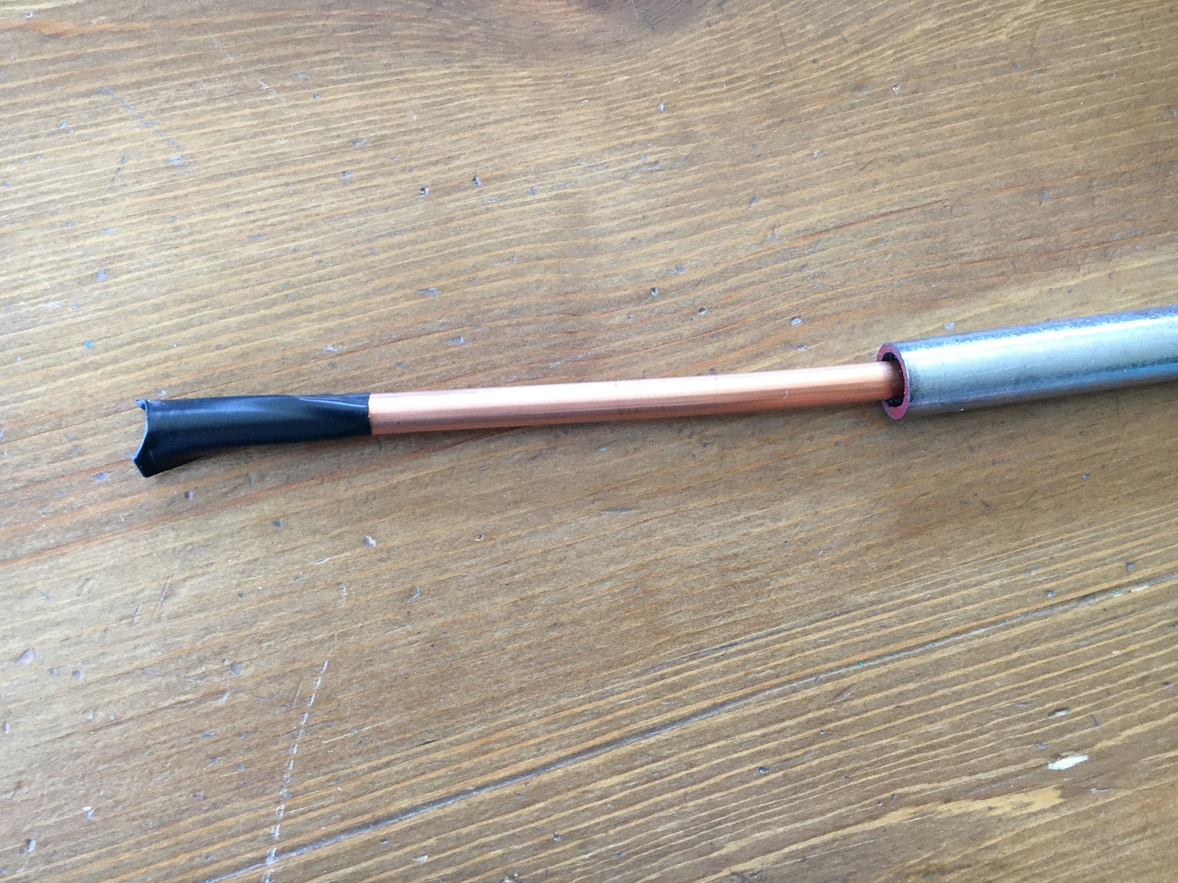

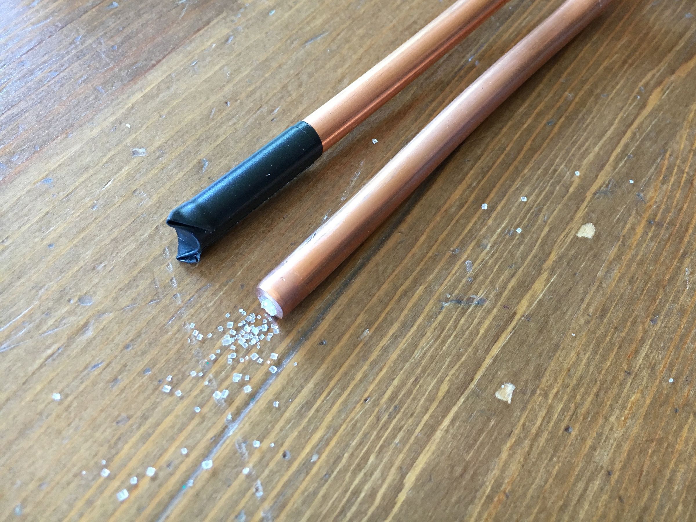

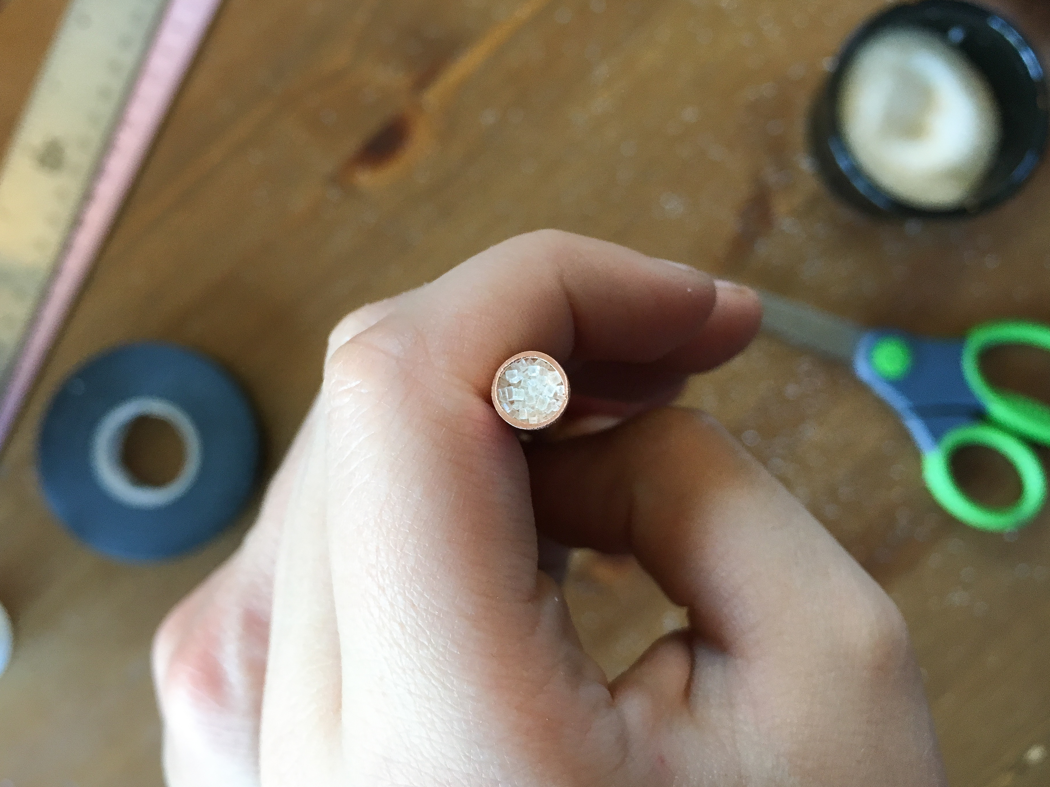

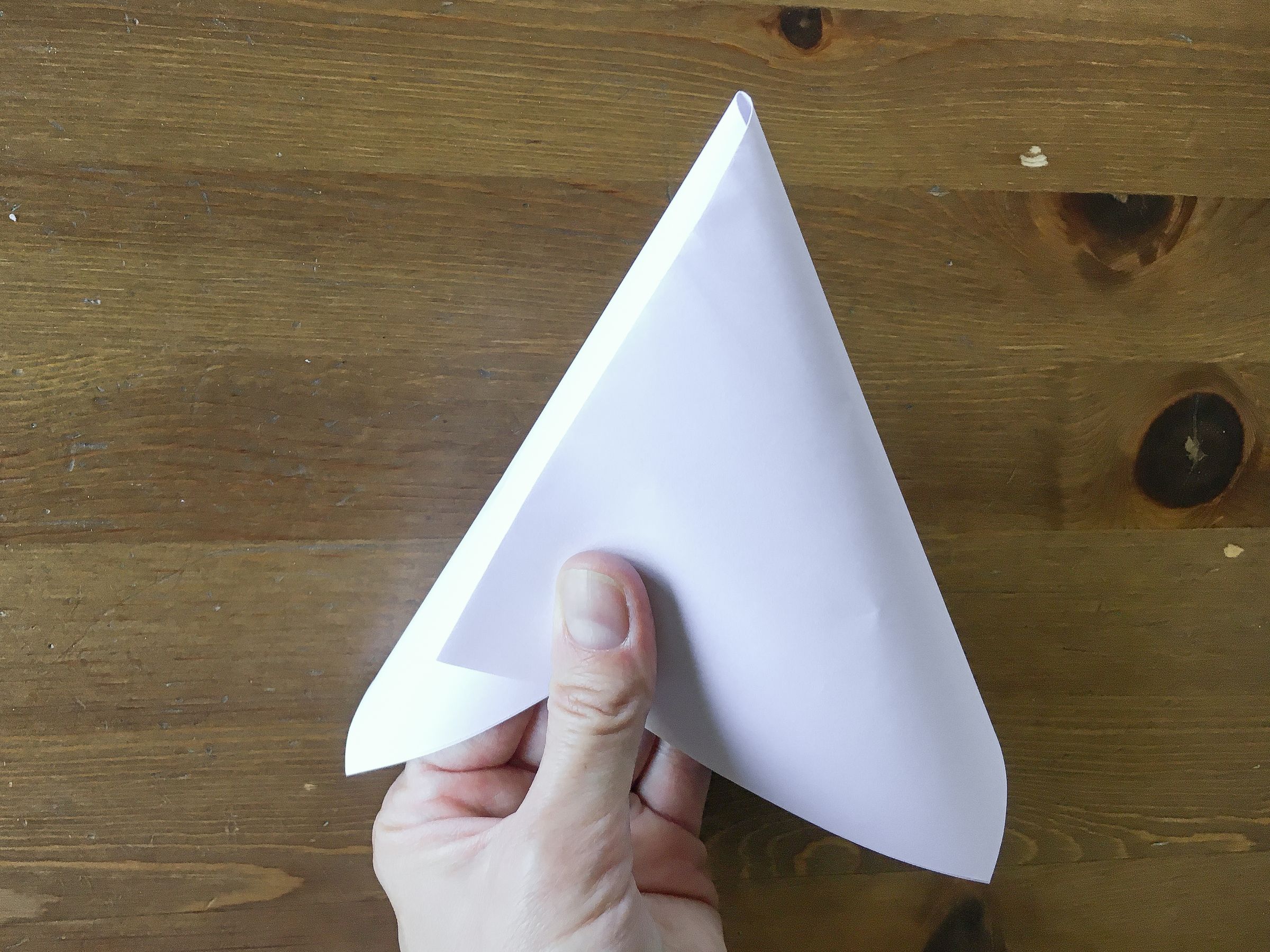

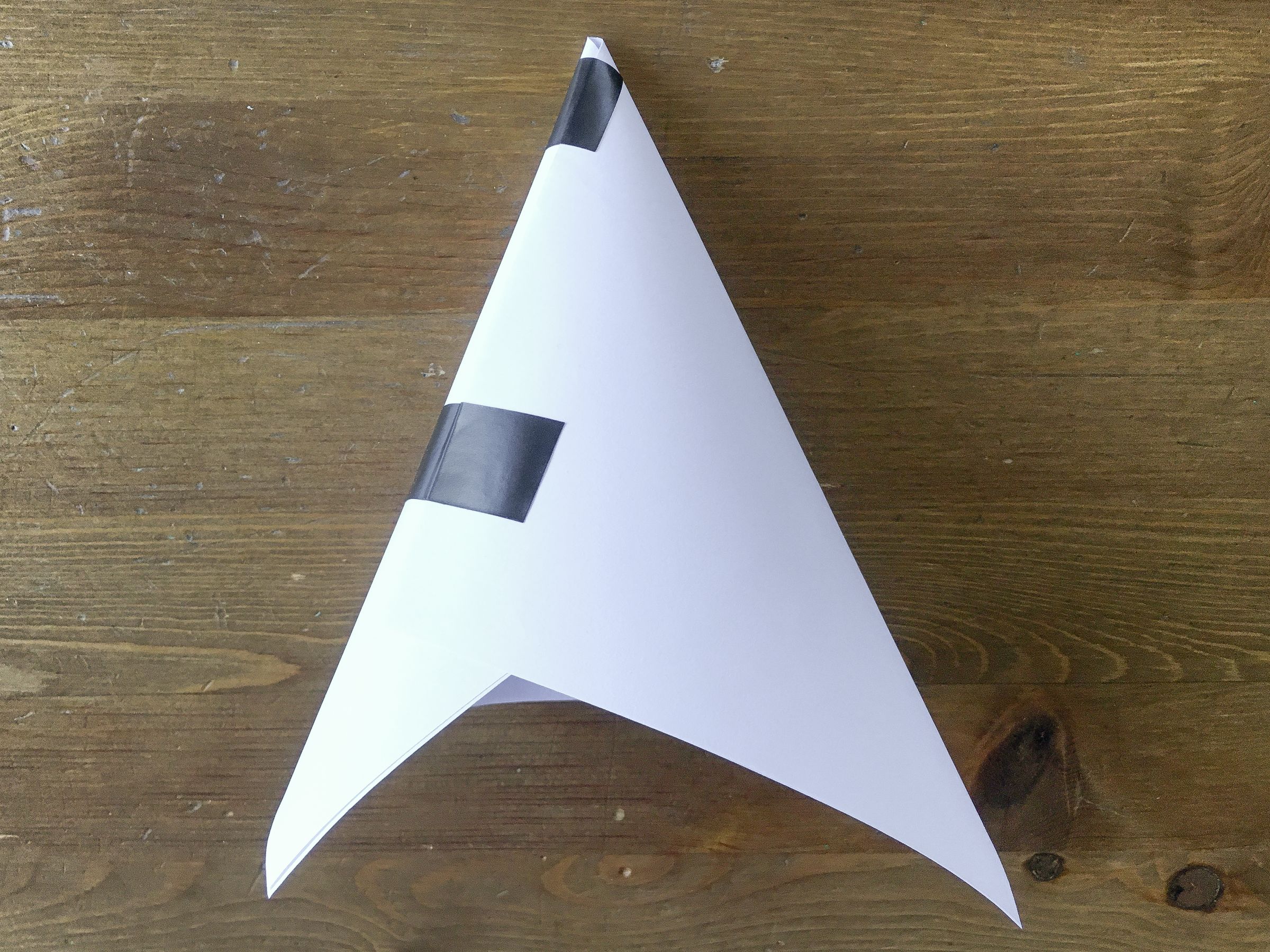

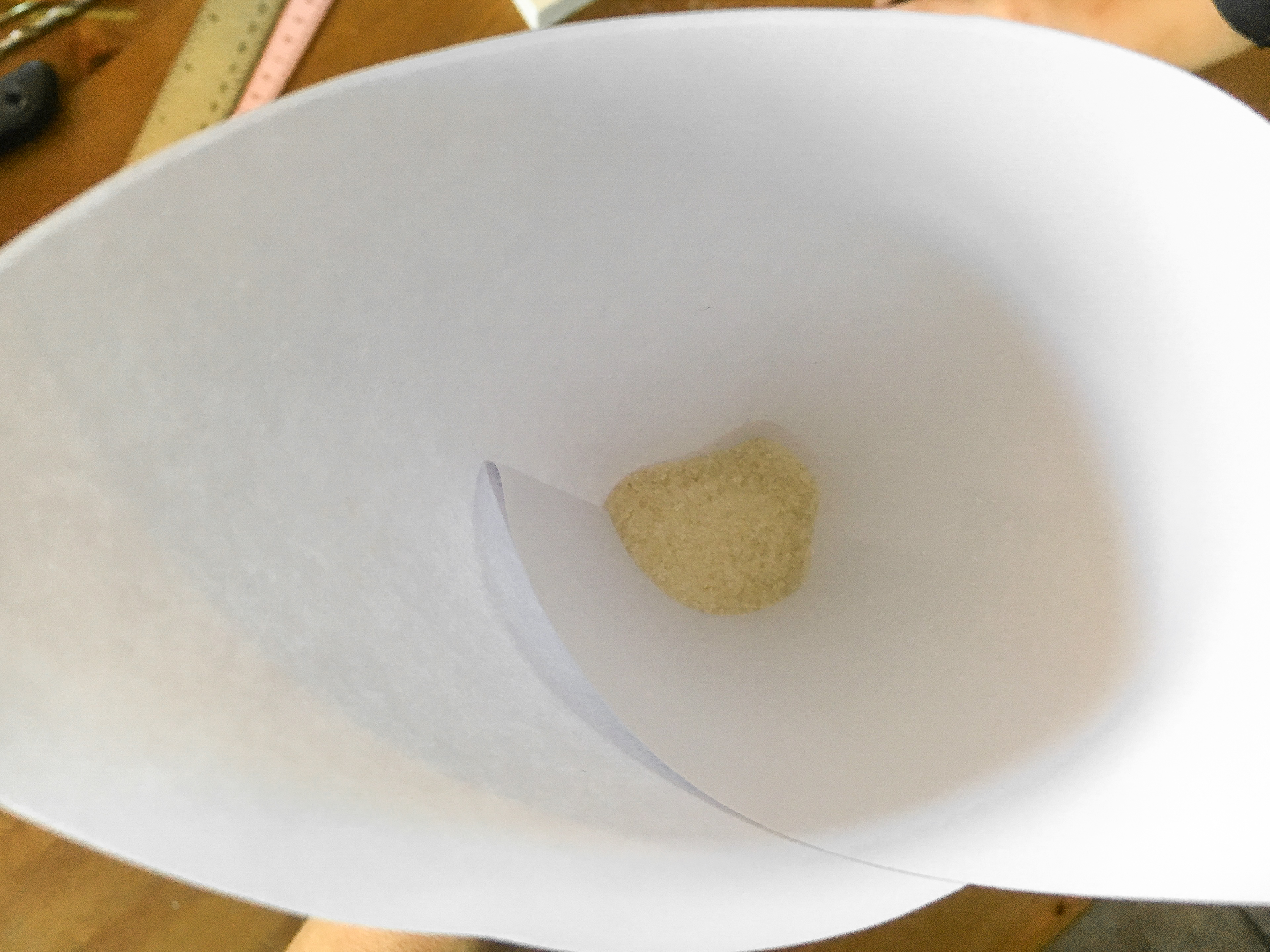

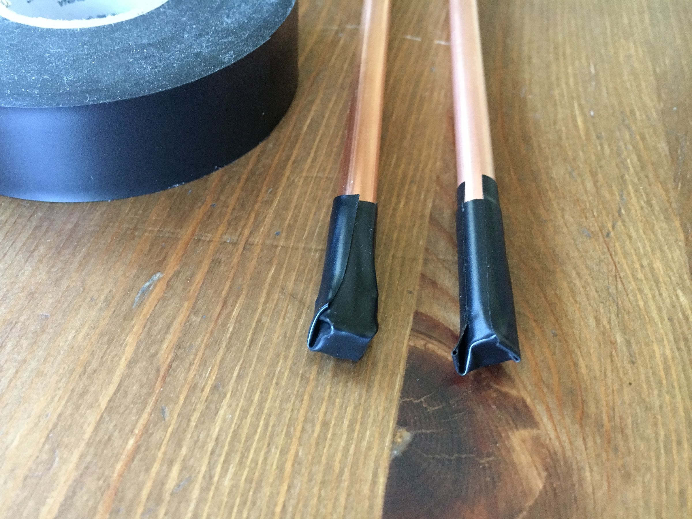

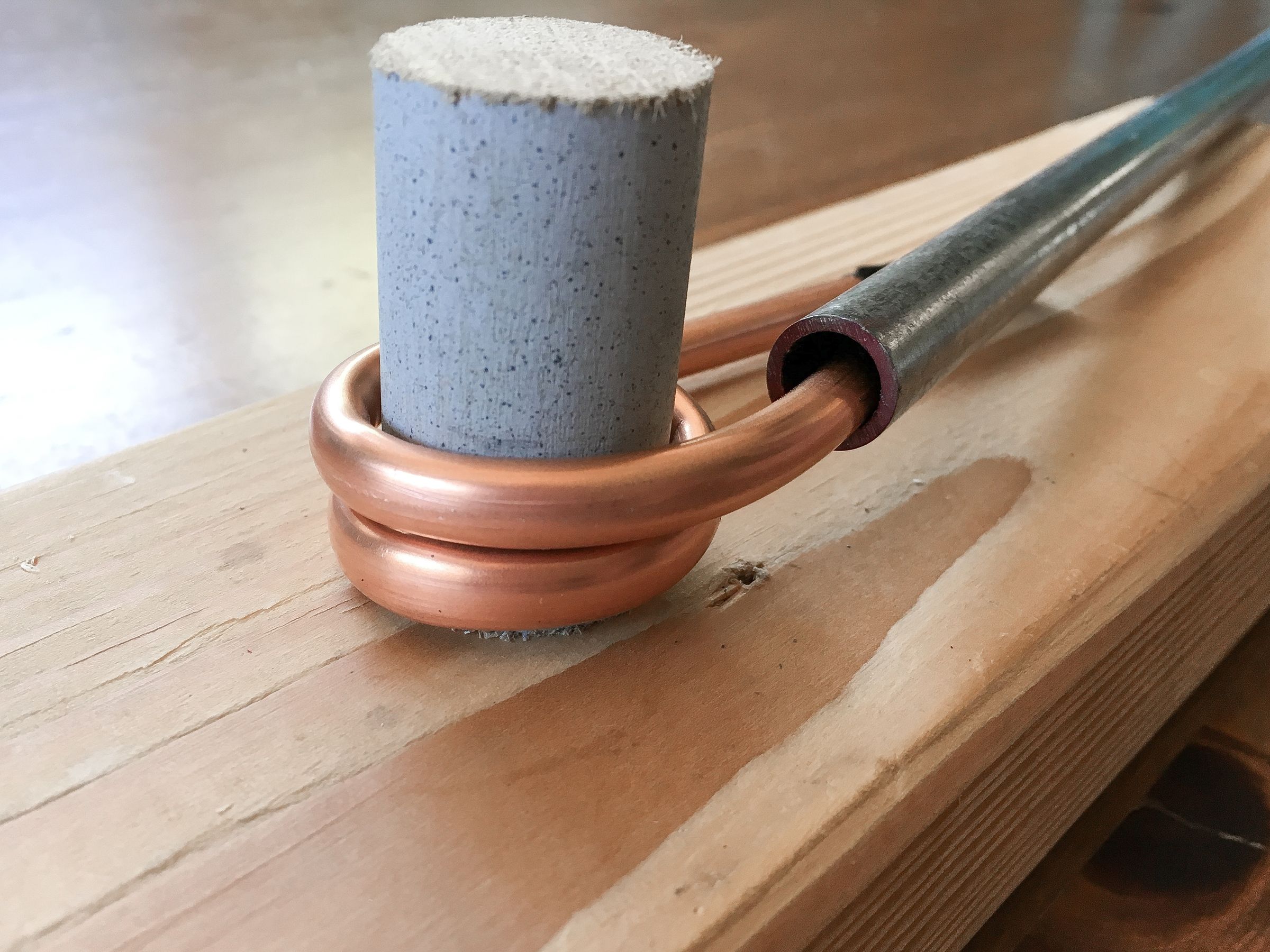

1. In order to coil the copper tubes without them bending, collapsing, or flattening entirely, they will need to be filled with sugar, salt, or sand (I used sugar). Make a simple funnel out of a piece of printer paper or scrap paper. The small hole in the funnel will need to fit inside the end of the copper tube, so the opening will need to be less that 1/4 inch. Tape the paper to keep it in place. (Alternately, you can use a small plastic funnel if you have access to one or can find one.)
2. Using tape, close off one end of the copper tube so the sugar won't spill out. Fill the tube by adding small amounts of sugar to the funnel. This takes some patience as the sugar tends to get stuck in the funnel. Add in very small amounts for the fastest result.
3. Once the tube is completely full, gently tap the taped end on the table to help settle the sugar. Add more if necessary and tape the end closed.

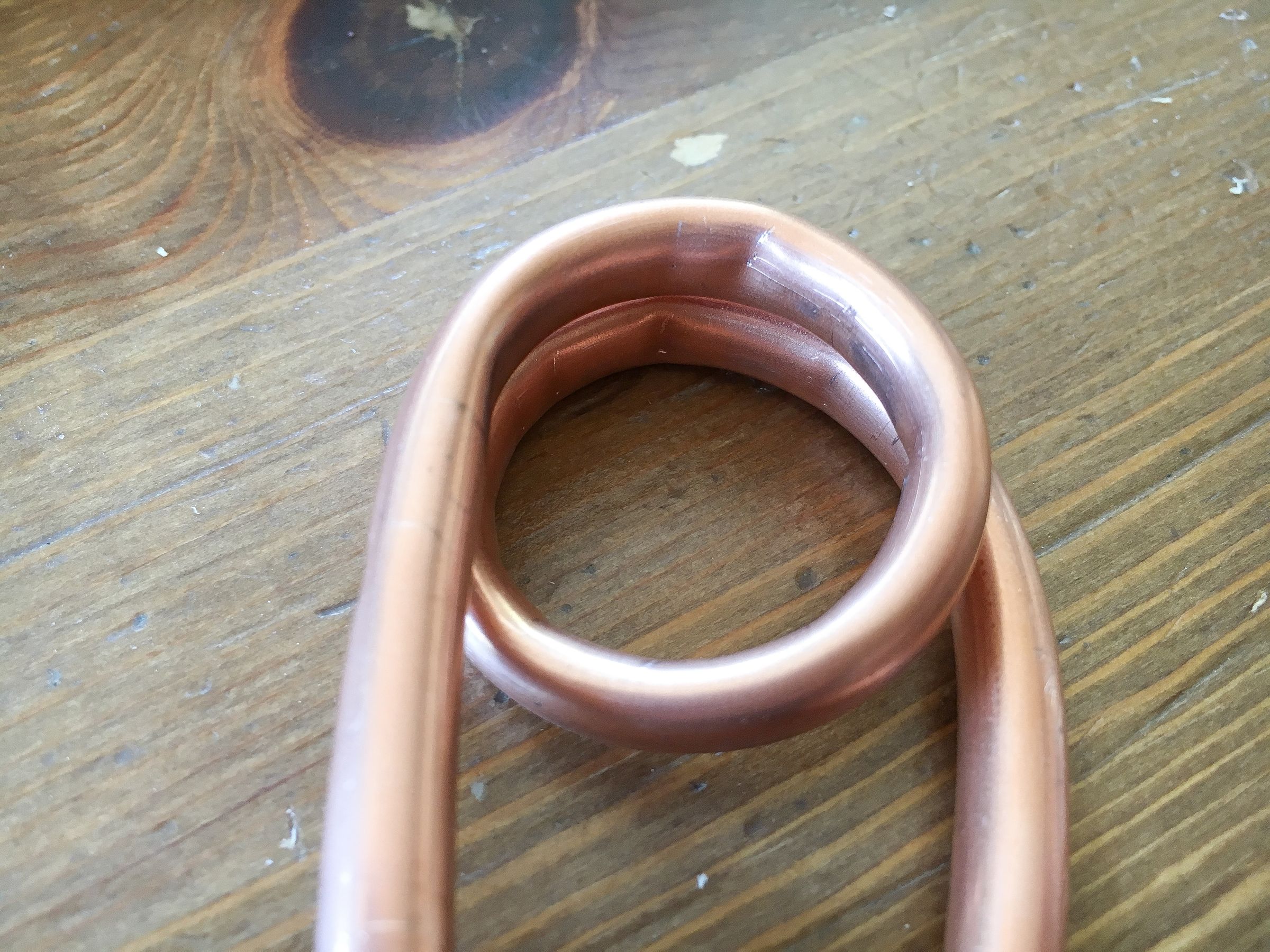

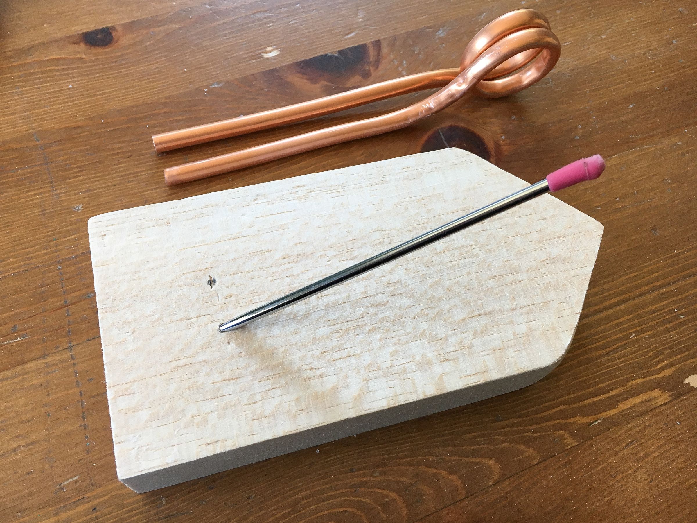

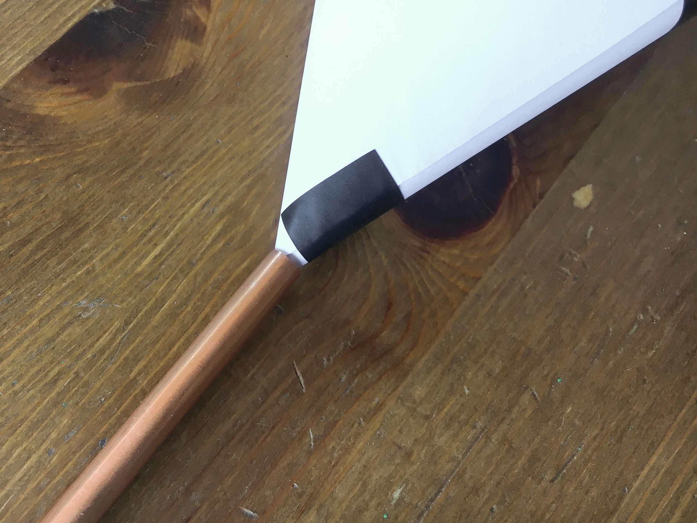

4. With a pencil, draw a mark on the copper tube about 6 inches from one end. Insert the copper tube into the steel tube. Line up the mark (on the copper tube) with the screw on the coiling mechanism making sure the copper tube is between the dowel and the screw. Gently start bending the copper tube around the dowel by only torquing the steel tube. With every small bend move the steel tube farther out to make room for more bending. Take your time with this. The sugar inside the tube will help it from collapsing but if the copper is bent too fast it can still flatten.

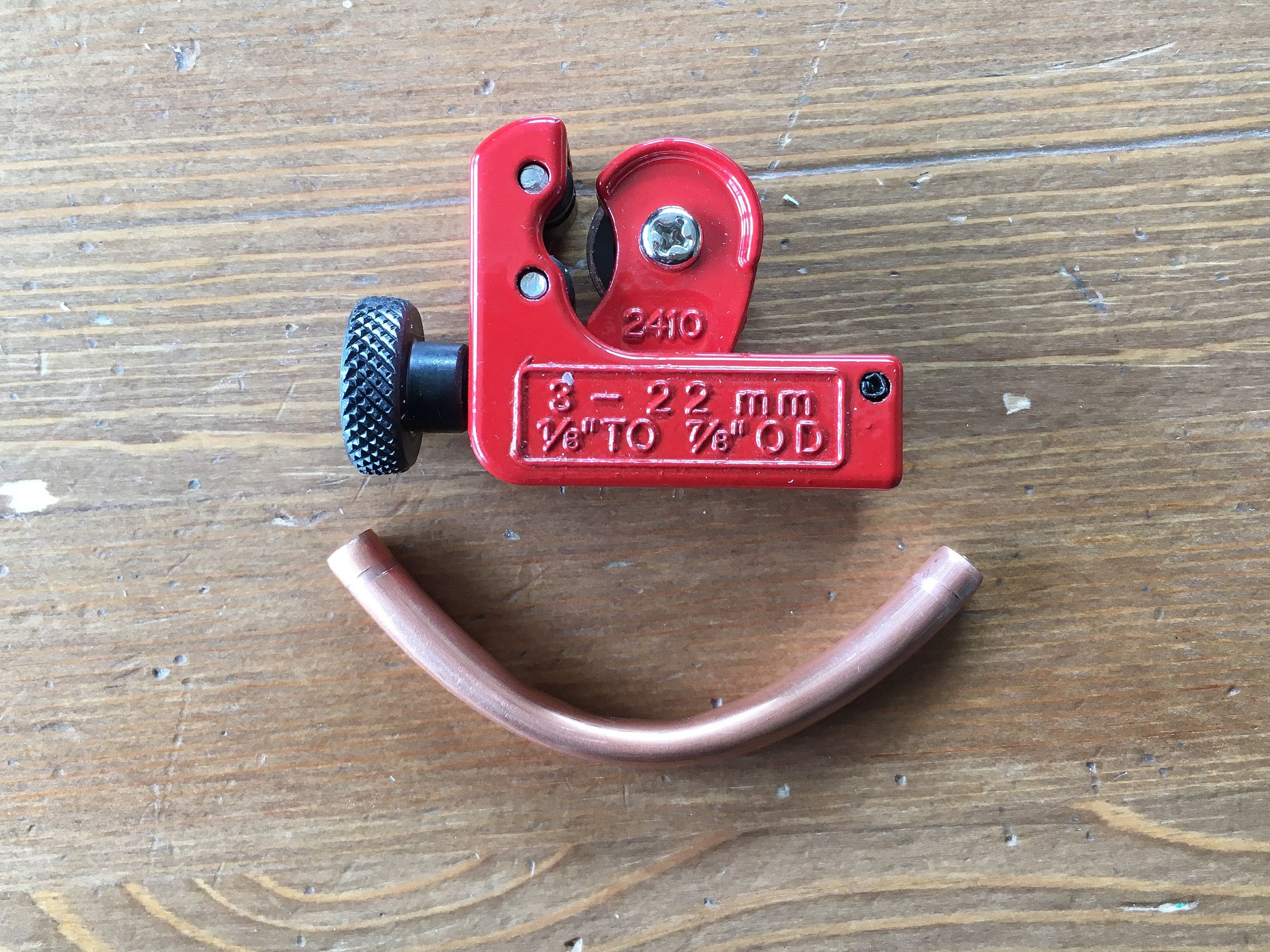

5. Keep coiling until you have gone two full rotations. The copper will be crossed at this point. Gently bend the long ends so they are as parallel as possible. The closer the two long ends are to each other the better. This will help your boat from going in circles when the steam engine is in working order. Remove the tape from both ends and dump out as much sugar as possible. Then run water through the tube to force out any extra sugar.

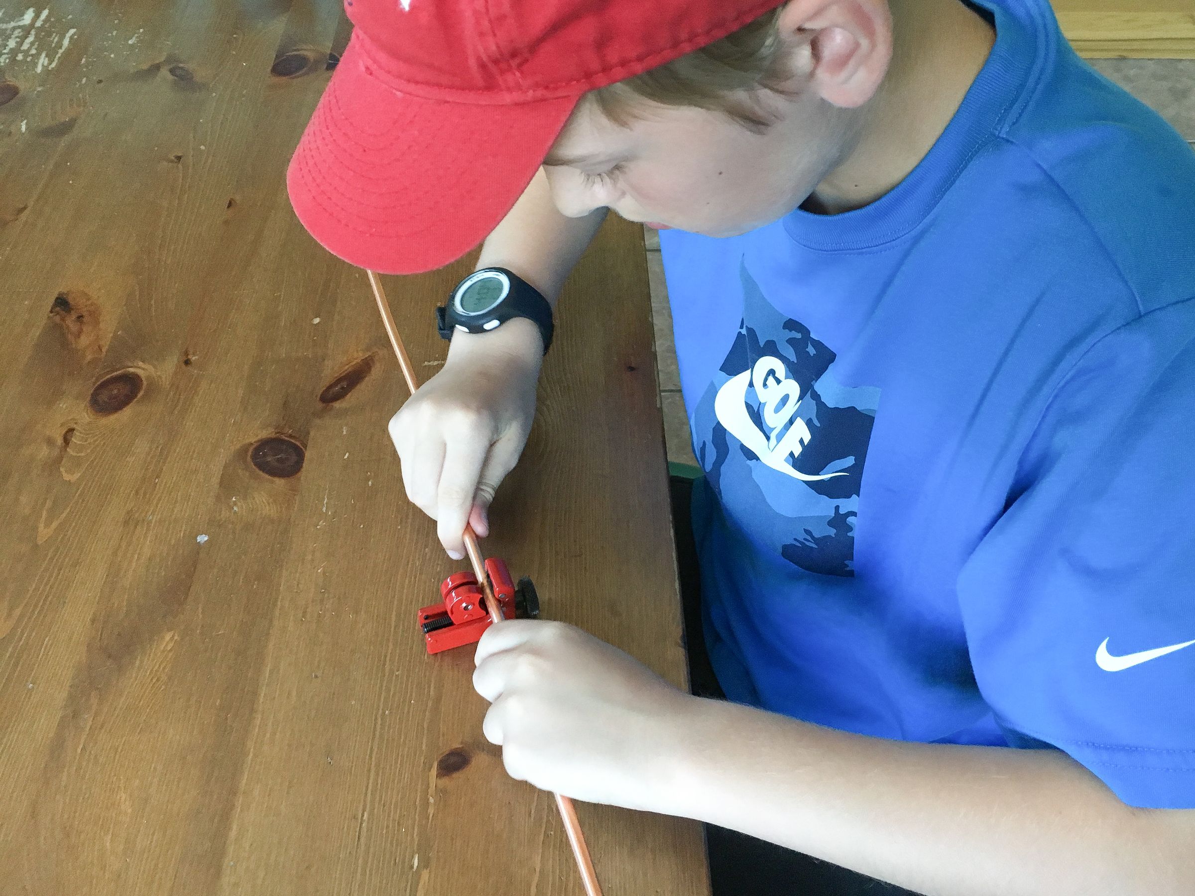

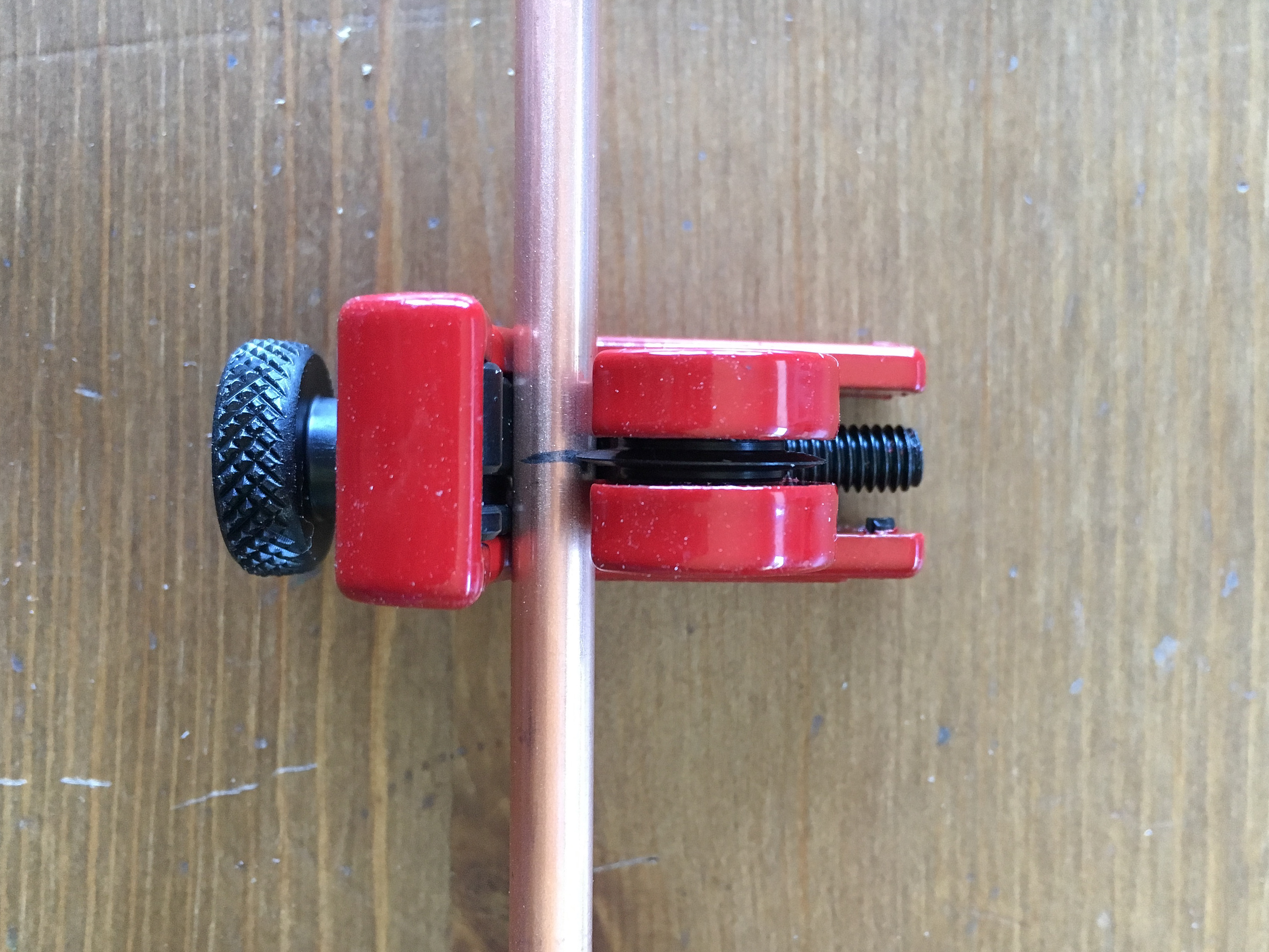

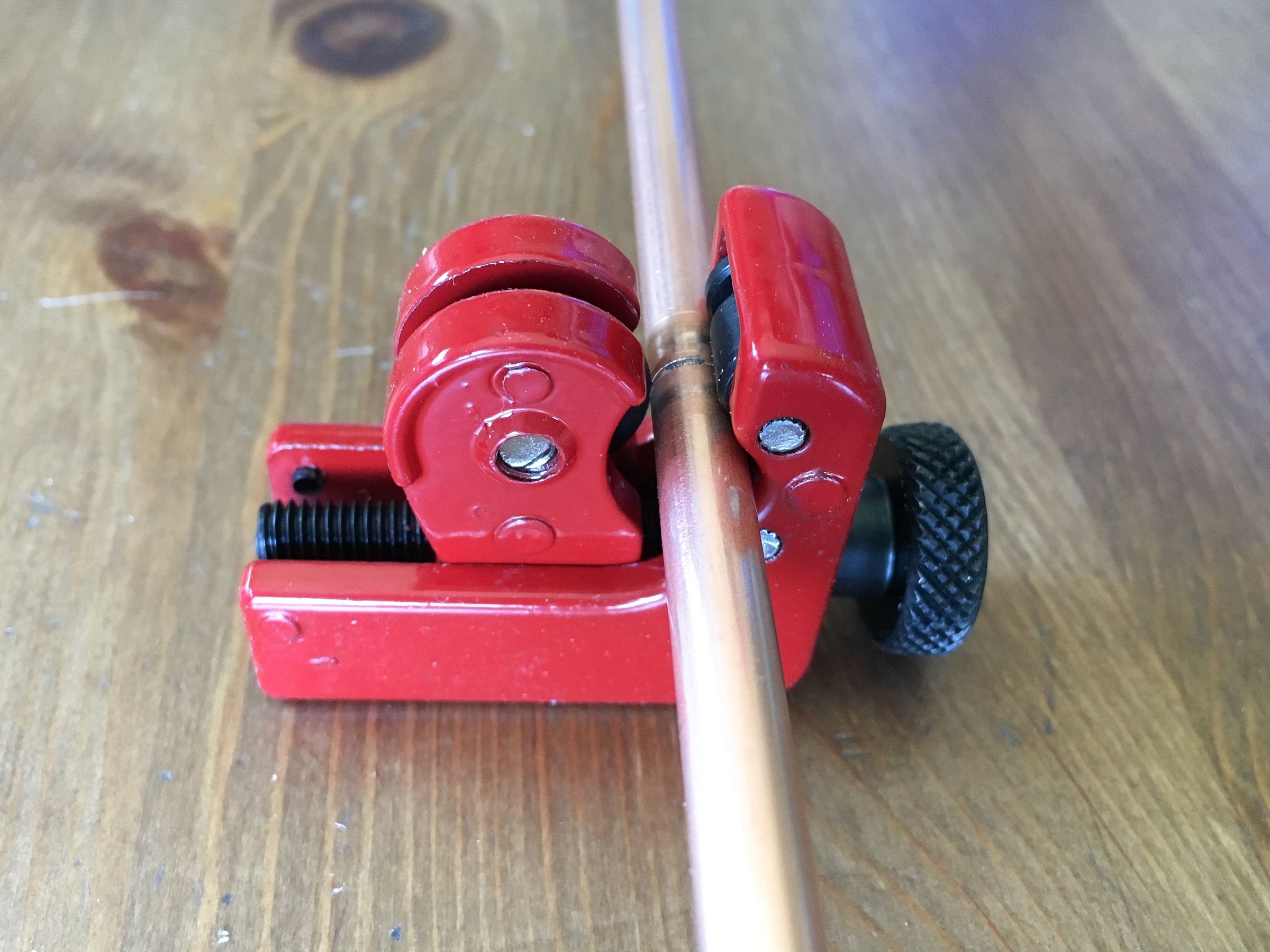

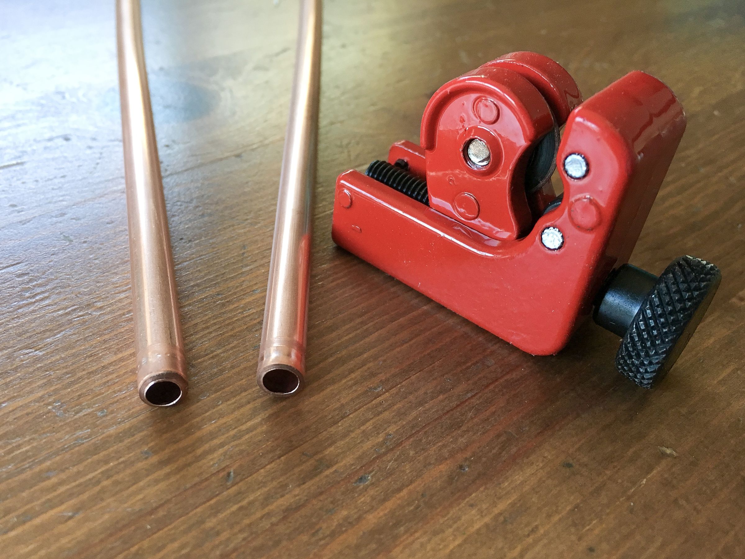

6. Using a tube cutter, cut the ends of the copper tube so they are even. (A tube cutter is a simple device that costs around $8.) This is done by placing the copper tube in the cutter and adjusting the cutting wheel to score the copper tube when twisted. Keep adjusting the wheel so it is tight against the copper tube and twist the tube again. Repeat this process until the copper is fully cut. If you know of an alternative to a tube cutter please let me know in the comments section.

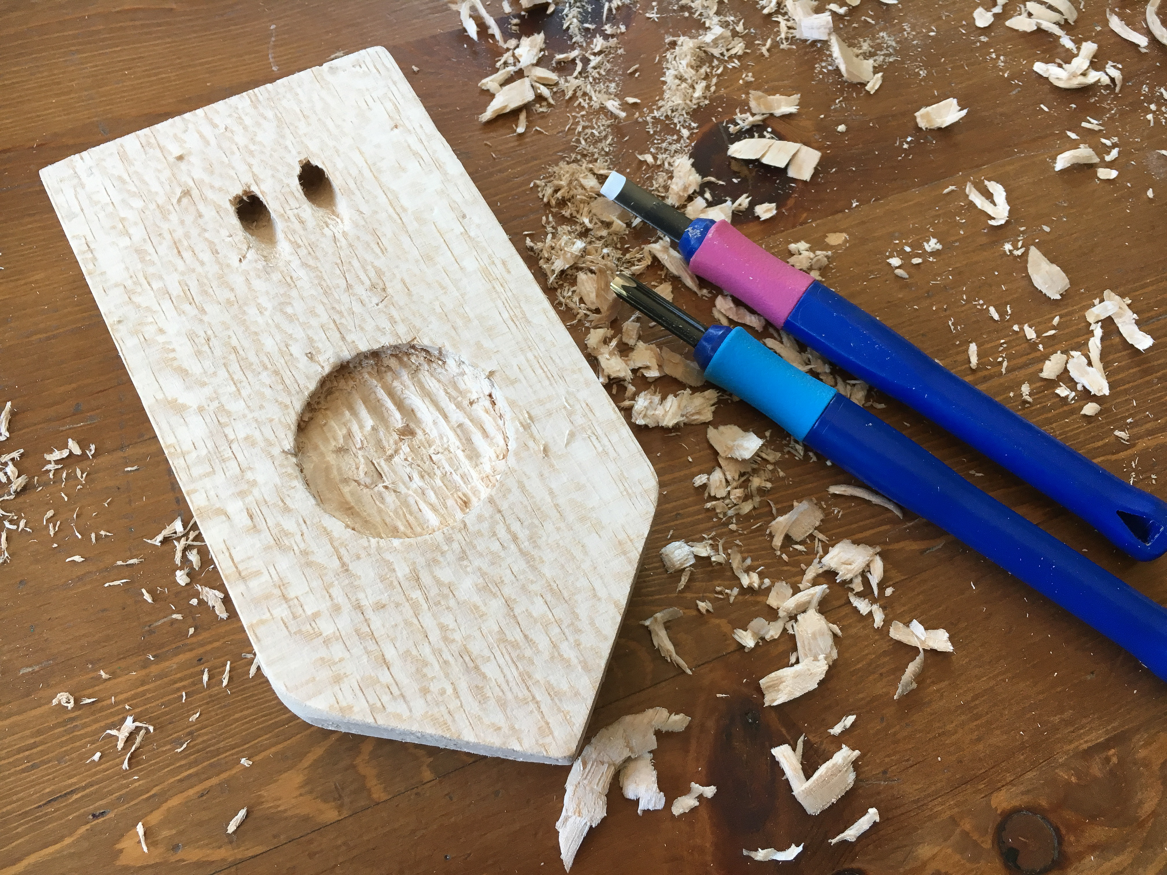

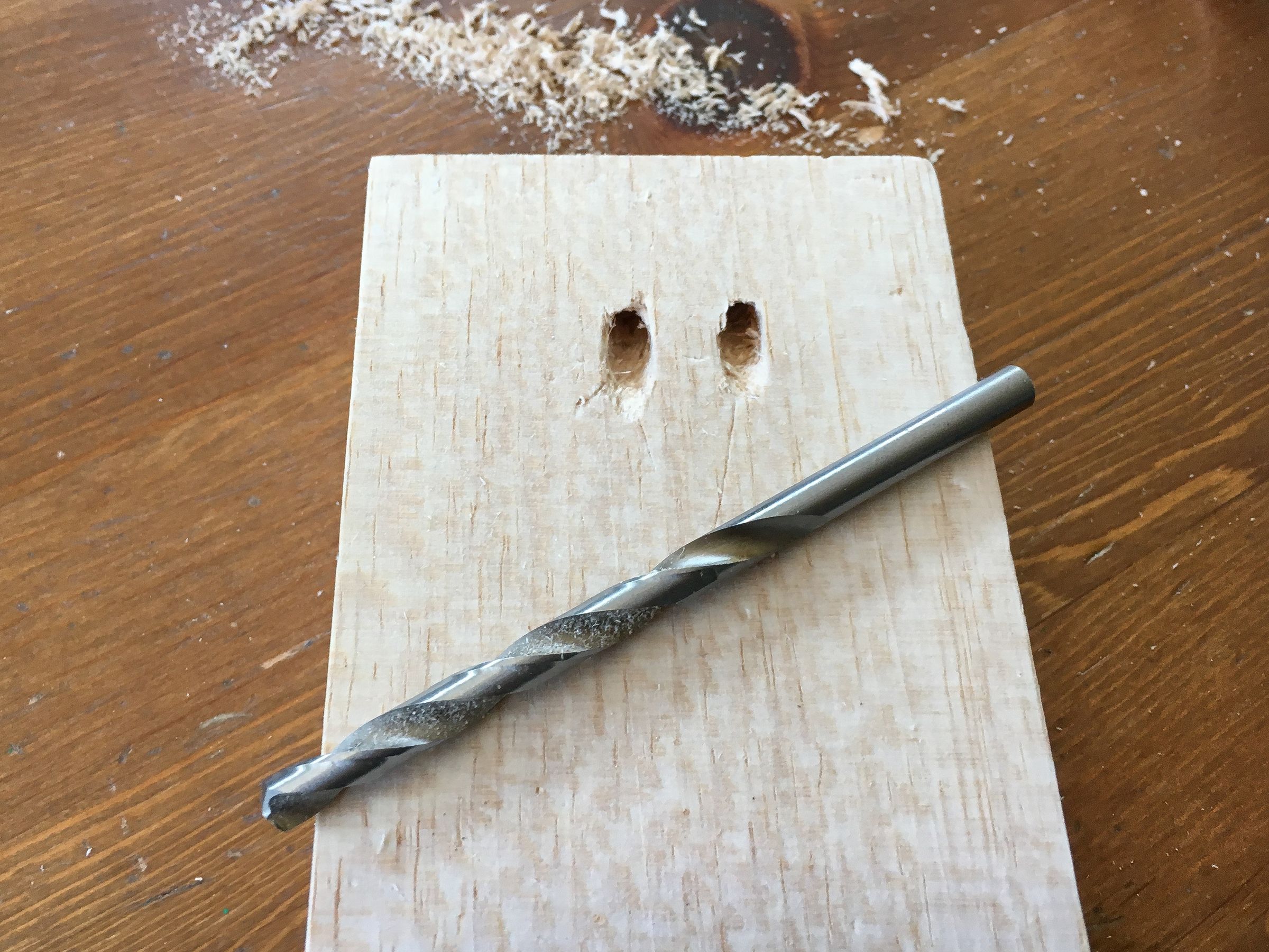

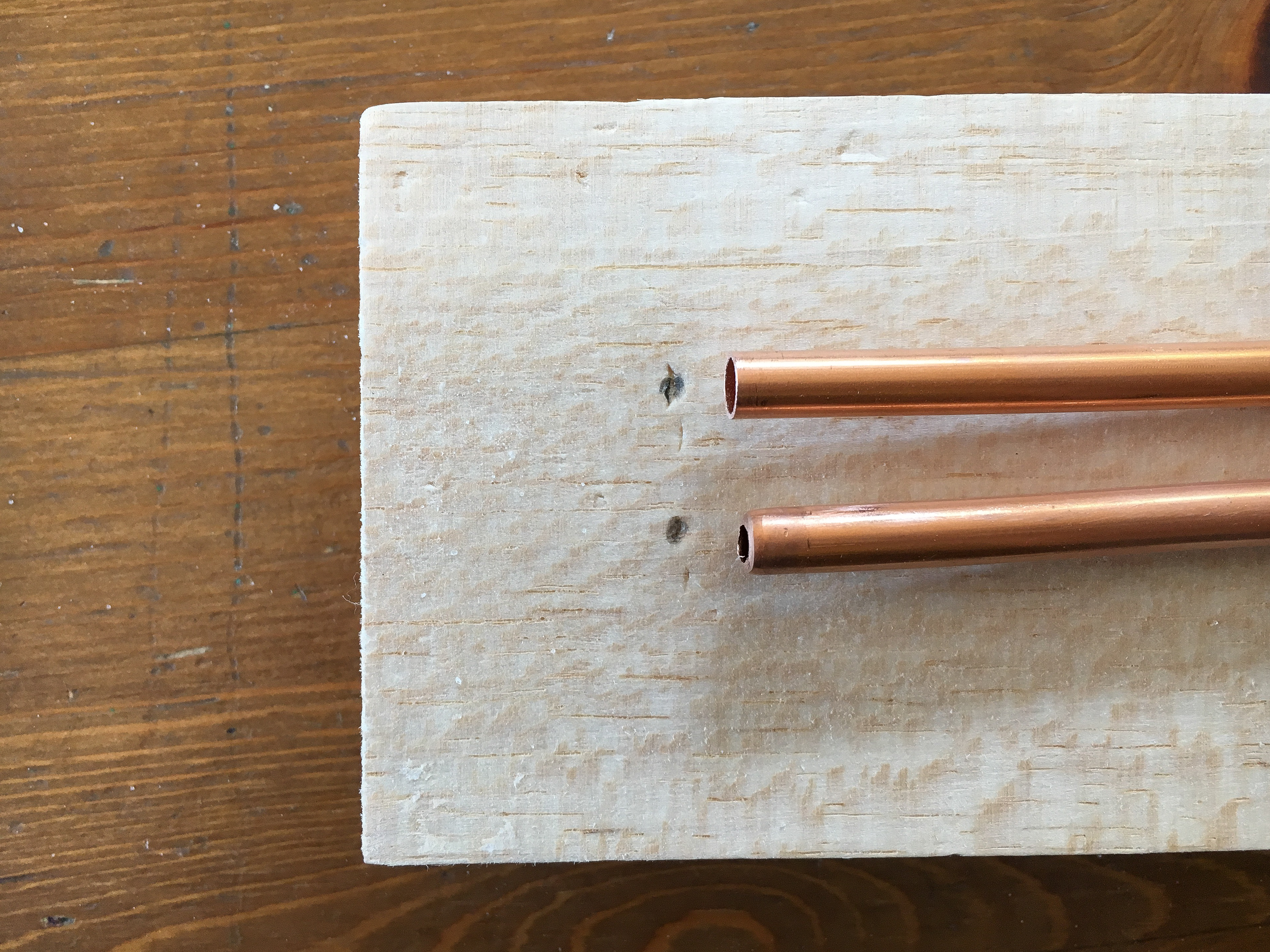

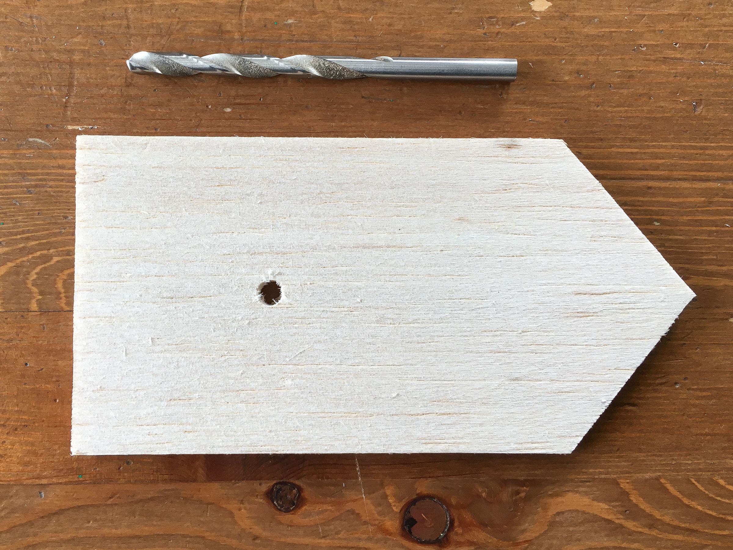

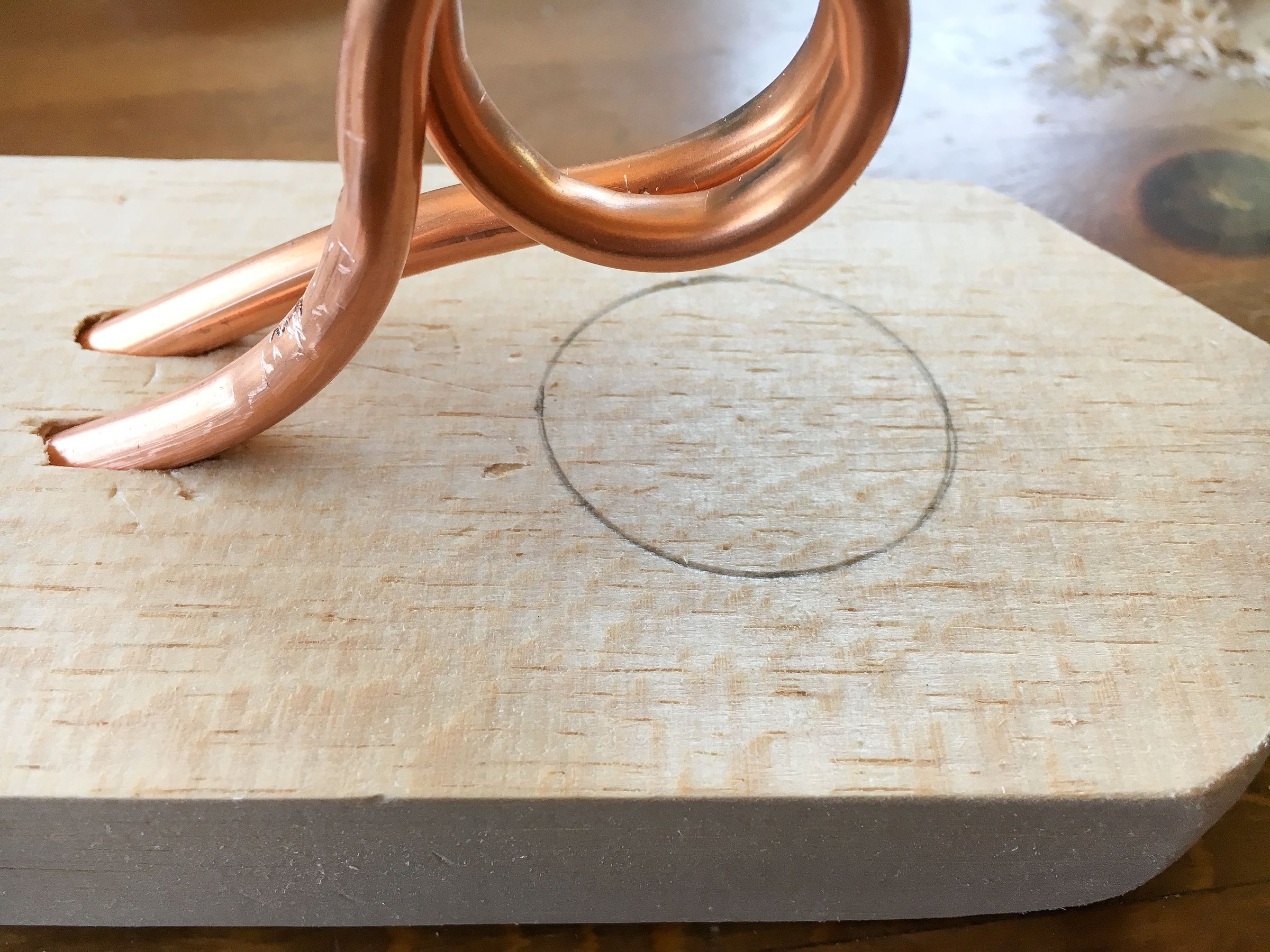

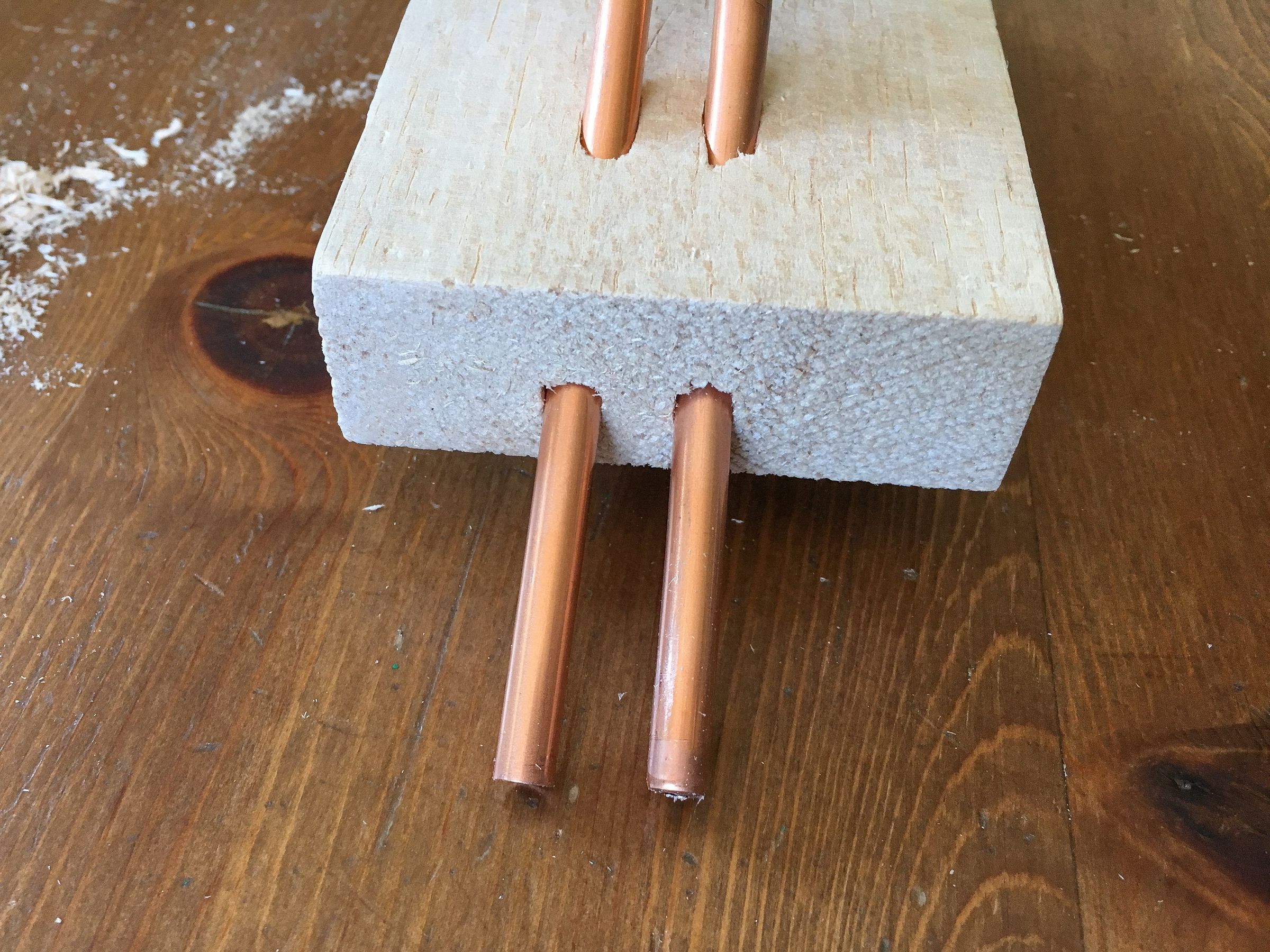

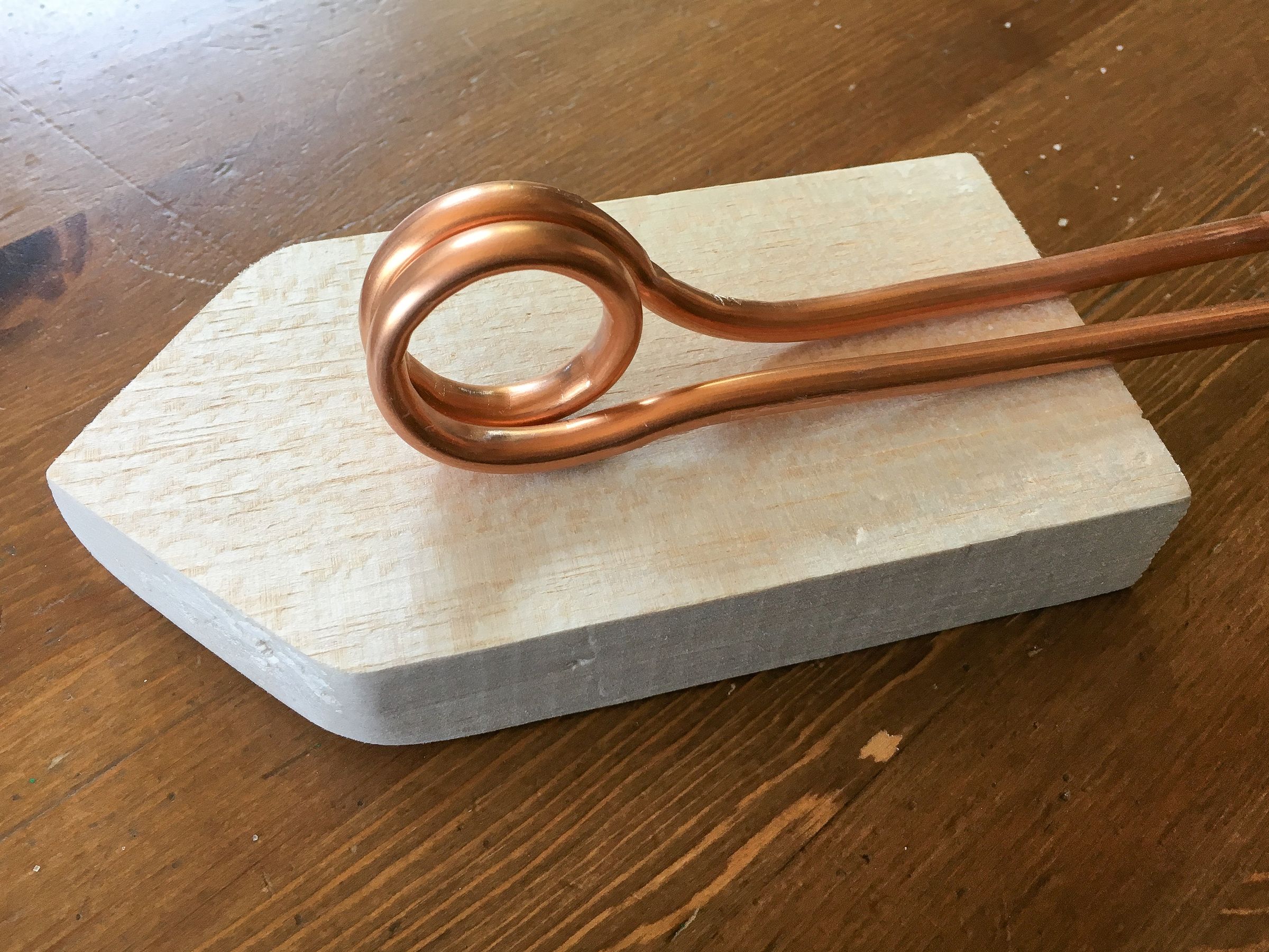

7. Once the copper is coiled and shaped appropriately use it to make small indents at the back end of the boat.

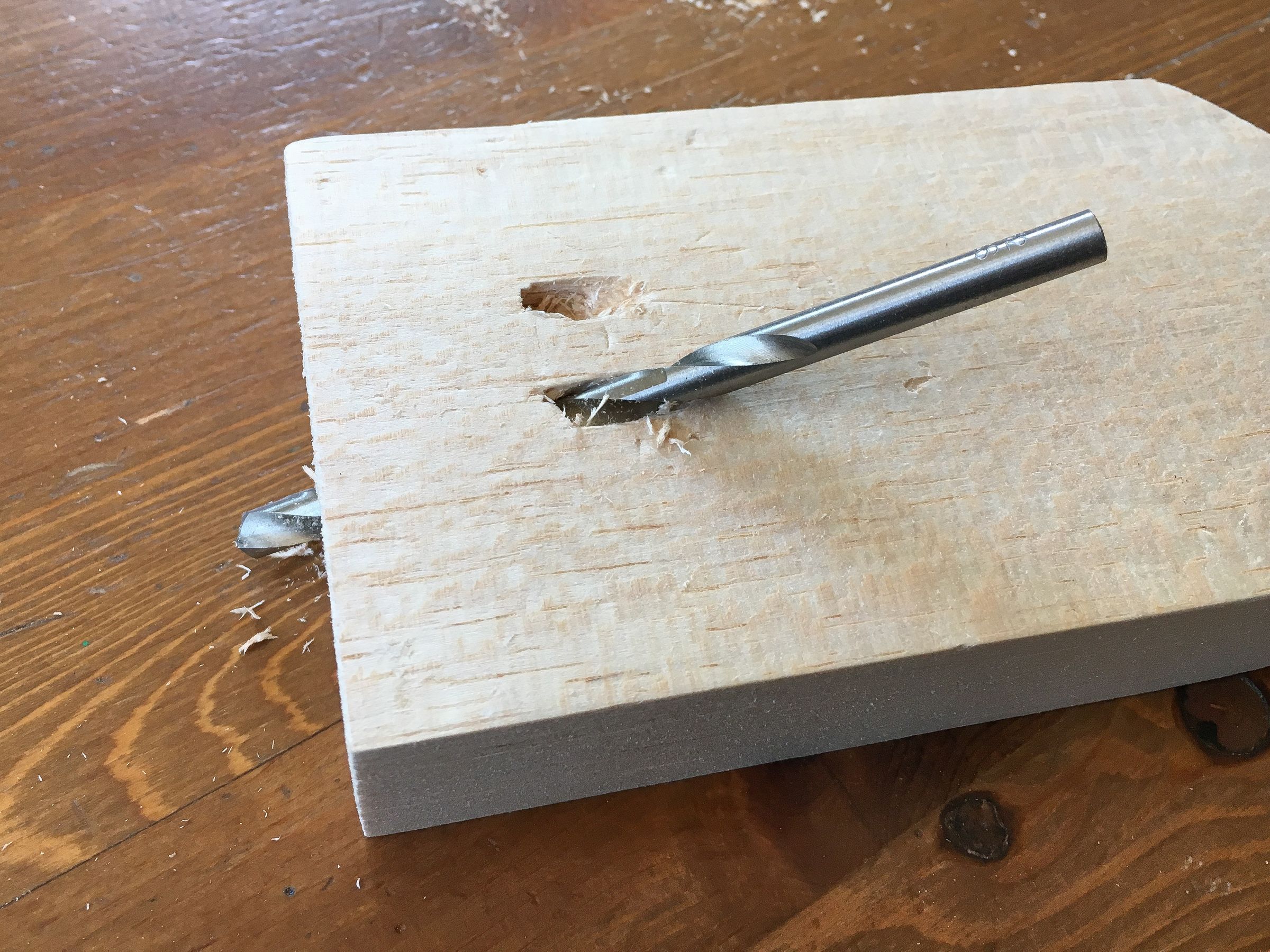

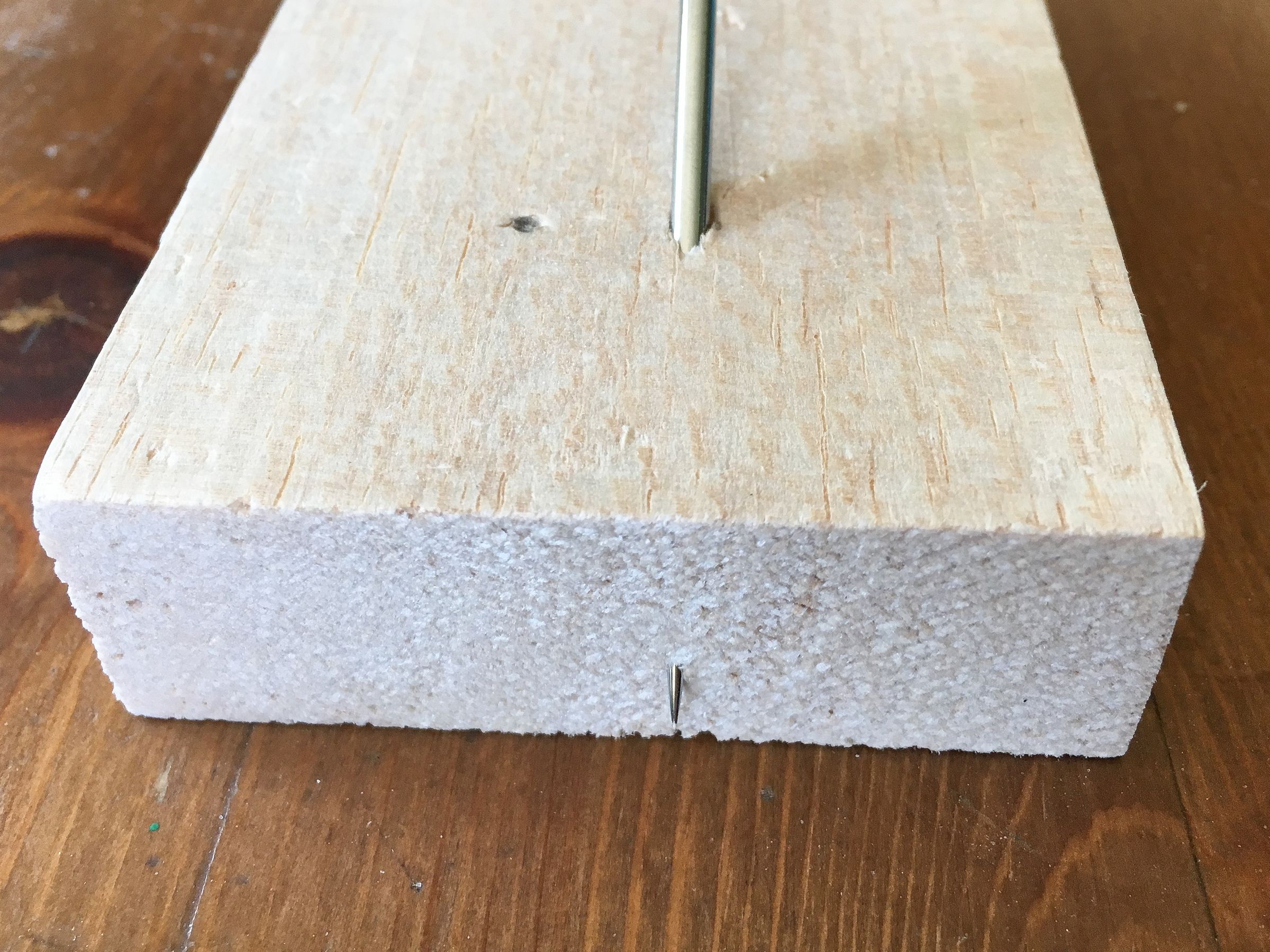

8. Using an awl poke holes (at an angle) through the top of the boat and out the back edge of the boat. The balsa wood is soft enough that this isn't difficult.
9. Once the holes are in place they will need to be widened. You can use a screw driver or a 1/4 inch drill bit. (If the kids making this project are old enough you could do this entire process with a drill. I wanted to keep power tools out of the equation for the age group (7-10 year olds) I was working with.) Twist the drill bit back and forth through the awl holes to widen them. Again, the wood is soft enough this doesn't take much effort. If the drill bits are sharp enough this still poses a cutting hazard. Inform the students to use care with a drill bit as to not cut themselves.
10. Insert the copper tube into the holes. They should fit snugly.

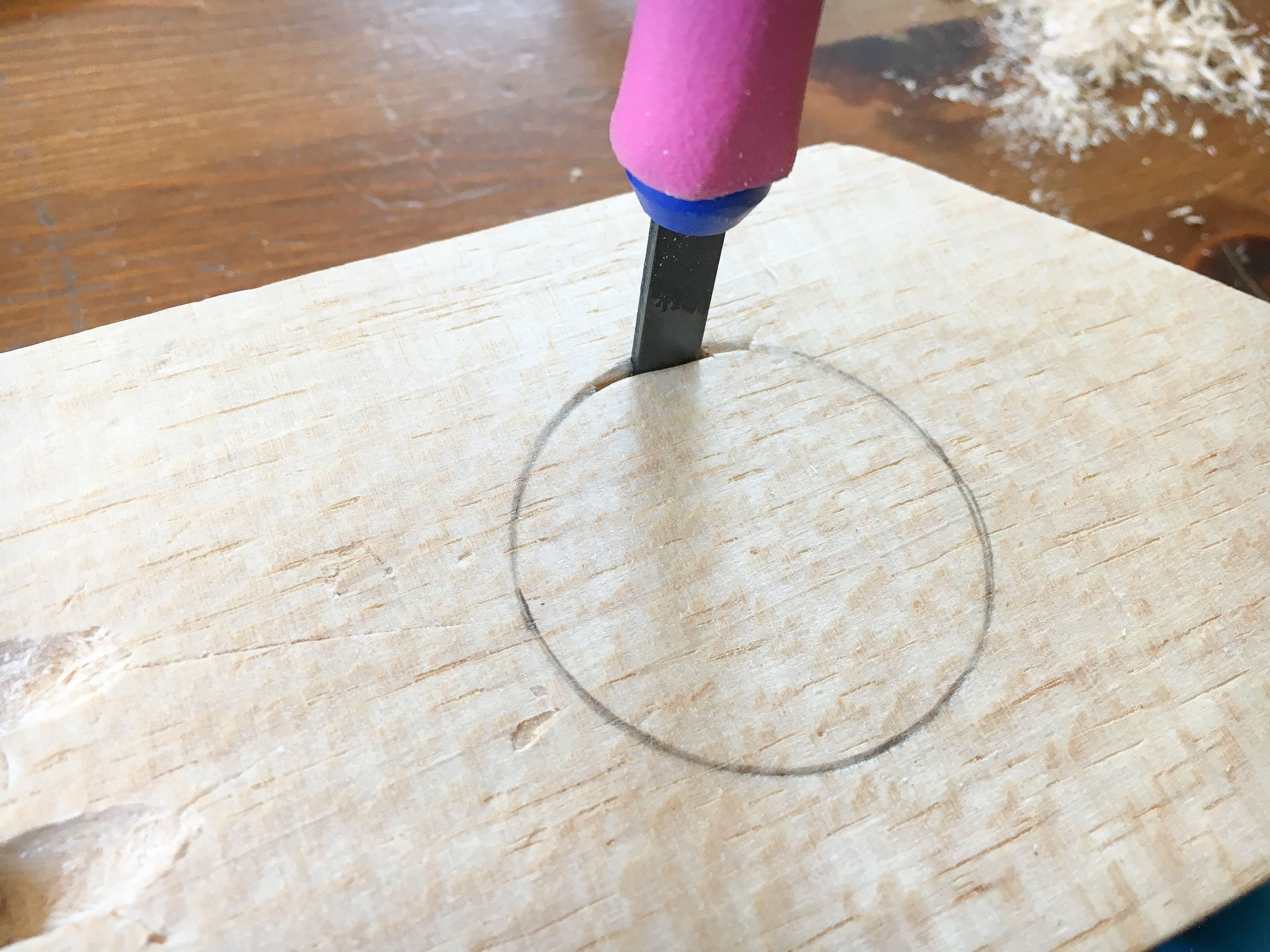

CARVING AND LIGHTING

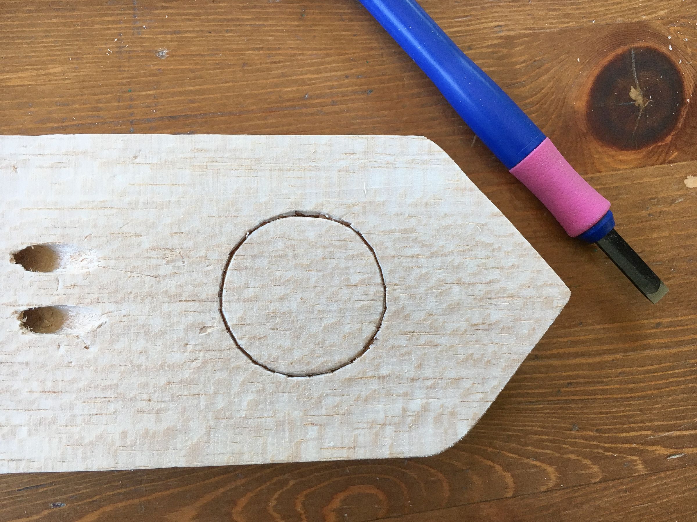

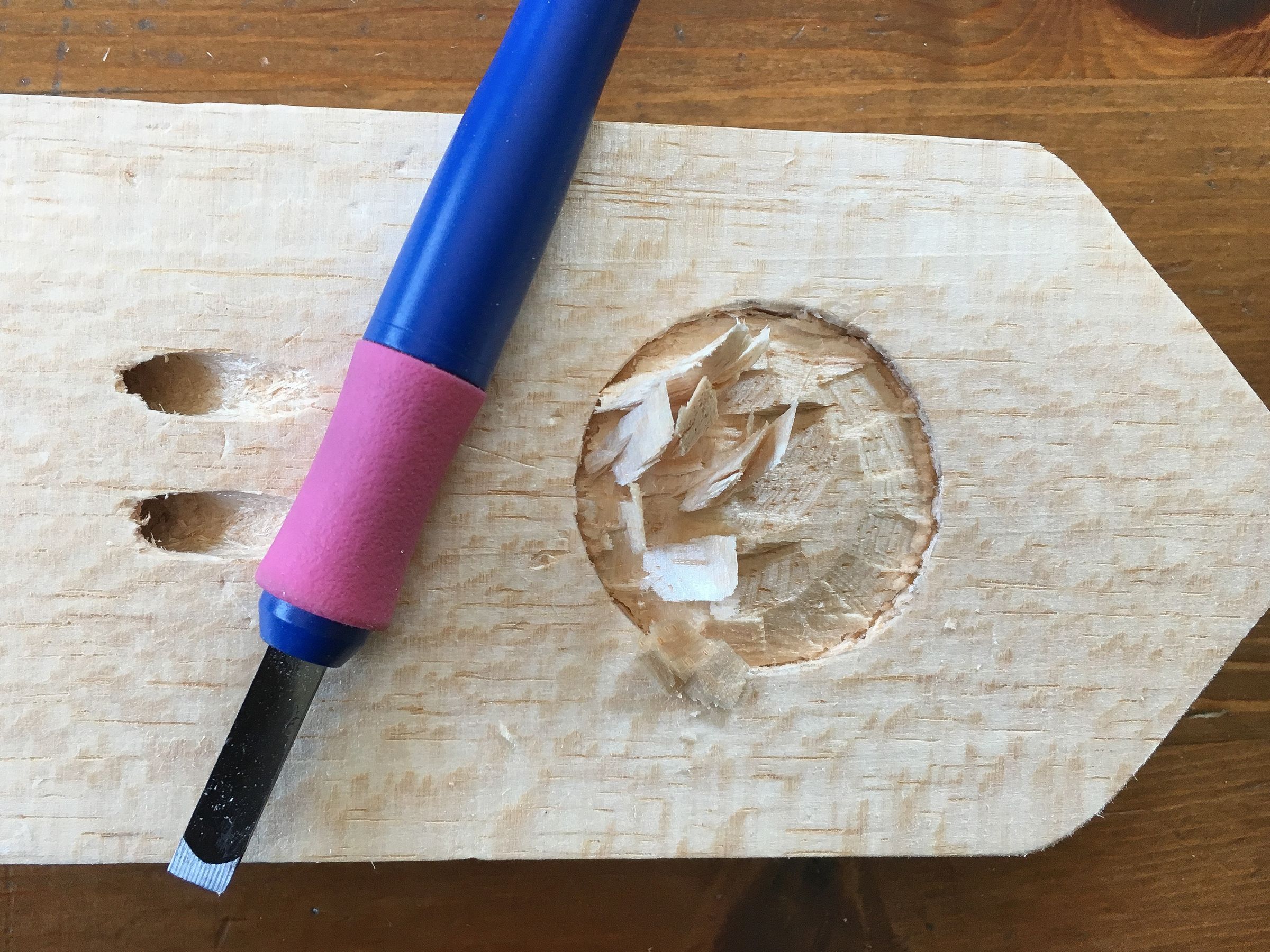

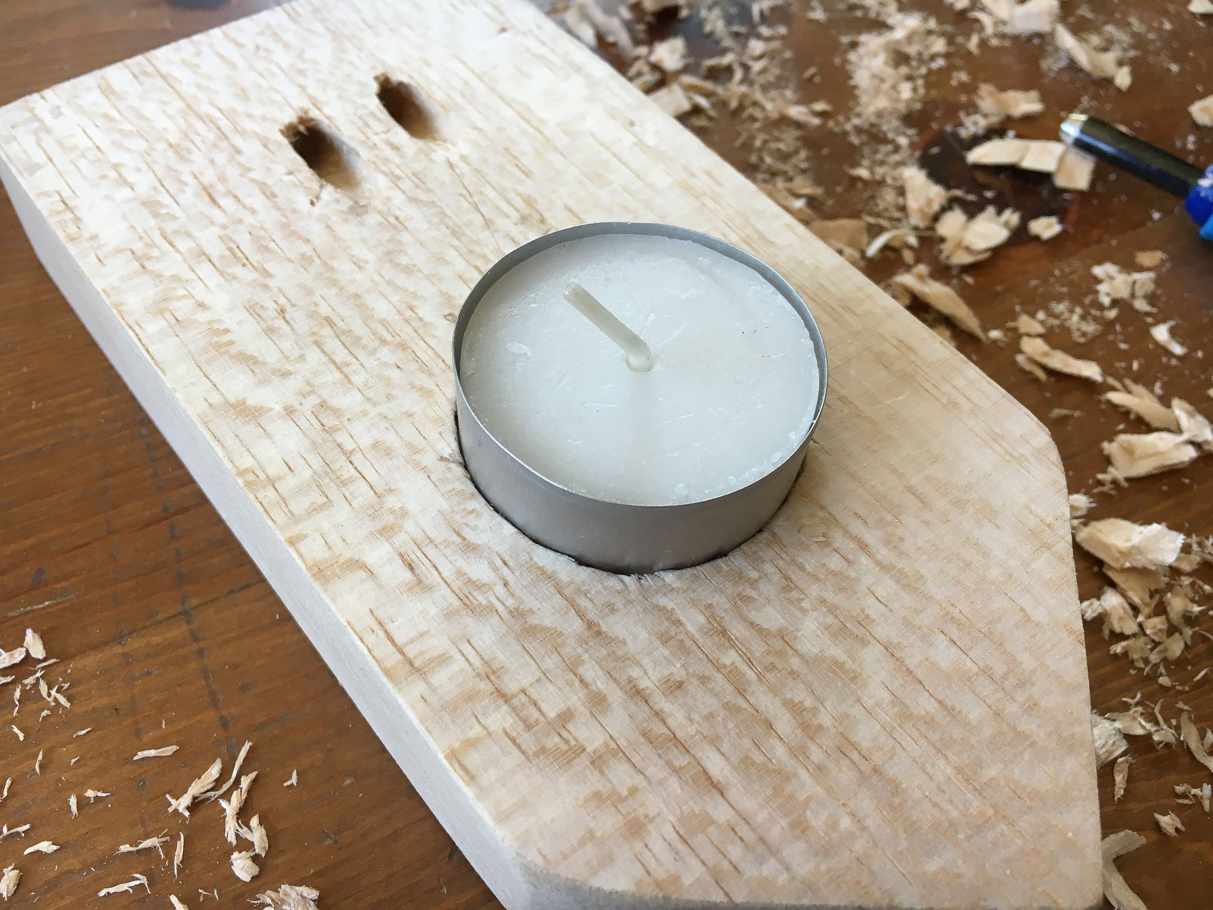

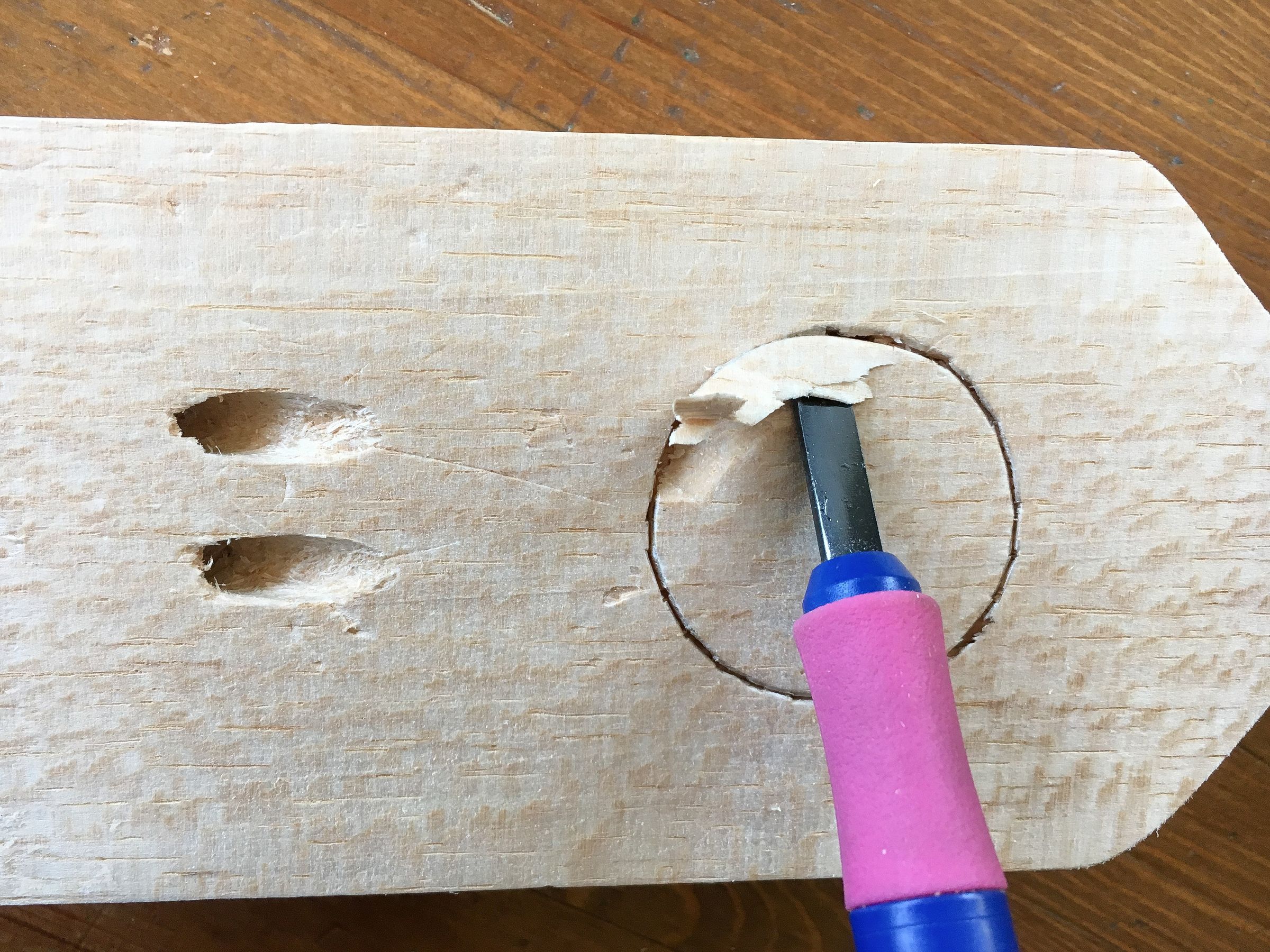

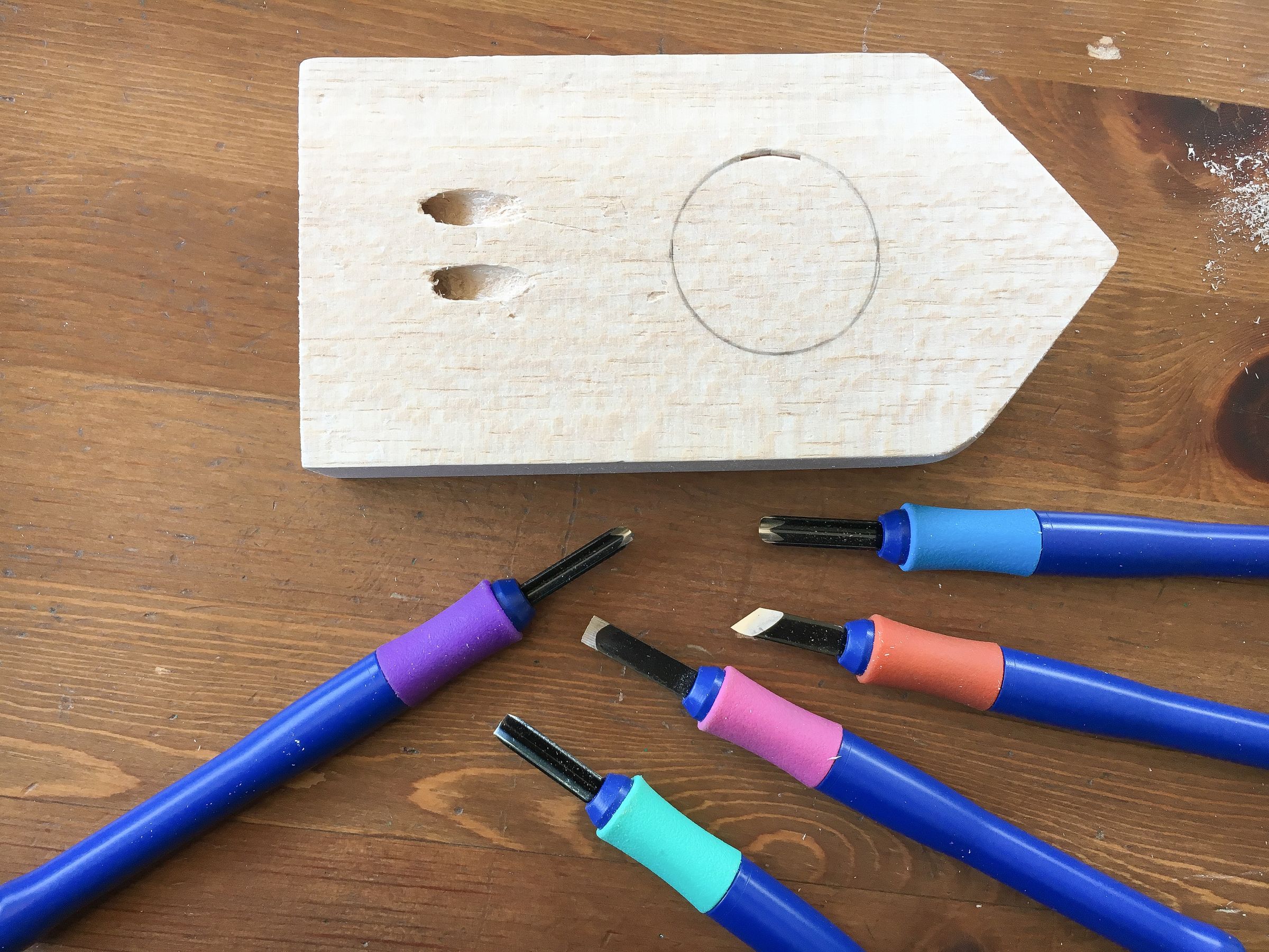

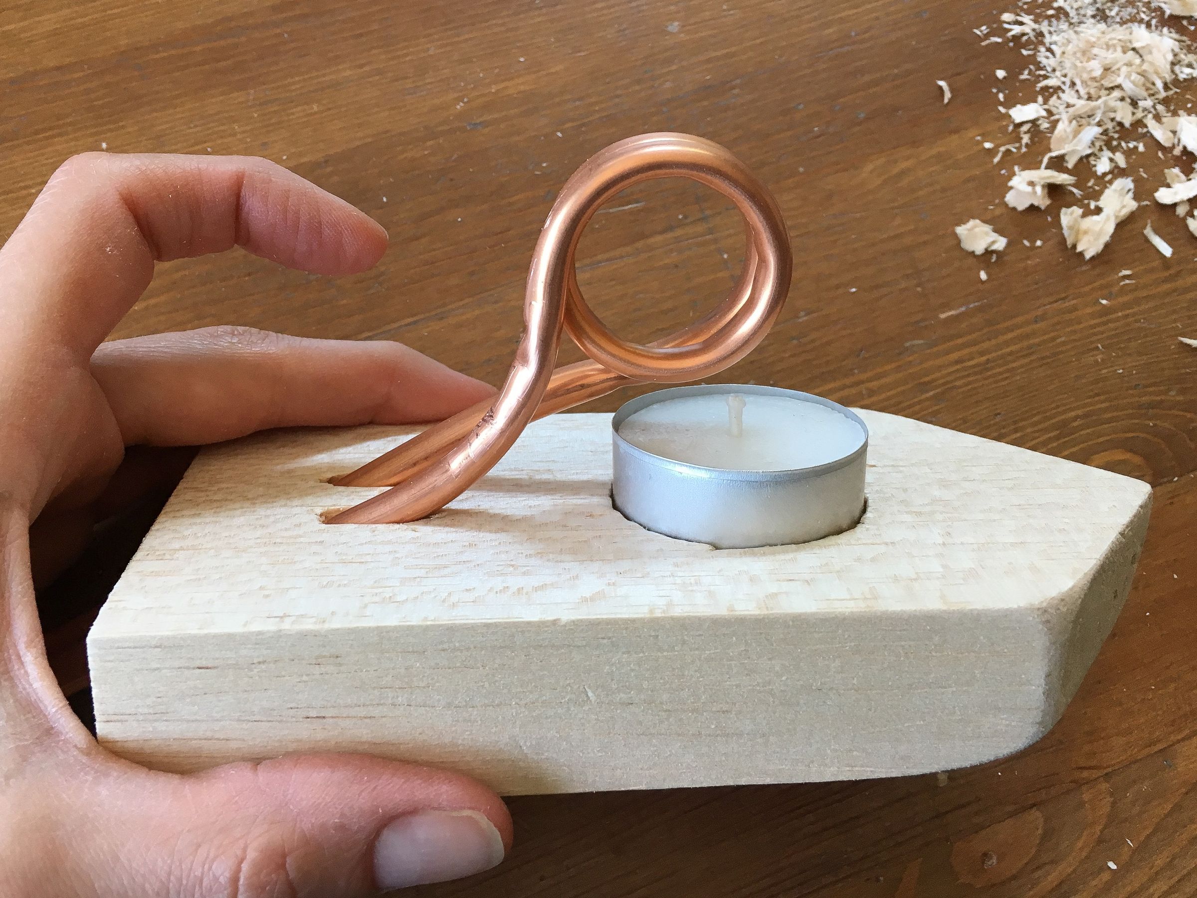

1. Once the copper tubes are in place set a tea light candle on the top of the boat lining up the edge of copper coil with the wick of the candle. Draw a line on the wood around the candle base. Remove the copper tube from the boat.
2. Using carving tools cut away a shallow layer of wood where the candle will sit. Again, caution should be used with carving tools. Let students know they should always cut AWAY from themselves (and their hands). Balsa is so soft this takes minimal effort.
3. Place the copper tube back into the boat. Turn upside down and fill the copper tube under running water. Place the boat in a pool, bathtub, sink, etc. and set the candle in place. Light the candle and watch your boat putt putt away! It takes a few minutes for the water to heat enough to create steam so be patient! If you find that the boat still isn't moving, check to make sure the candle flame is heating both coils evenly. If they are not heated evenly the boat might have problems going.

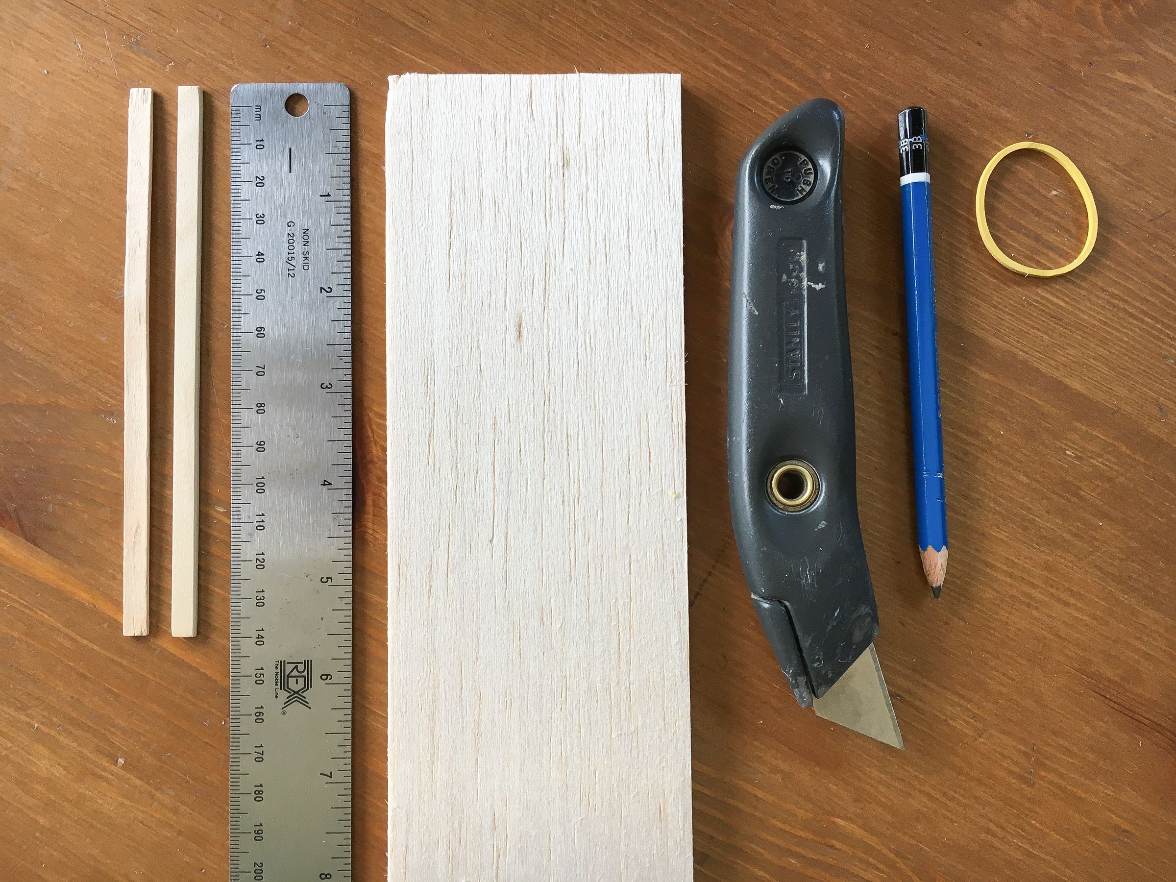

MATERIALS
You will need the following materials and tools to create a paddle boat:
  • 8.5x3x1 inch balsa wood block
  • Ruler
  • Utility Knife
  • Pencil
  • Craft Stick
  • 1 1/2 inch rubber band
  • Small flat head screwdriver (not pictured)

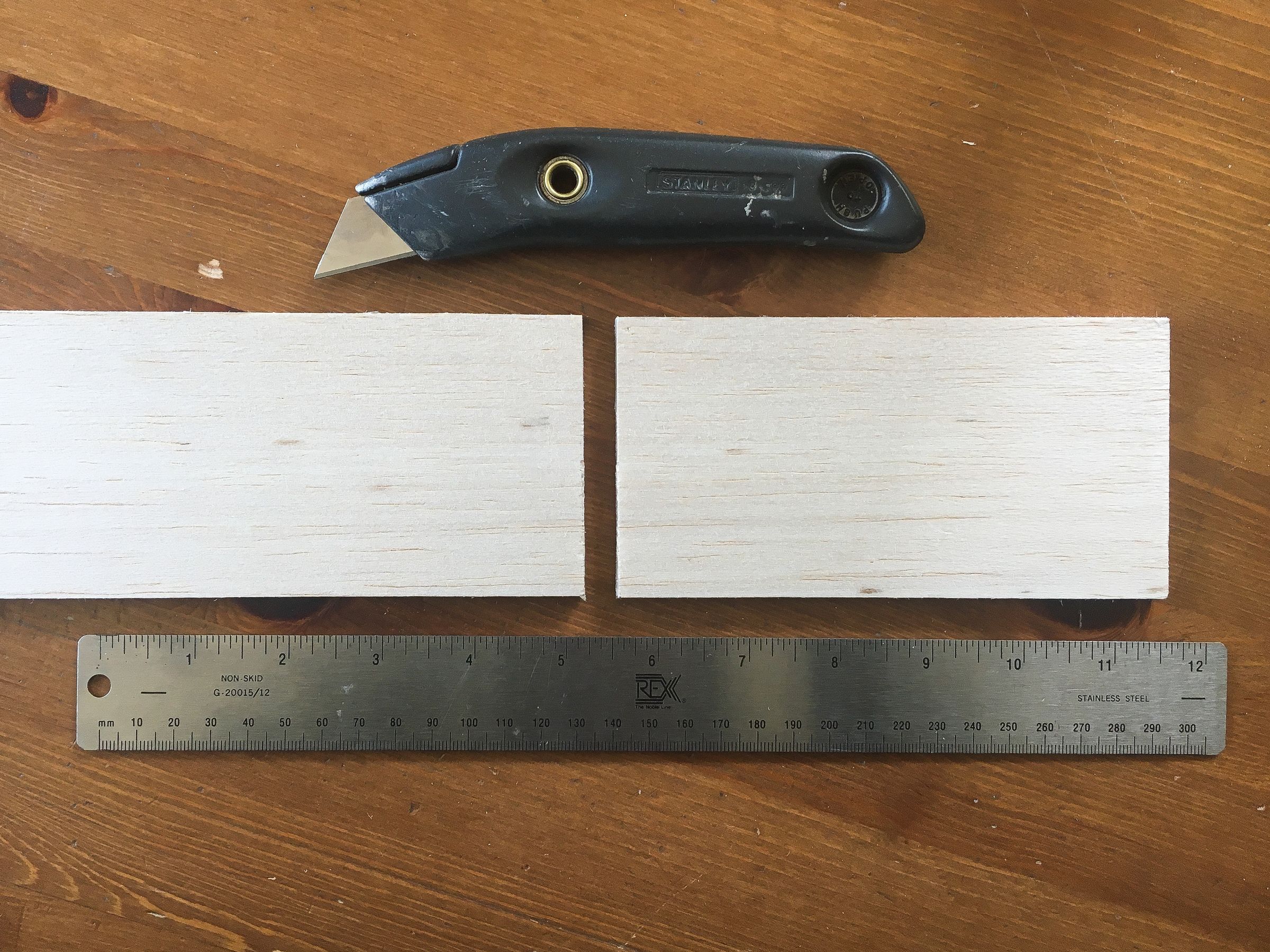

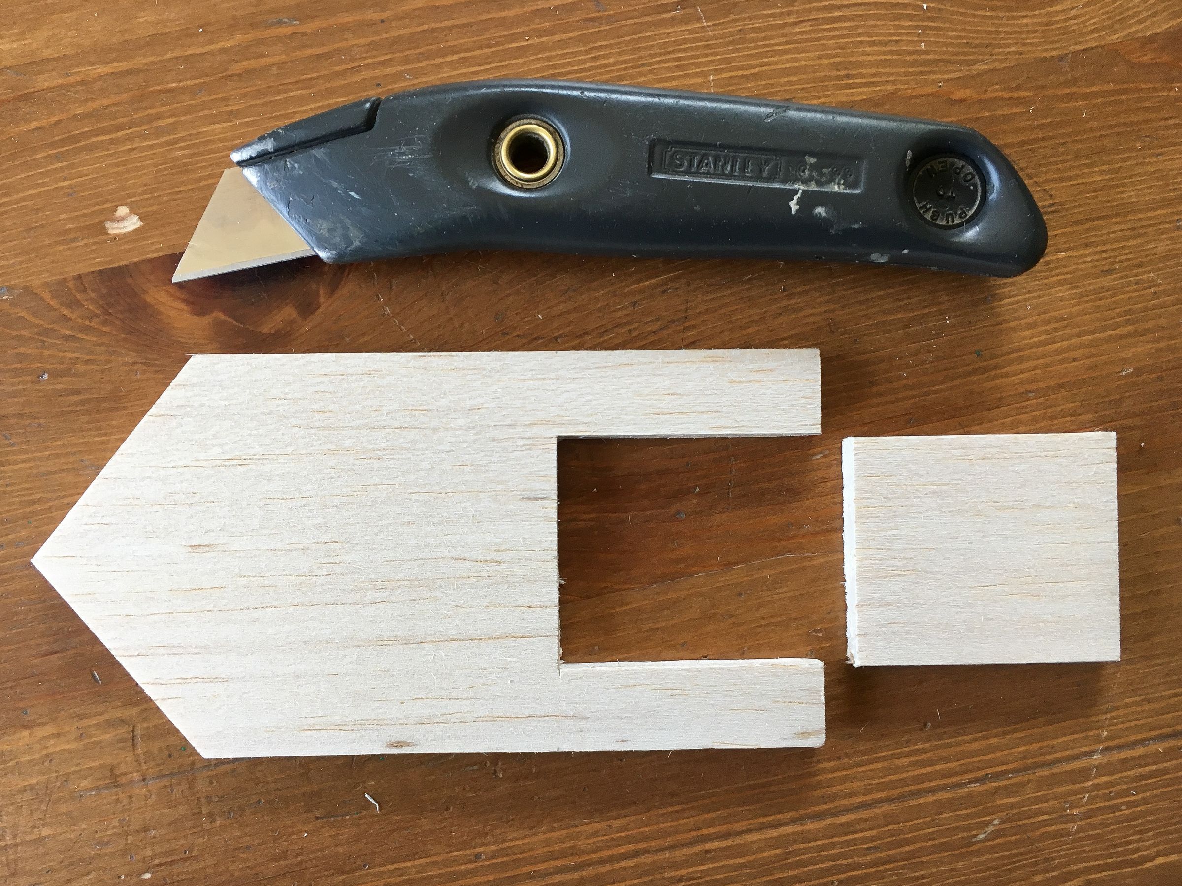

CUTTING THE BOAT SHAPE

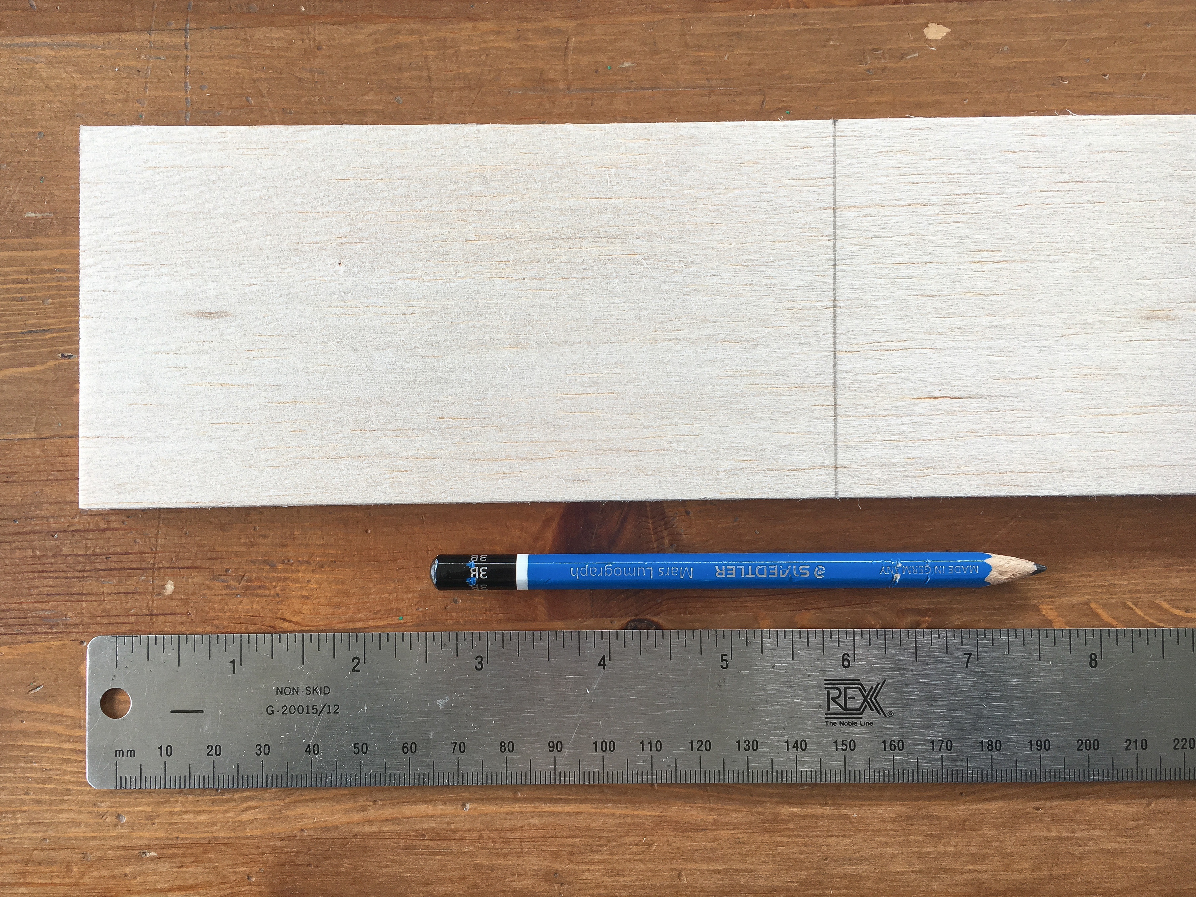

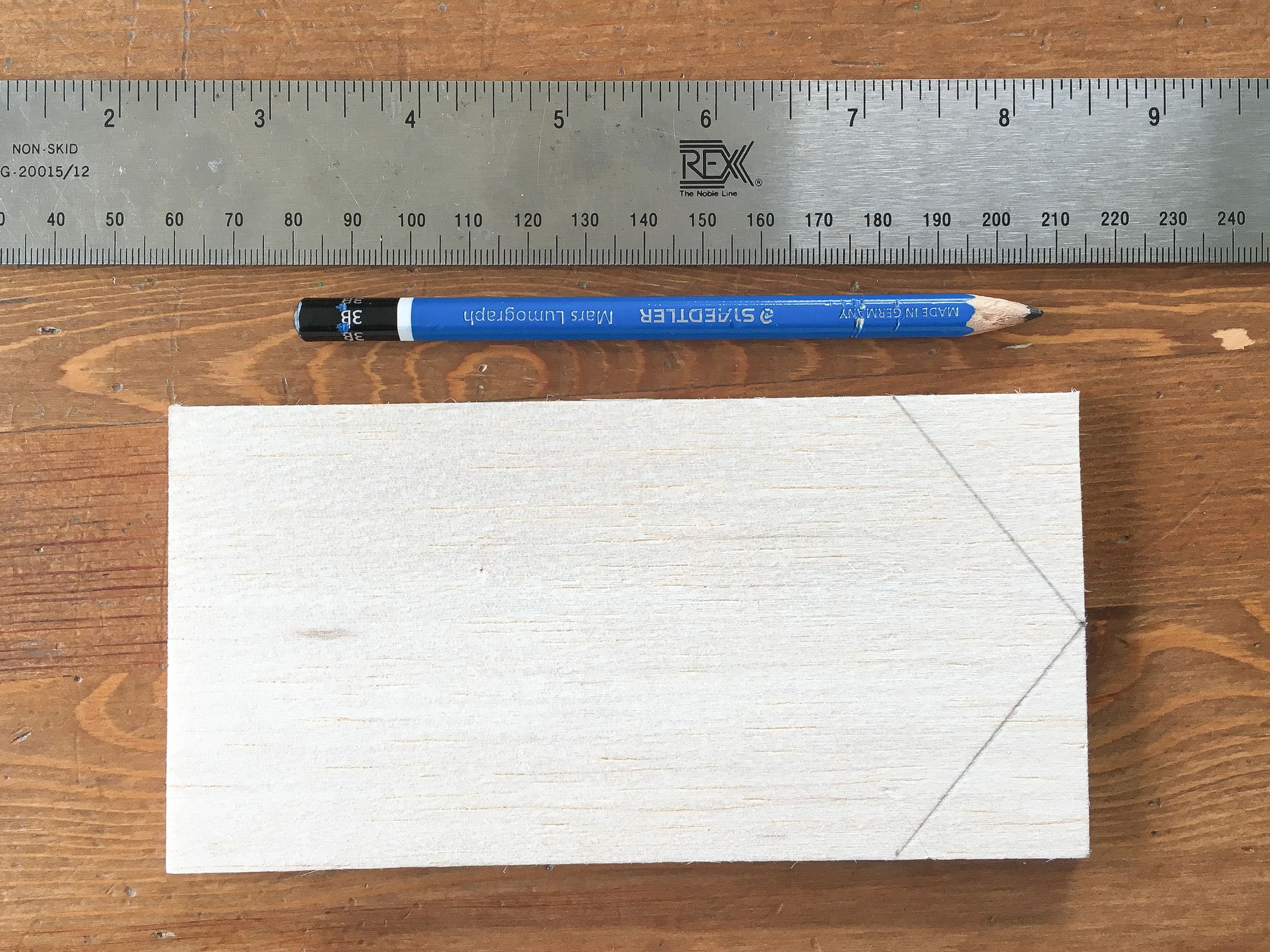

1. Using a pencil and a ruler mark off a section that is 6 inches in length and cut the wood using a utility knife and a ruler. Make shallow passes through the wood. Don't try to cut through the entire thickness in the first pass. You won't end up with clean cuts. :(
2. Make a mark in the middle at one end of the block. Measure down 1 1/4 inches on each sides and draw lines to match up the middle and the side marks. We are making a pointed end for the front of the boat.

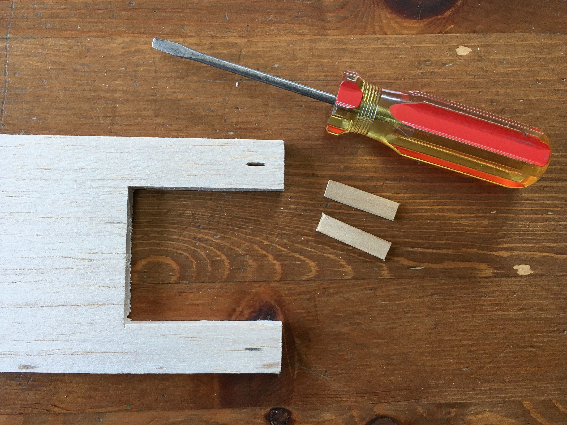

4. On the back end of the boat draw a guide line that is 2 inches in length and 1 1/2 inches wide. This will leave 3/4 inches on each side of the boat. Cut this part out of the boat using a utility blade. For the two longer cuts you will be cutting with the grain of the balsa wood. Go slow as to now split the wood where you don't want it split! This is the point where this boat could become a STEAM project instead of a STEM project. Have students paint the boat or add a decorative sail.

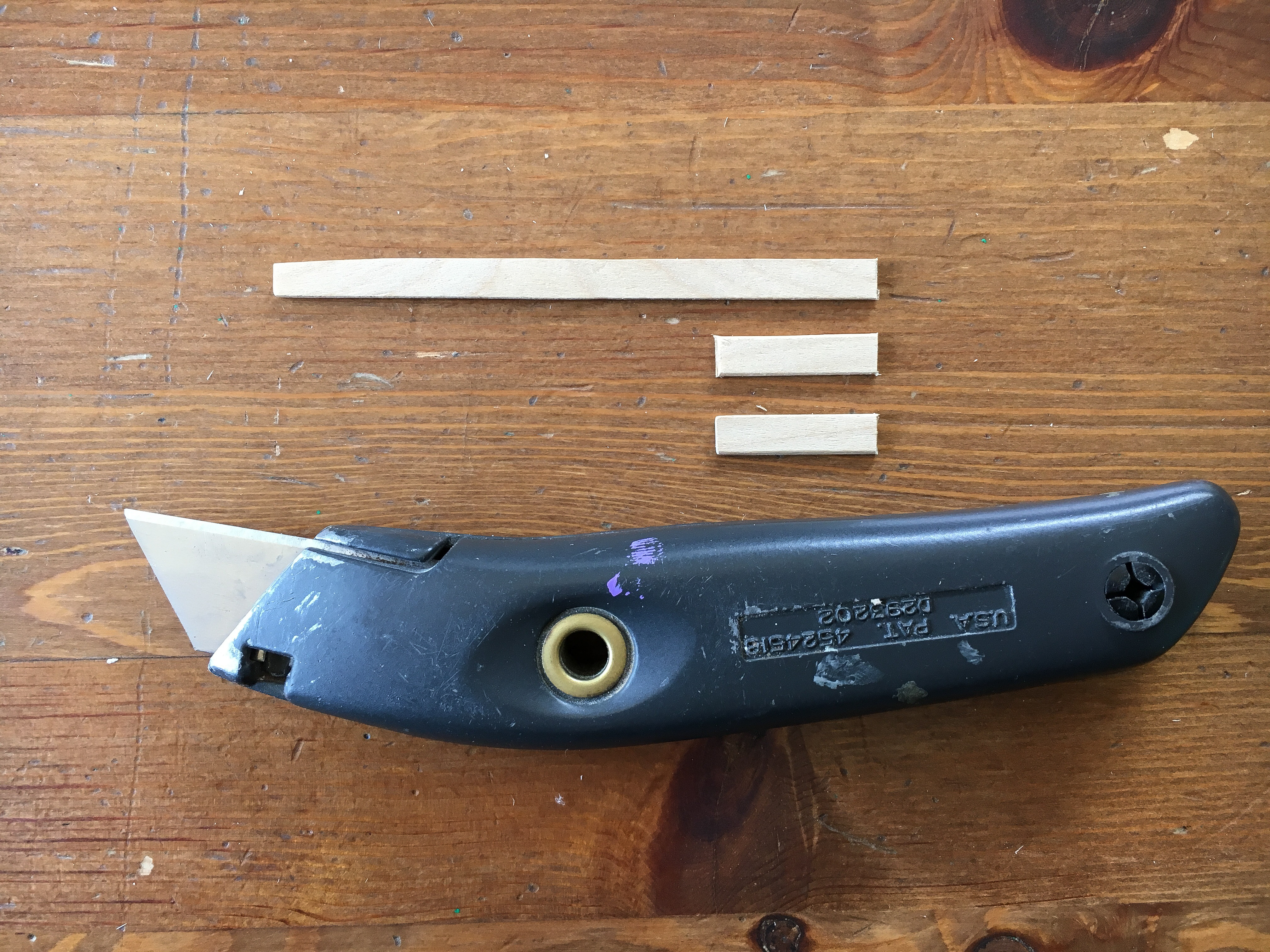

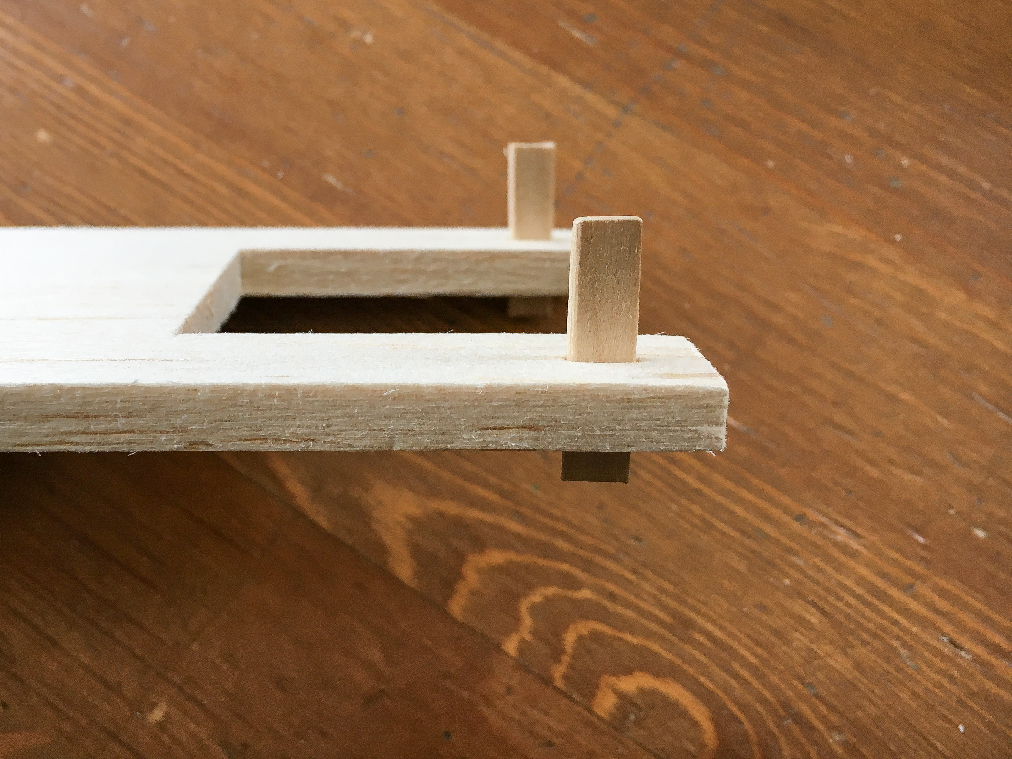

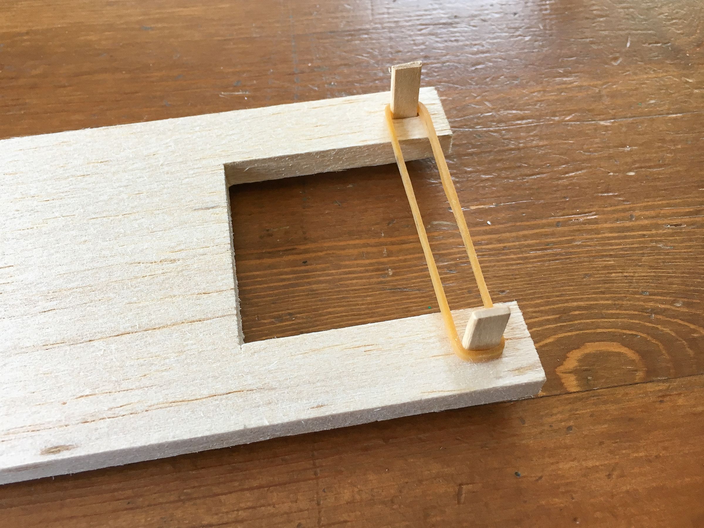

MAKING & INSERTING THE SECURITY PEGS

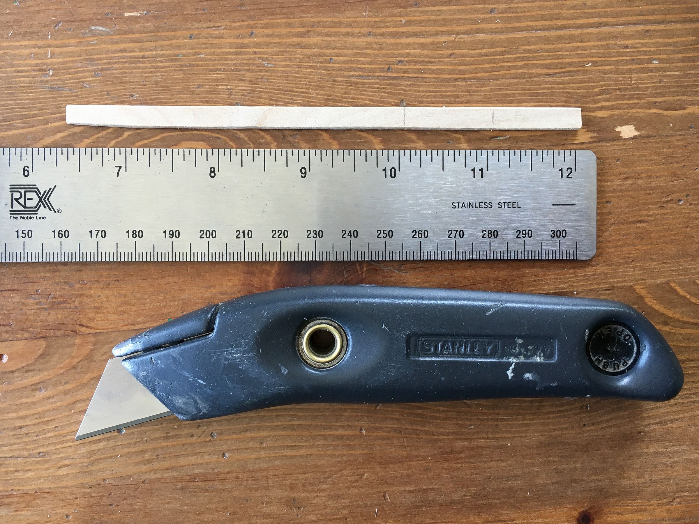

1. Using a utility knife, cut two, one-inch pieces from a craft stick.
2. Mark two lines on the back to ends of the boat and make holes using a screwdriver. Press the craft sticks through the holes until 1/4 inch is sticking out the bottom and 1/2 inch is visible on the top of the boat.

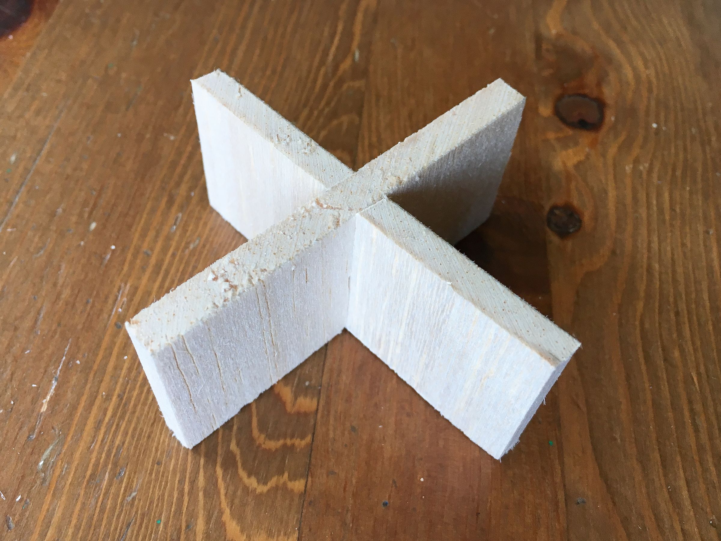

MAKING THE PADDLE

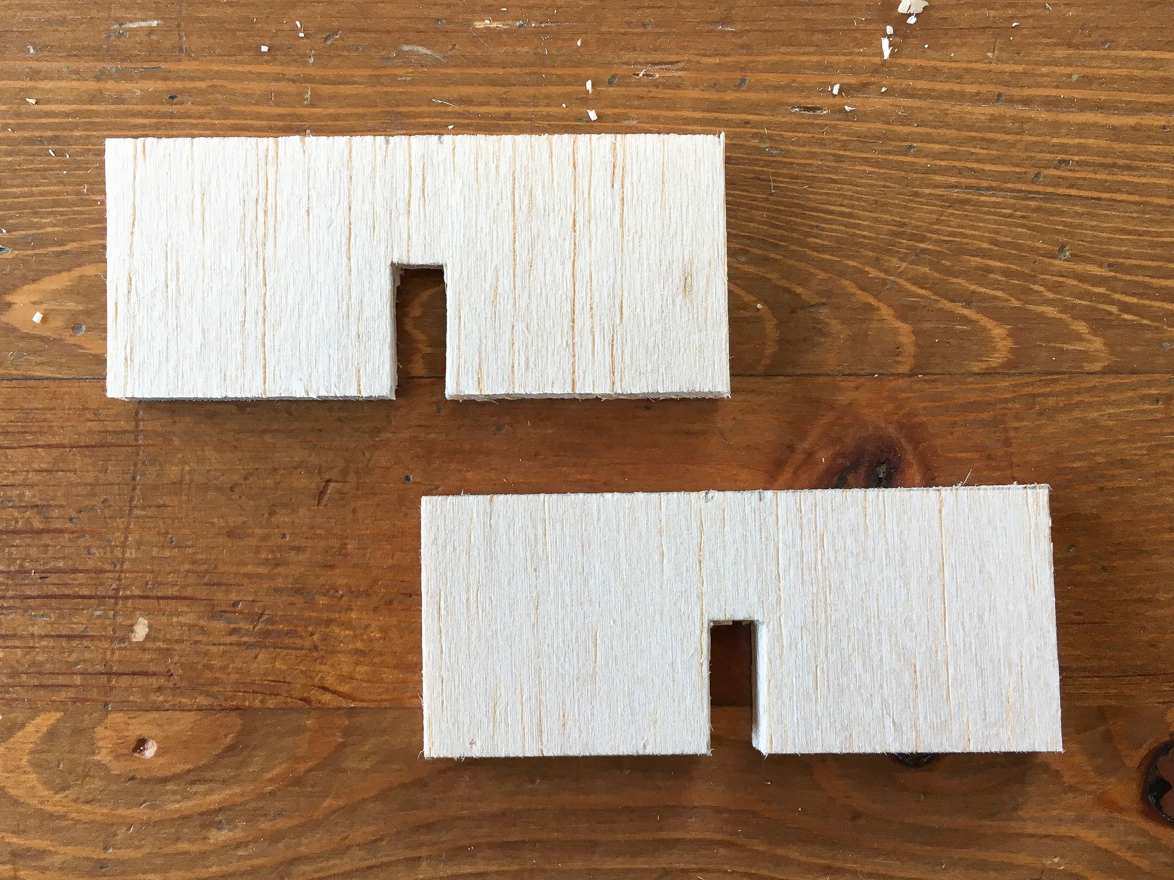

1. Using the remaining balsa wood, mark and cut two, 1 1/4 inch by 3 inch pieces.
2. Next, you will need to make cuts in the wood so they will be able to fit together to make an 'x' shape. This will be the paddle. Find the middle point of the wood and mark 1/8 inch on each side of it (equaling a 1/4 inch mark). Measure in 1 1/8 inches from each point and cut that section of wood out using a utility blade.
3. Fit the pieces together. They should fit snugly. If all cuts were made correctly the paddle will fit perfectly (with a small gap all around the edges) inside the cut section of the boat.

1. Place the rubber band around the pegs. Stretch the rubber band open far enough to get half the the paddle inside it. You're finished!
3. Wind the paddle away from the boat to make it go forward and vice versa. Hold the paddle in place with wound rubber band until it's placed in the water. Let go and watch the boat sail away!

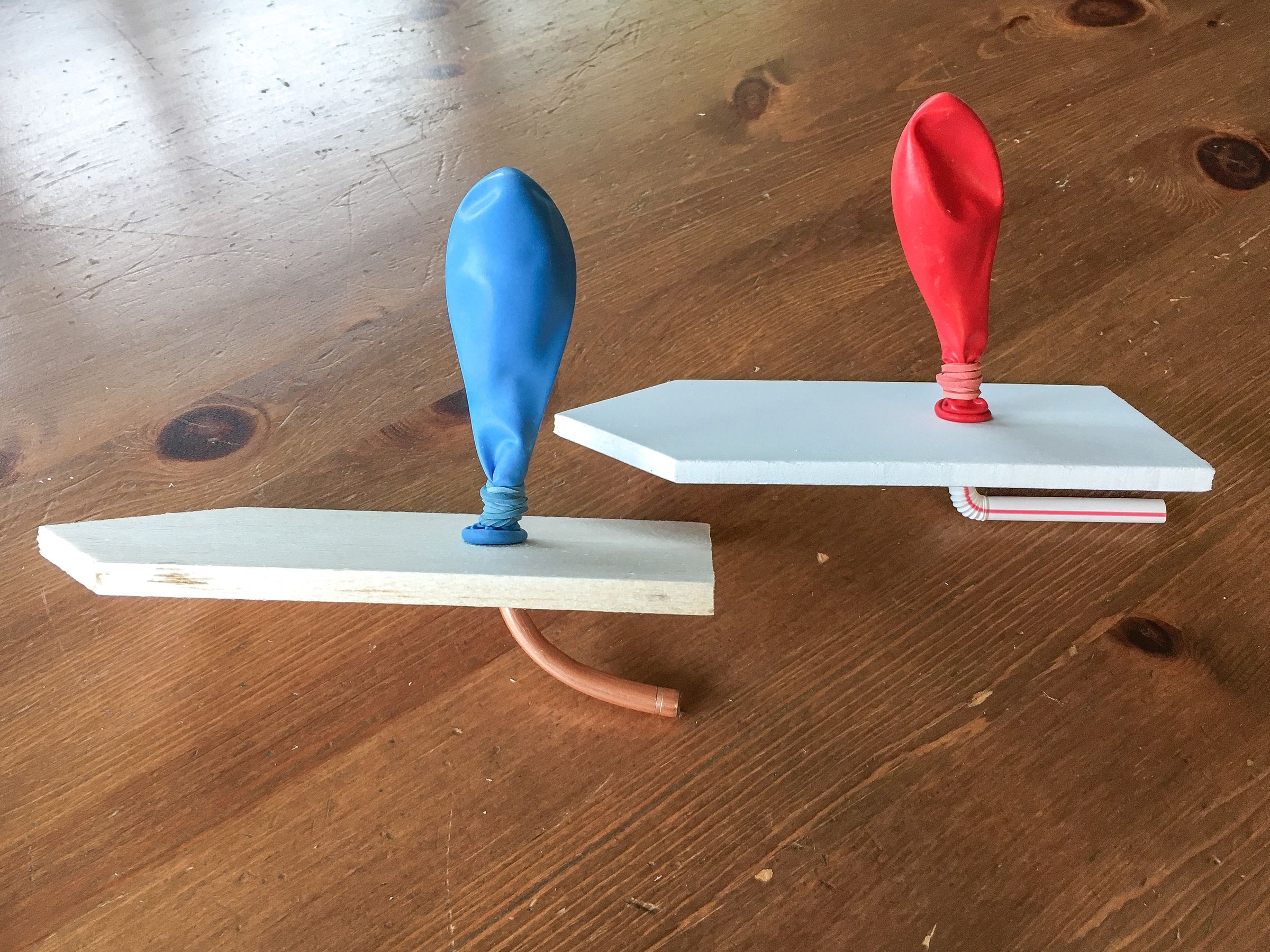

Step 3: How to Make a Balloon Boat
This is by far the simplest and quickest of the three boats highlighted in this series. It also has a dramatic outcome when sailing. When the balloon is inflated and air is released through the small opening of the tube or straw it sets the boat in motion by forcing it along. Kids absolutely love this one!
I will make two boats using different materials. Choose which one is age appropriate for the students being taught, keeping in mind that the second version is appropriate for a younger student. It will also be the cheaper option. Something to think about if you have a strict budget!

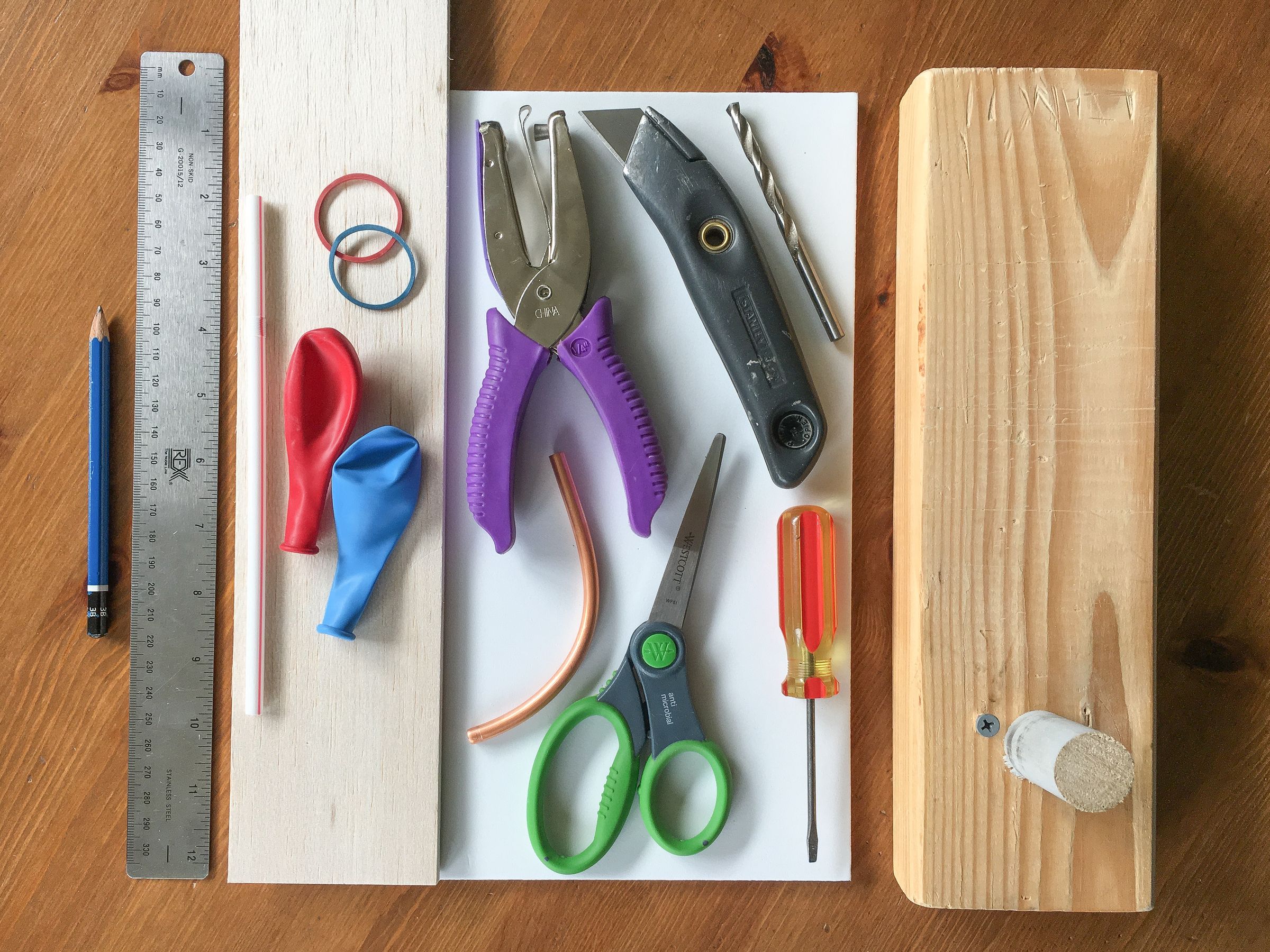

MATERIALS
You will need the following materials to make a balloon powered boat:
For the balsa wood version:
  • 6x3x1 inch Balsa Wood Block
  • 7-inch Balloon
  • Utility Knife
  • Ruler
  • Pencil
  • 1/4-inch Drill Bit or Screw Driver
  • 4-inch Piece Copper Tube (1/4 inch diameter)
  • Small Rubber Band
  • Coiling Mechanism (please refer to Step 1 for a tutorial on how to make this tool)
For the foam version:
  • 1 Sheet Craft Foam - 1/4 inch thick
  • Scissors
  • 7-inch Balloon
  • Utility Knife
  • Ruler
  • Pencil
  • Small Rubber Band
VERSION 1: BALLOON POWERED BALSA WOOD BOAT

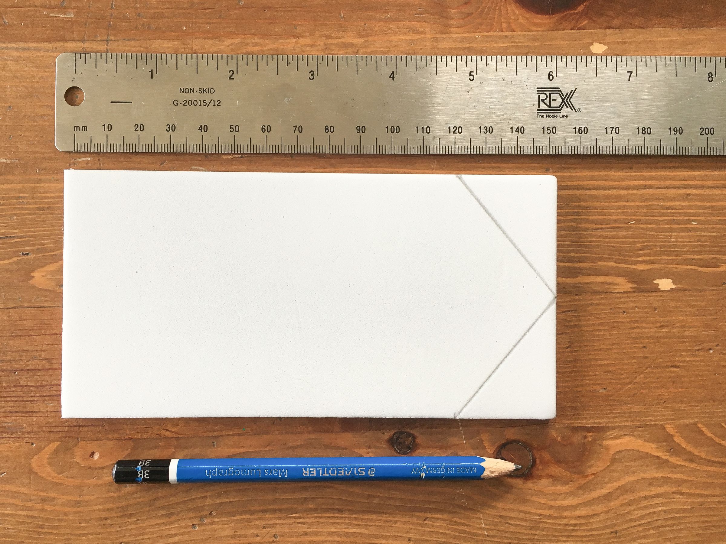

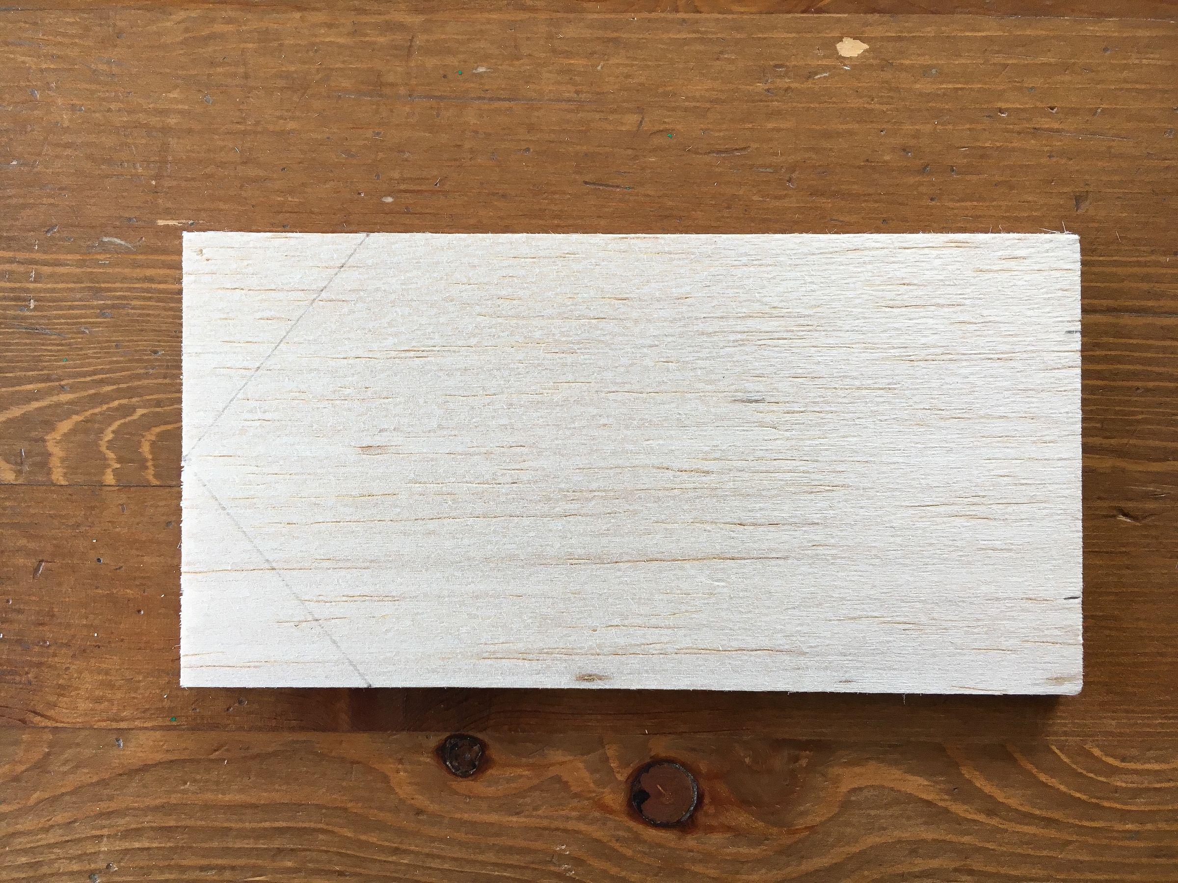

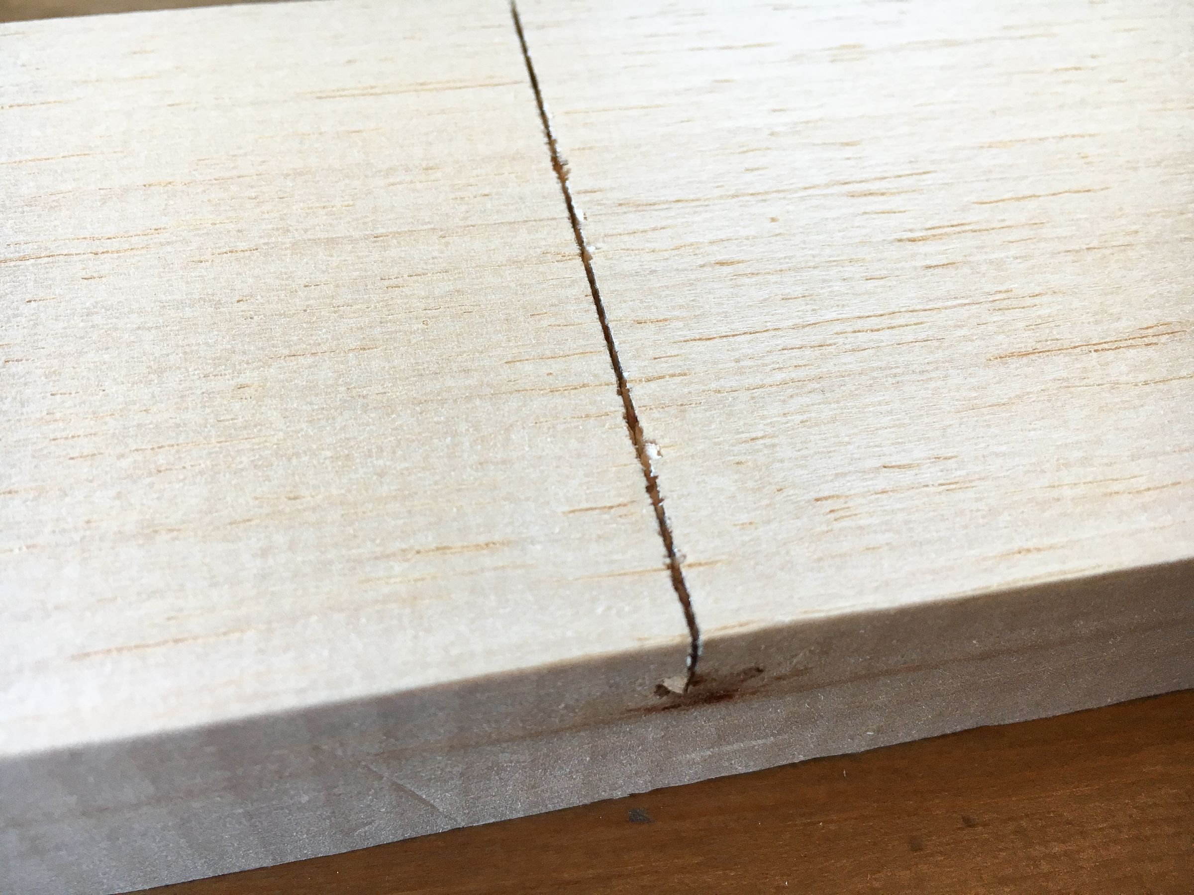

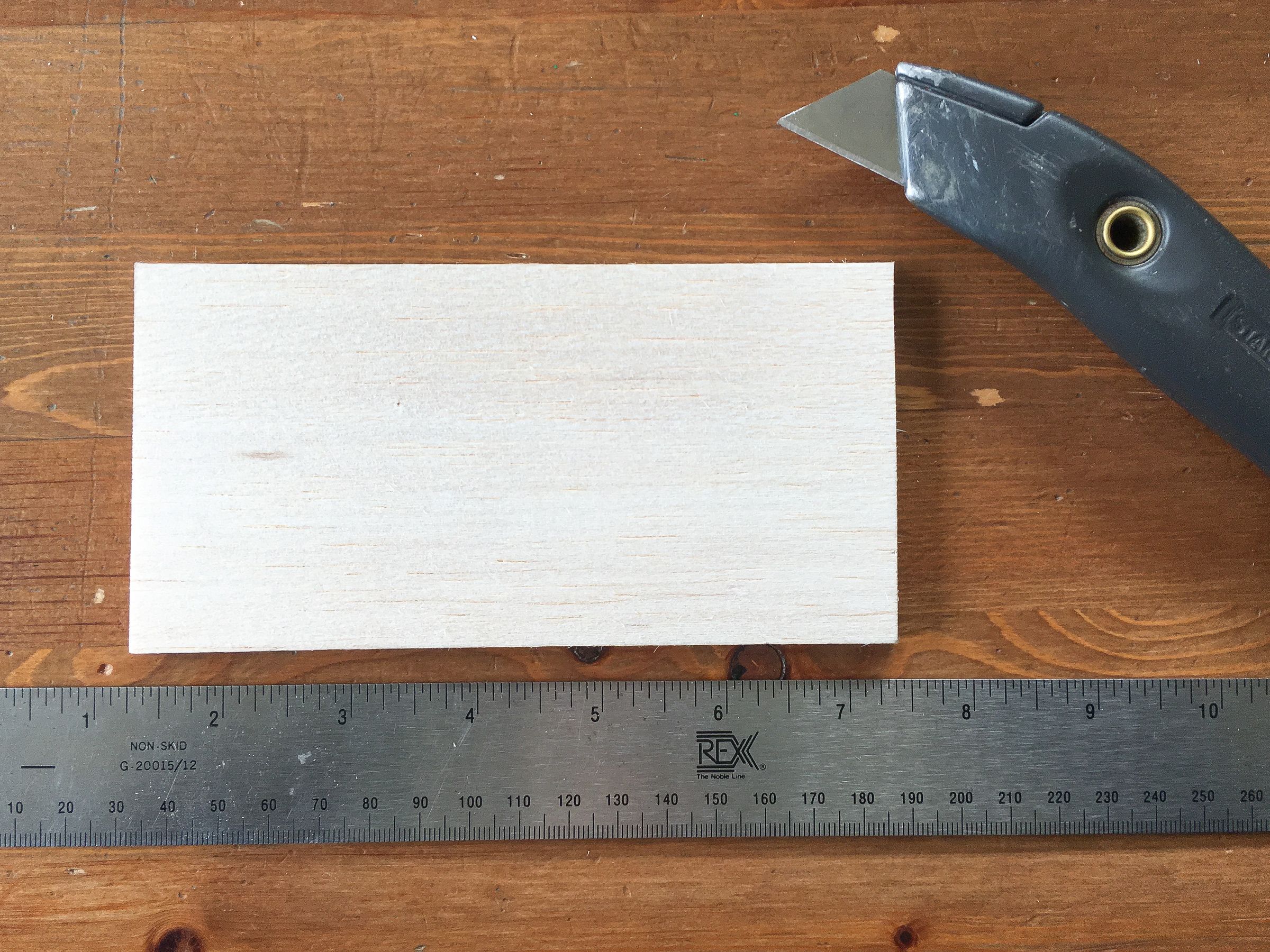

1. If your balsa wood isn't already cut to the correct size, you will need to cut a 6 inch length. Using a pencil and a ruler mark off a section that is 6 inches in length and cut the wood using a utility knife and a ruler. Make shallow passes through the wood. Don't try to cut through the entire thickness in the first pass. Take your time and make several passes to get the cleanest cuts.

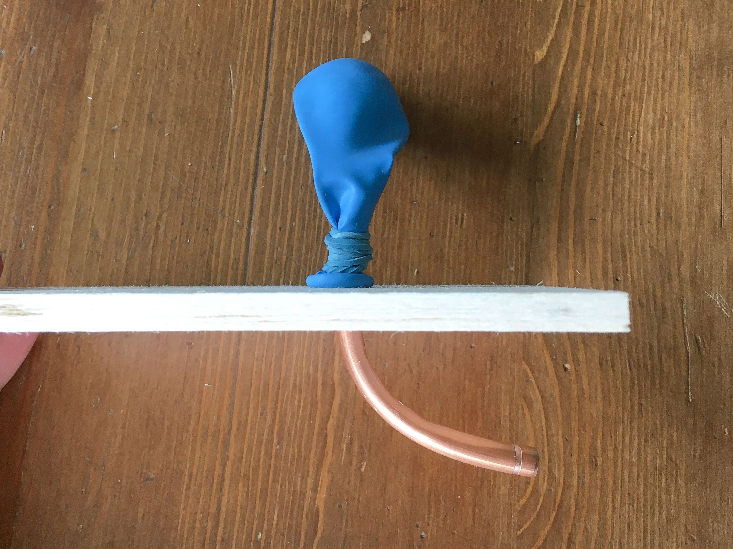

4. Mark a center point on the back end of the boat two-inches in. Using a 1/4 inch drill bit make a hole by twisting the drill bit back and forth repeatedly. If the students are of old enough age to use power tools feel free to let them drill this with a power drill! The balsa wood is soft enough that twisting a drill bit is fast work and doesn't take much effort. Drill bits are sharp so advise your students to use caution as to not cut their fingers! (Easily turn this boat into a STEAM project by painting, designing, or decorating the boat.

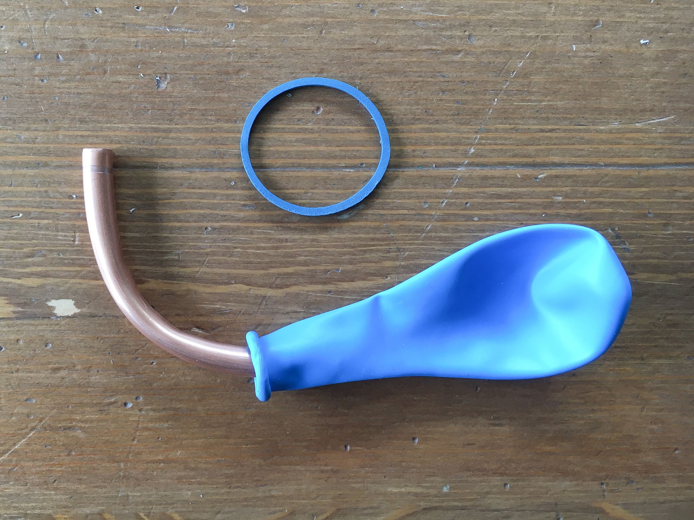

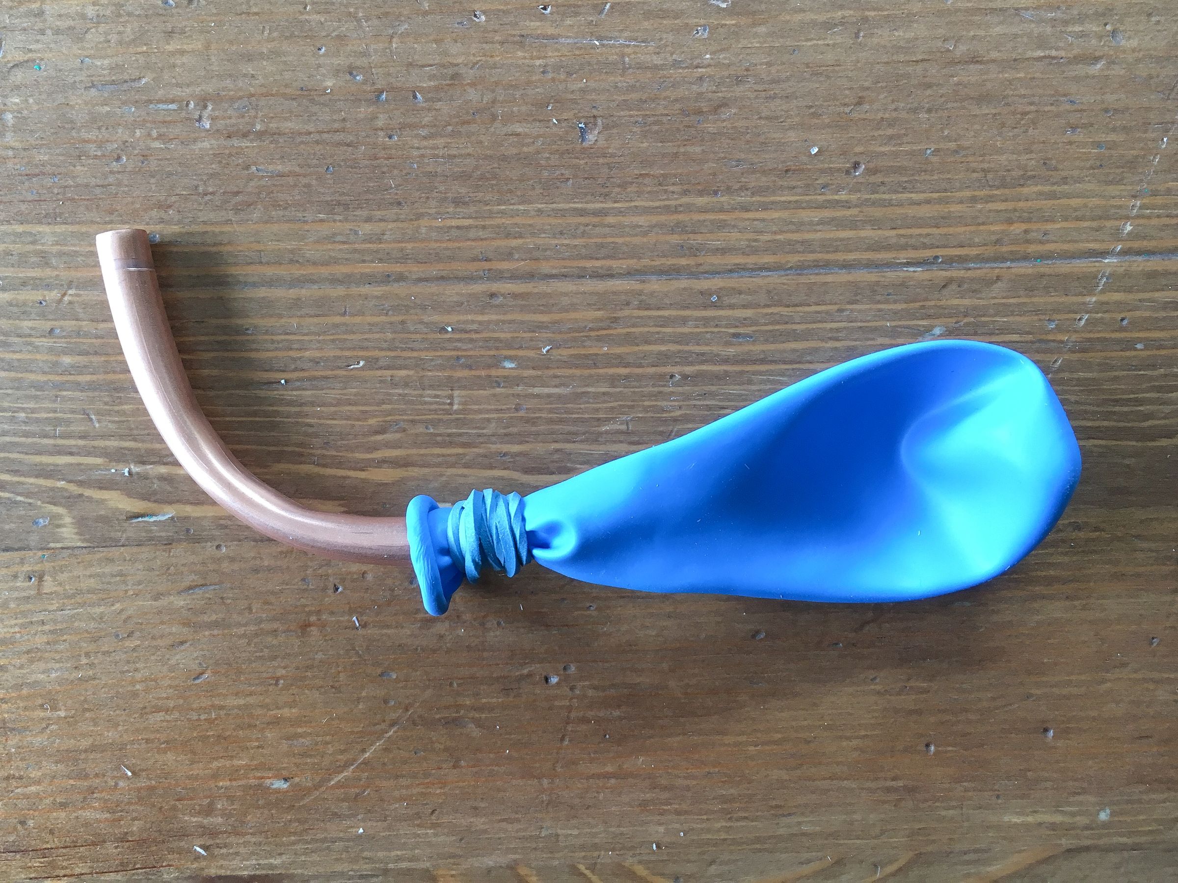

5. Cut a piece of 1/4 inch diameter copper tube to a 4-inch length using a tube cutter. Using the coiling tool, gently bend the copper tube. If you read through the putt putt boat tutorial you will remember we filled the tube with sugar before bending. With a piece this small it's possible to slowly bend the copper tube without it collapsing. Just take your time.
6. Place a 7-inch balloon over one end of the copper tube and secure it with a rubber band. You will want to make sure the rubber band is tight enough that no air can escape between the balloon and the copper tube.
7. Insert the copper tube into the hole of the boat.
8. Blow air into the balloon from the open end of the copper tube. Once the balloon is inflated hold your finger over the end to trap the air. Place the boat in water and remove your finger. Watch the boat sail away!

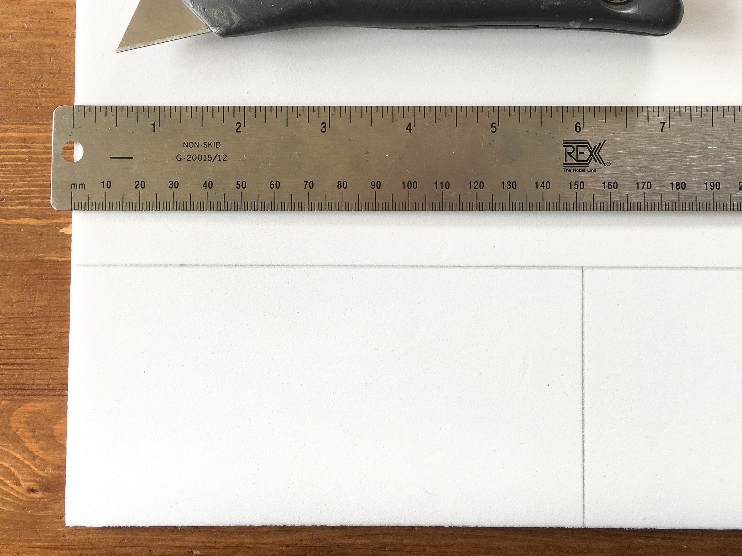

VERSION 2: BALLOON POWERED FOAM BOAT
This is a much less expensive version using simple materials and tools. This is an appropriate STEM project for young students ages 5-7.

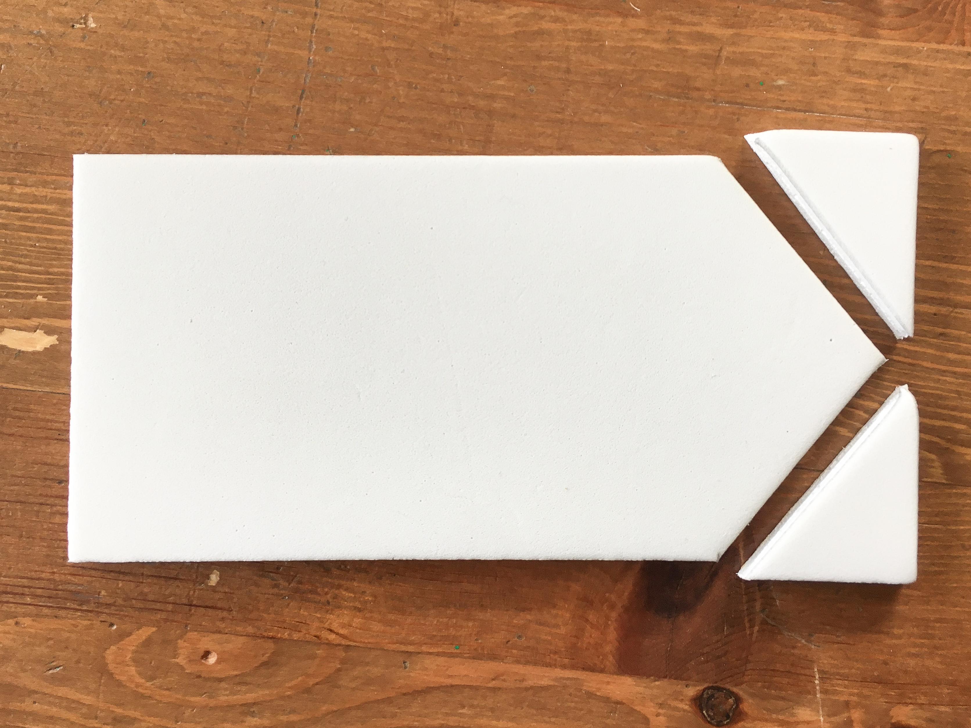

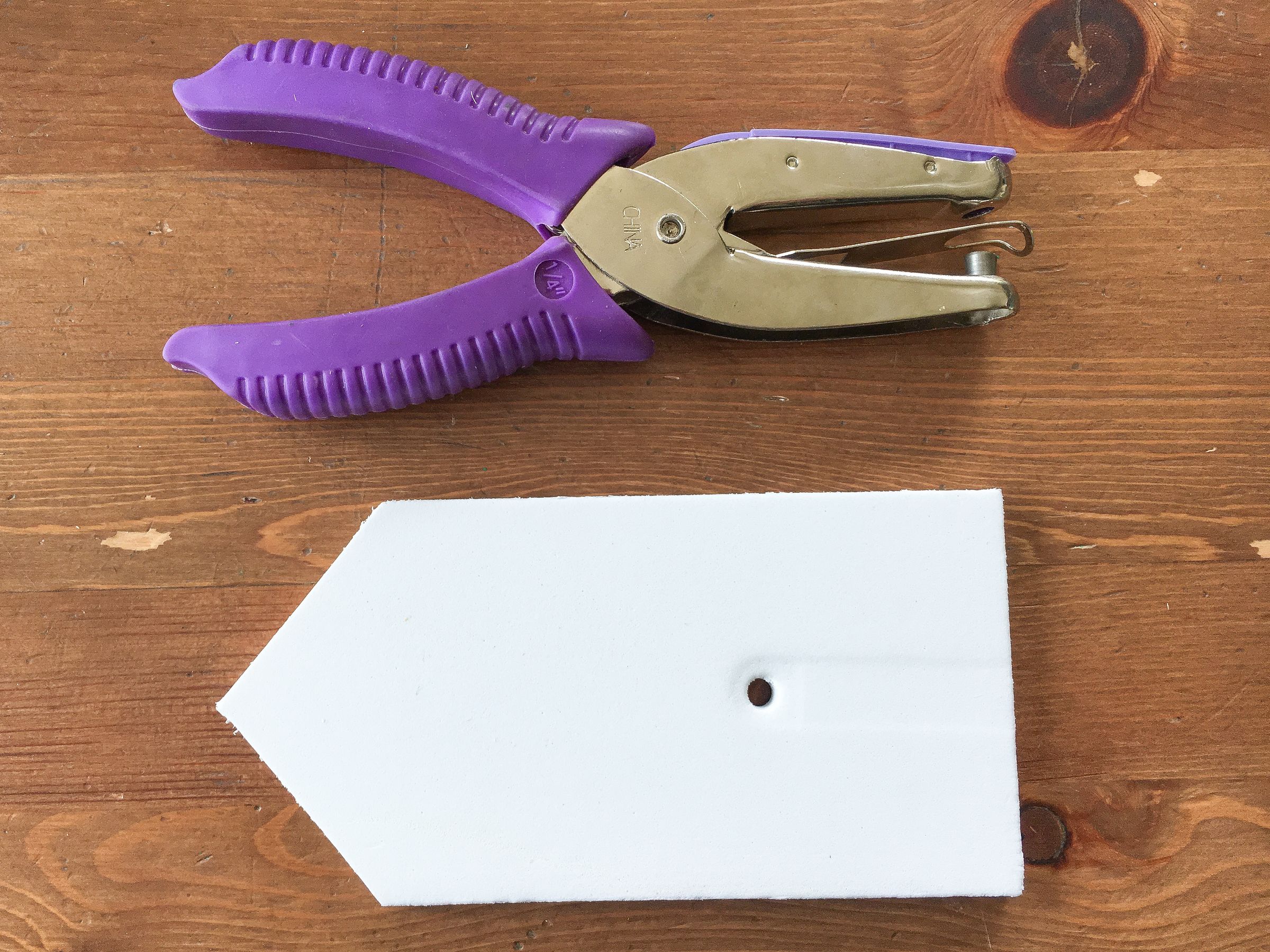

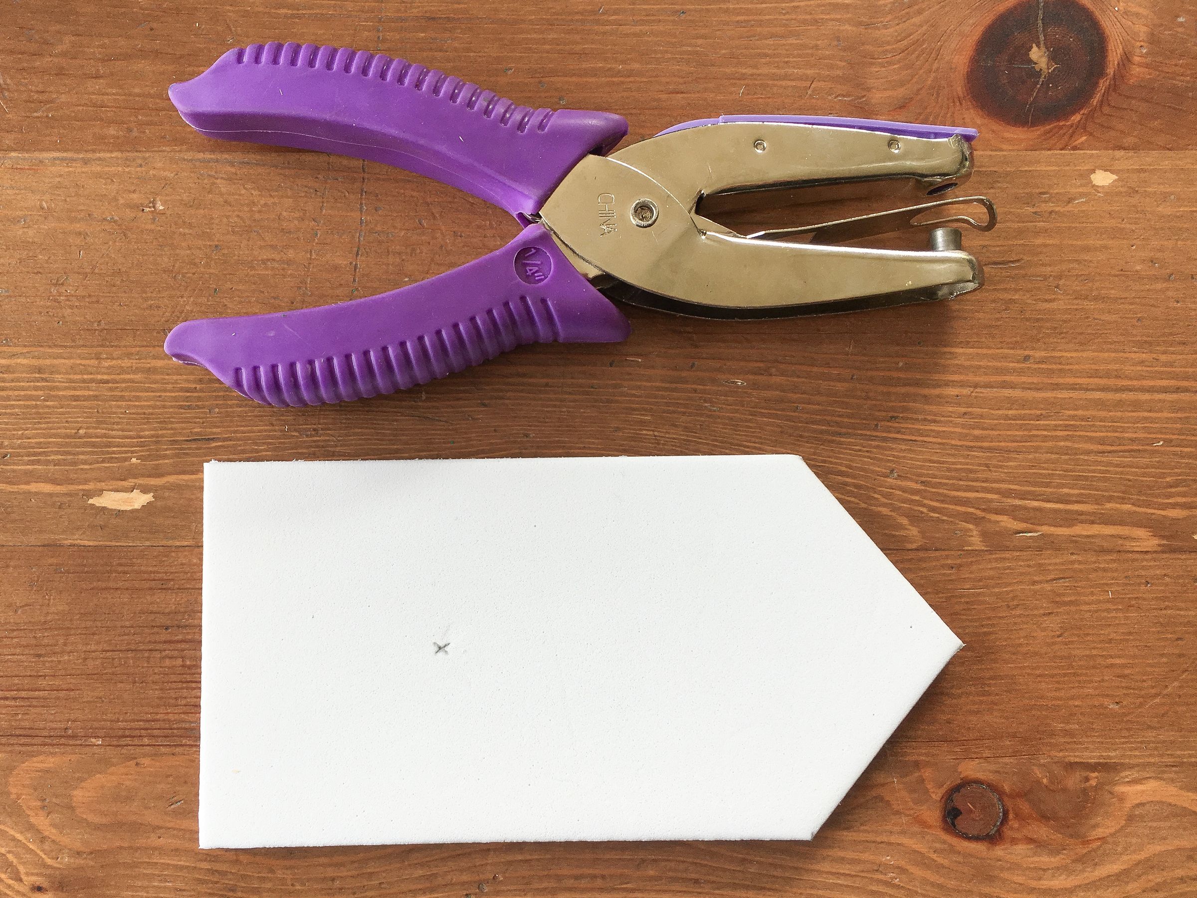

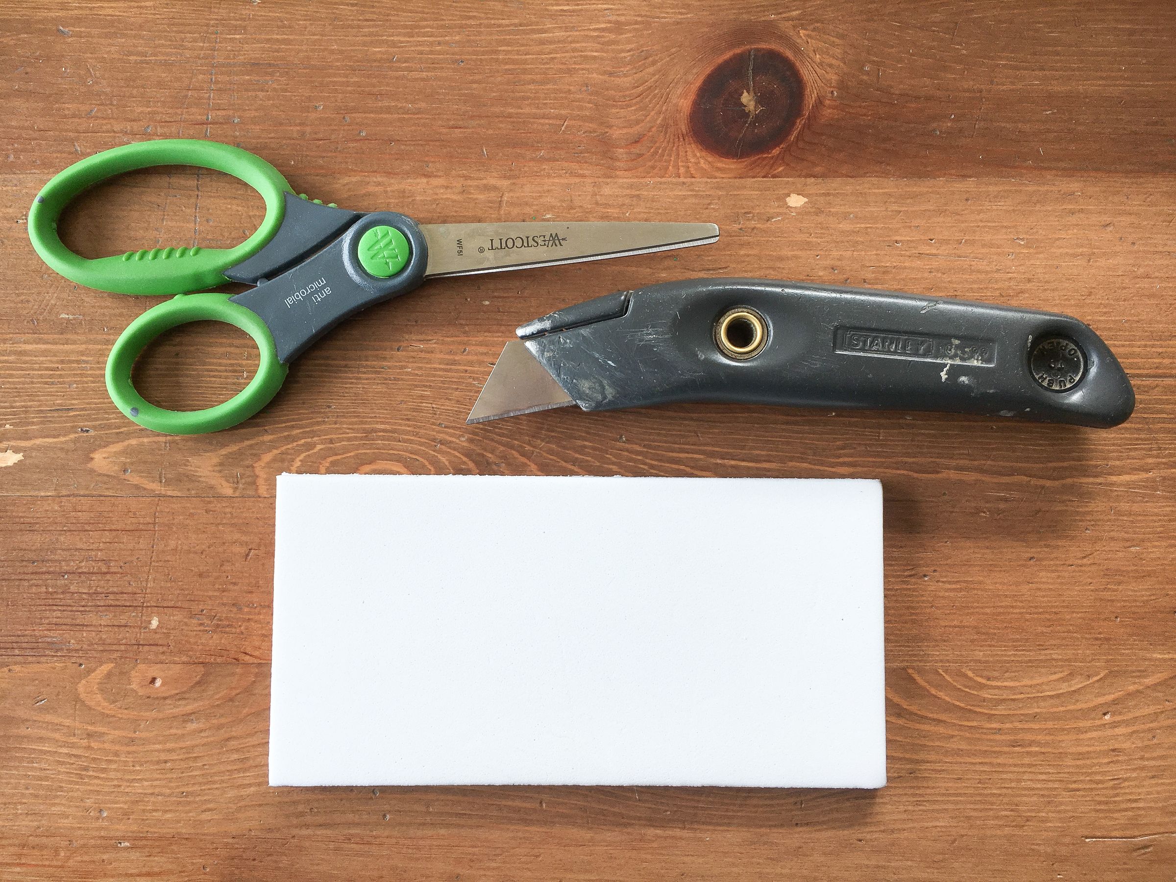

1. If your foam isn't already cut to the correct size, you will need to cut a 6 x 3 inch rectangle. Using a pencil and a ruler mark off a section that is 6 x 3 inches and cut the foam using scissors. A utility blade could also be used with older children.
3. Using scissors cut on the lines.

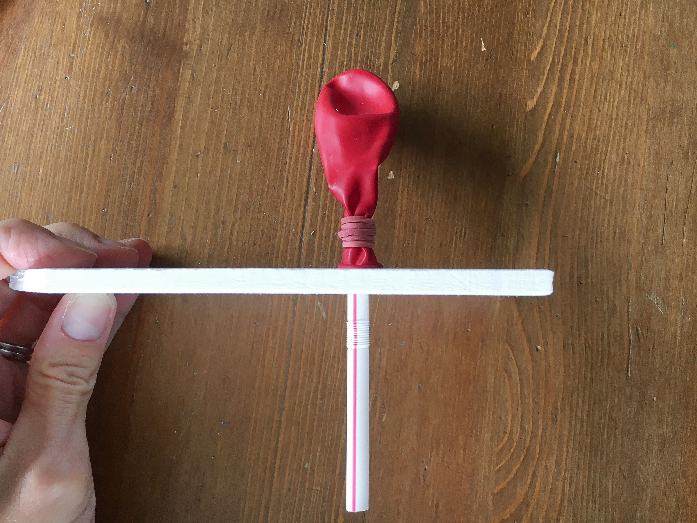

4. Mark a center point on the back end of the boat two-inches in. Using a standard paper punch, punch a hole through the foam. (Easily turn this boat into a STEAM project by designing, or decorating the boat in an artistic manner. Colored foam pieces would be a great option.)

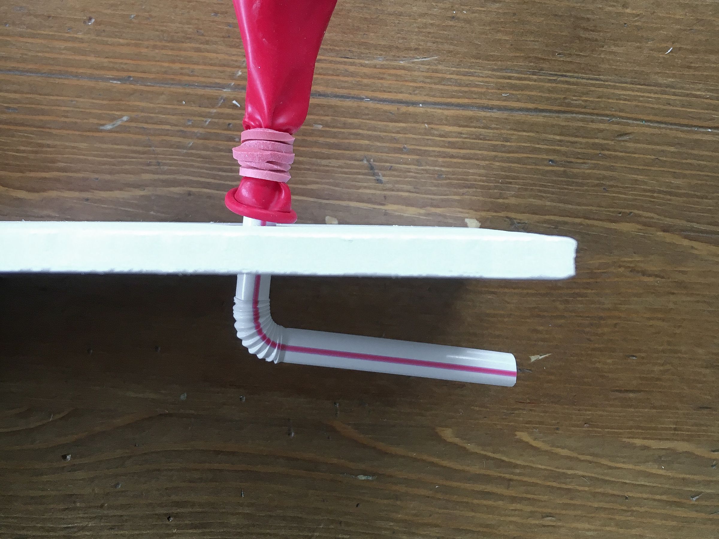

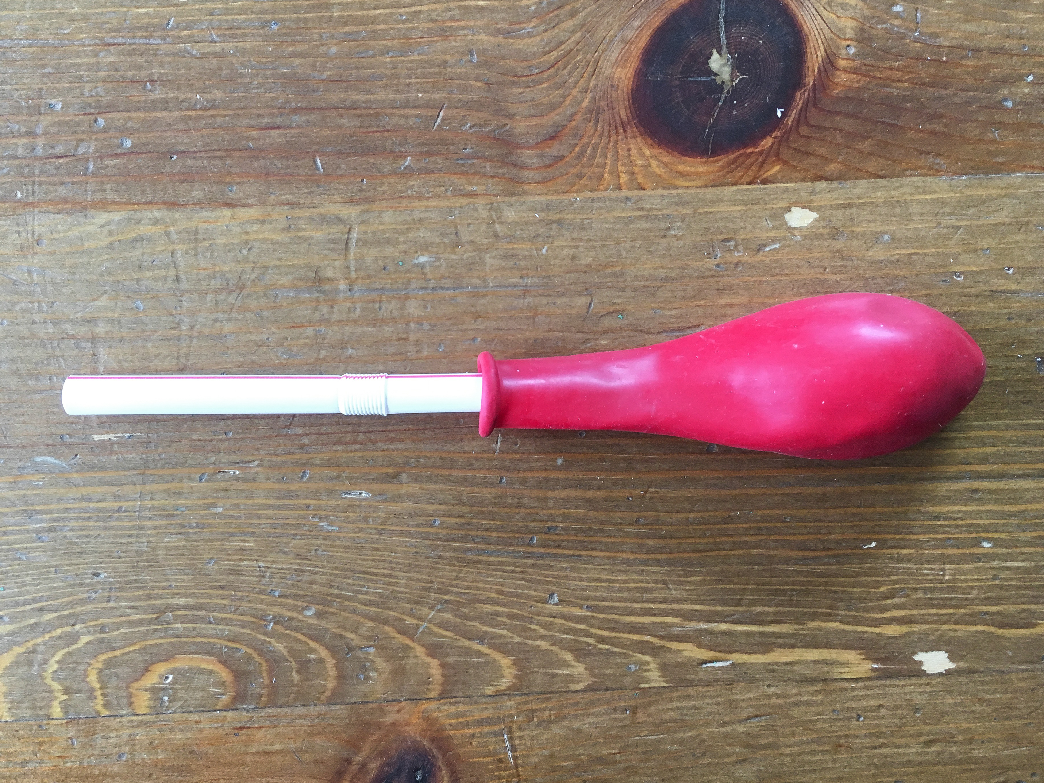

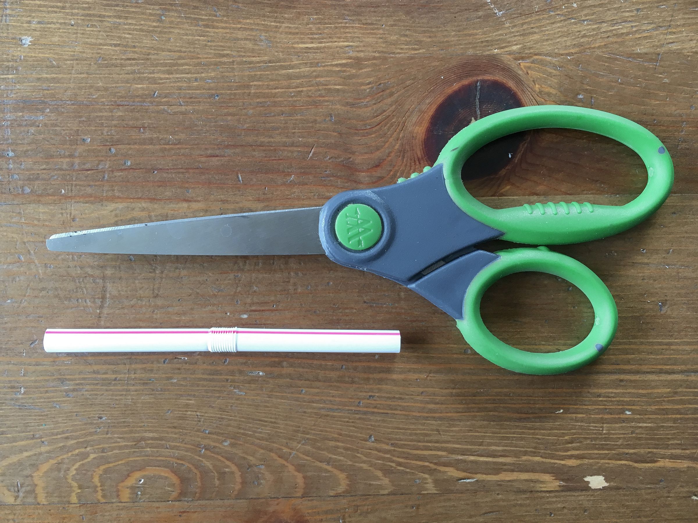

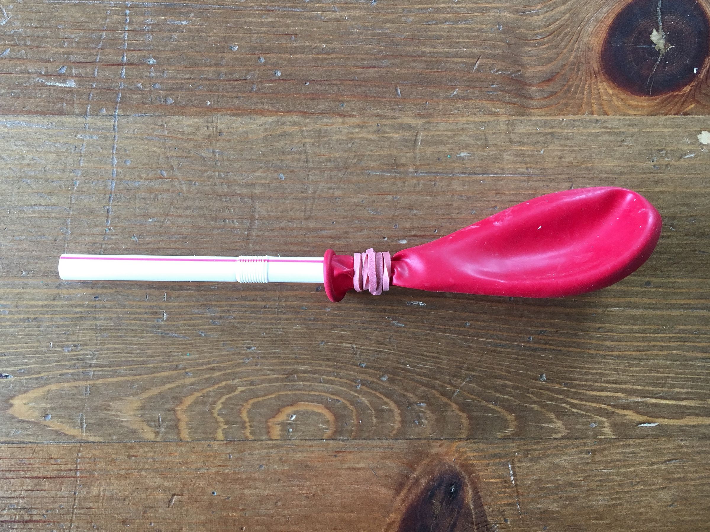

5. Using scissors, cut a length of bendy straw that is about 4 inches making sure the bendy part is in the center.
6. Place a 7-inch balloon over one end of the straw and secure it with a rubber band. You will want to make sure the rubber band is tight enough that no air can escape between the balloon and the straw.
7. Insert the straw into the hole of the boat and bend the underneath part parallel to the boat.
8. Blow air into the balloon from the open end of the straw. Once the balloon is inflated hold your finger over the end to trap the air. Place the boat in water and remove your finger. Watch the boat sail away!
