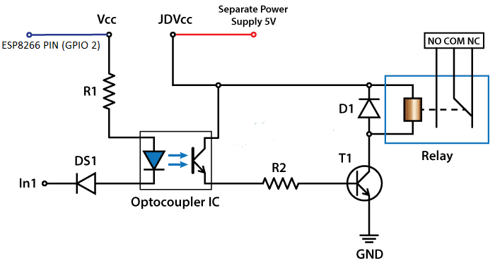

We will solder the ESP8266 module and the 5V relay in the perfboard in this stage. The following figure shows the connection between the relay and esp module. Without the esp module and the relay, the diagram includes a few auxiliary components. So, before start soldering let me give a brief introduction for each component for your better understanding.

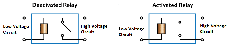

Relay: A relay is an electrically operated switch that can be turned on or off, letting the current go through or not, and can be controlled with low voltages, like the 5V provided by the Arduino or other microcontroller pins. A Relay is actually a switch which is electrically operated by an electromagnet. The electromagnet is activated with a low voltage, for example 5 volts from a microcontroller and it pulls a contact to make or break a high voltage circuit.
Optocoupler: An Optocoupler, is an electronic component that interconnects two separate electrical circuits by means of a light-sensitive optical interface. The basic design of an optocoupler, also known as an Opto-isolator, consists of an LED that produces infra-red light and a semiconductor photo-sensitive device that is used to detect the emitted infra-red beam. Both the LED and photo-sensitive device are enclosed in a light-tight body or package with metal legs for the electrical connections as shown.
In microcontroller application relays usually are driven using optocouplers, which offer isolation between the analog and digital grounds to ensure that switching currents in the relay coils do not affect the noise margin of the digital circuit. For driving a large number of relays through a bus-based backplane, the onboard complex programmable logic device (CPLD)/FPGA provides the interfacing and diagnostics to the I/O board.
Flyback Diode: A Flyback diode is also called a freewheeling diode. It is also called by many other names like snubber diode, suppressor diode, catch diode or clamp diode, commutating diode. For an inductive load like a motor, relay, etc. a flyback diode is used to helps the circuit from damage. Since an inductor (the relay coil) cannot change it's current instantly, the flyback diode provides a path for the current when the coil is switched off. Otherwise, a voltage spike will occur causing arcing on switch contacts or possibly destroying switching transistors.
I hope you understood the circuit. Now place the components on the PCB board one by one and solder. I prefer to use the pin header for esp module without directly soldering it to the board. It will prevent from burning during soldering. You can also unplug and update the program easily. Use an led for the component DS1. The output of the optocoupler cannot directly drive the relay coil. For this reason, I used an npn transistor to the optocoupler output.

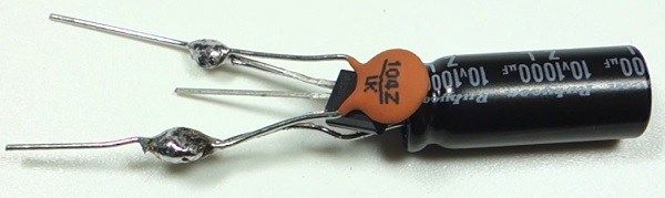

A large capacitor (suggest using 470 uF) across the Vcc to Gnd rails on your breadboard or PCB is a vital ingredient that will minimize reset inducing voltage fluctuations. A 0.1 uF decoupling capacitor across the ESP8266 Vcc to Gnd inputs very close to the pins (within 1/2 inch). DO NOT SKIP THIS COMPONENT! This cheap yet often overlooked component, when missing, is the root cause of ESP8266 resets.
