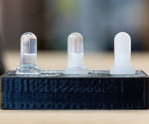

If we jump over to an SLA printer such as the Form 1 +, these printers automatically fill all geometry with resin. Many people “hollow out” their models before printing to save time and material cost, but since we’re looking to increase structural integrity, filling the entire geometry with resin is a great option.
If you do decide to hollow out your model, 3mm minimum wall thickness in VeroWhite is a good place to start.
