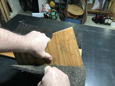

Step 2: Retrieve Raw Materials
Strip off the felt. Knock the glued bits apart.

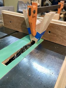

Step 8: The Dados
Set the dado cutter to ⅝”, then do a test fit. Mine was a little loose so I adjusted the stack with some shims until I got a nice snug fit. I taped the parts together and clamped them to the sled for safety. Then I made several passes to reach the final depth.
